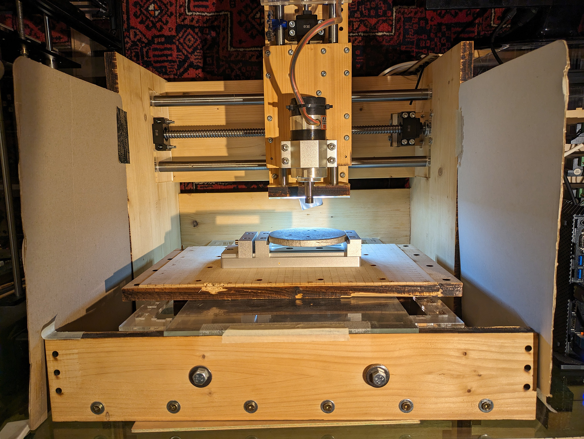

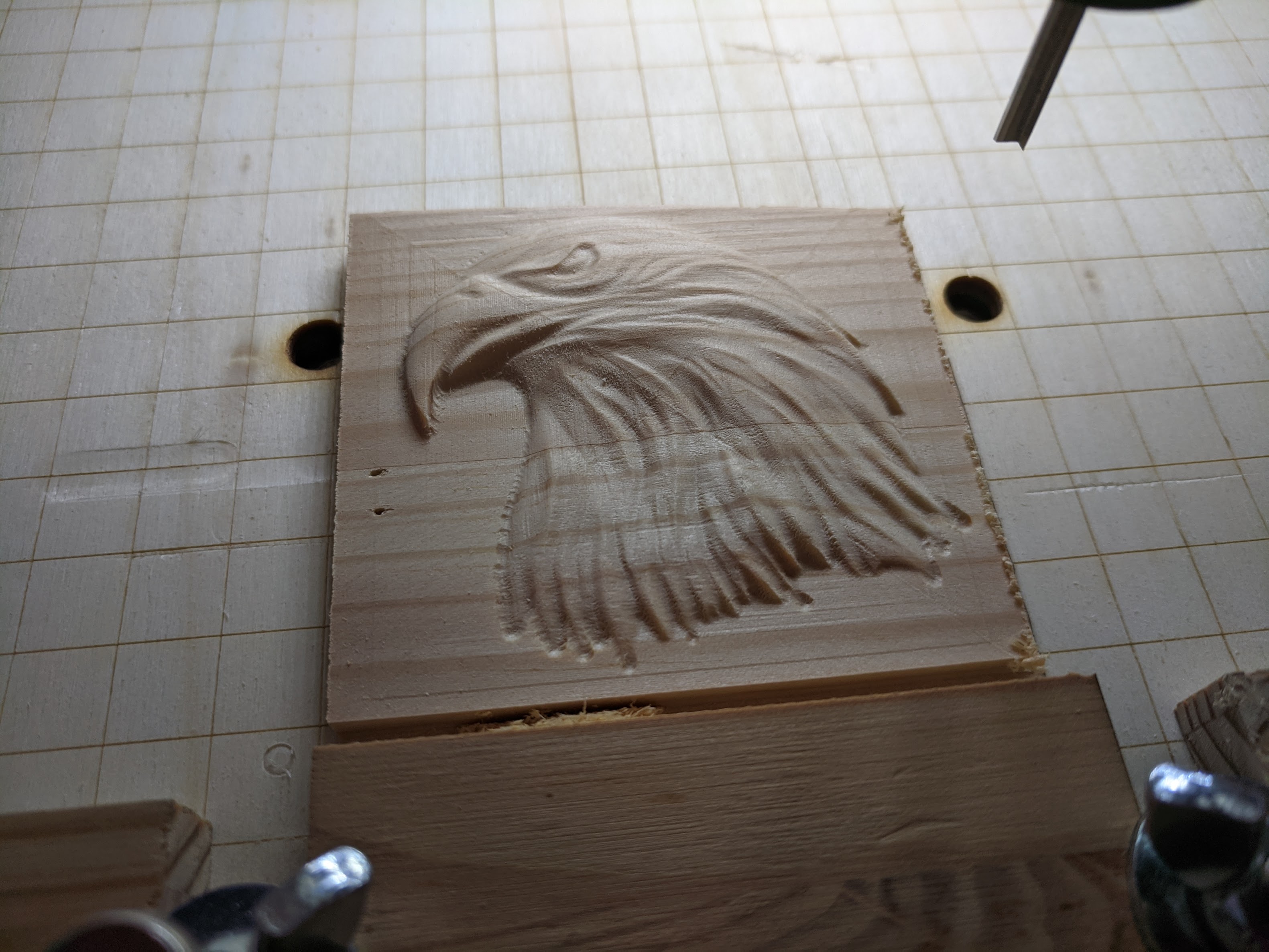

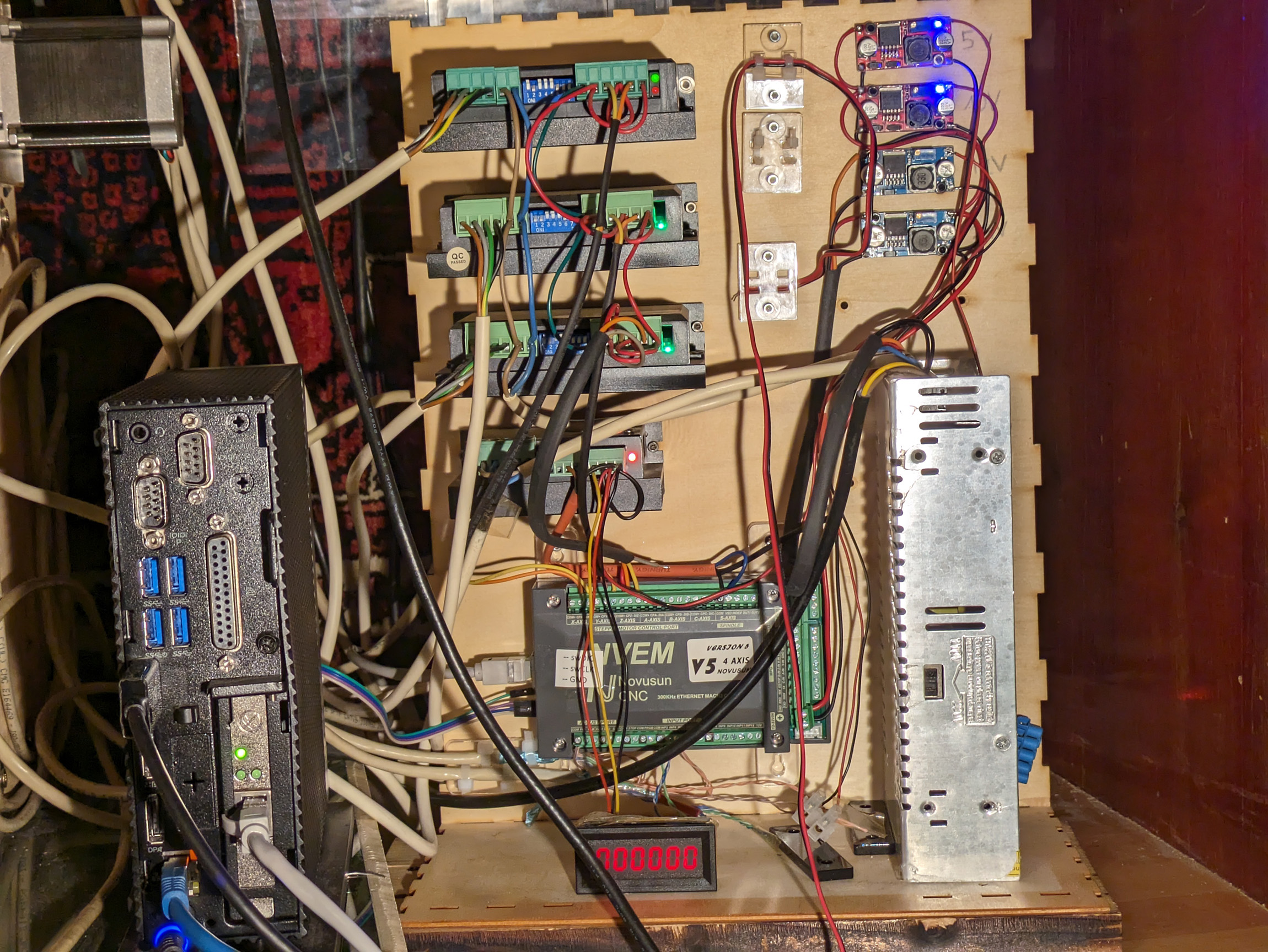

07 Sep 2023 21:15 - 07 Sep 2023 23:46 #280232
by cnc-phil
Replied by cnc-phil on topic Remora - ethernet NVEM / EC300 / EC500 cnc board
Yes, this is not to be desired.... But I am still proud of it. Cuts wood like a champ, alu not so much. LOL
Edit: metal workpiece is just a mockup.
Edit2: Eagle was made before with parallel break out board
Edit3: The lasercut acrylic pieces on the end of every axis make it very easy to get everything precise, parallel and smooth, without any measuring device...

- GeramyL
- Posts: 74
- Thank you received: 6
07 Sep 2023 21:30 #280233
by GeramyL
Replied by GeramyL on topic Remora - ethernet NVEM / EC300 / EC500 cnc board
Well thats pretty freaking cool, if you replace those cylinder guides with MGN15 rails you will be able to do aluminum without a problem, could you share your hal and ini file? Maybe i've got something mucked up in my configurations, perhaps its the FERROR, it seems the FERROR is some sort of value that needs to be calculated based on step accuracy, not sure exactly because its hard to find an explanation. I've set my microsteps to 12800 to give me the best smoothness between sudden movements. I have 2DM542-06 Drivers which offer motor tuning and all cool sorts of tricks.
