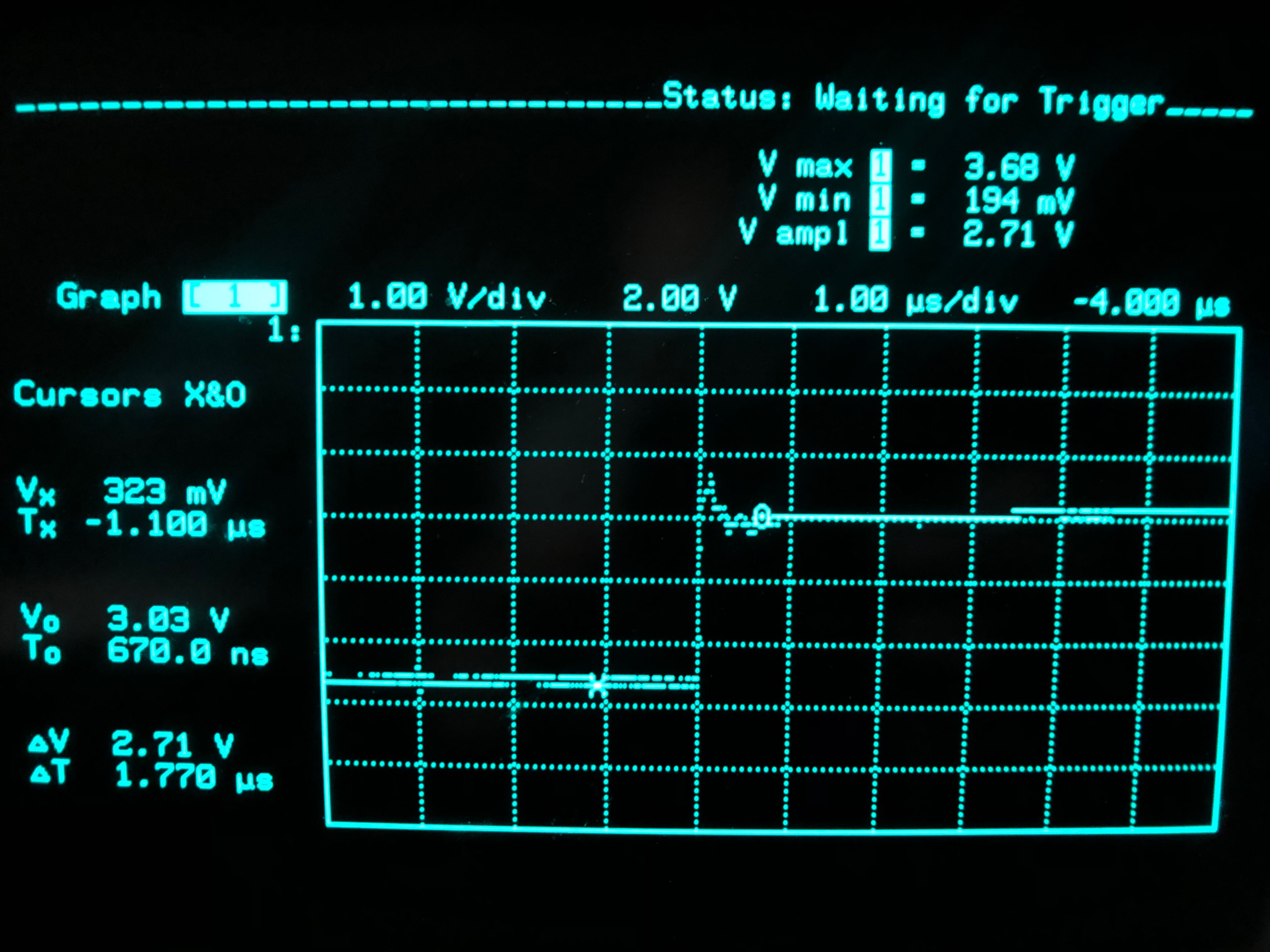

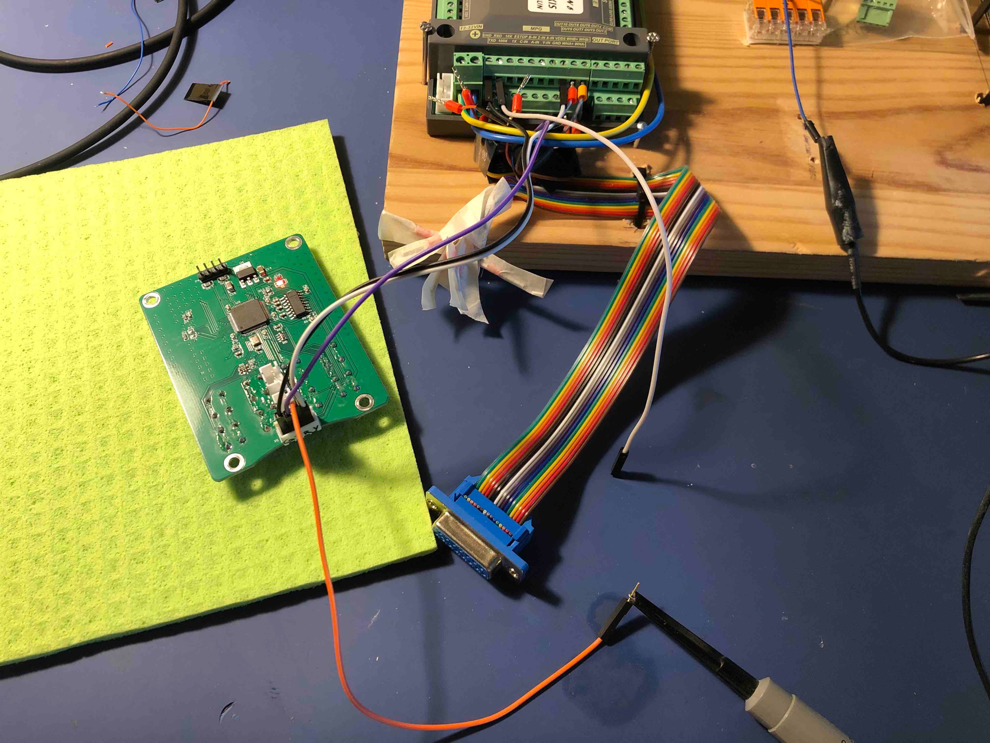

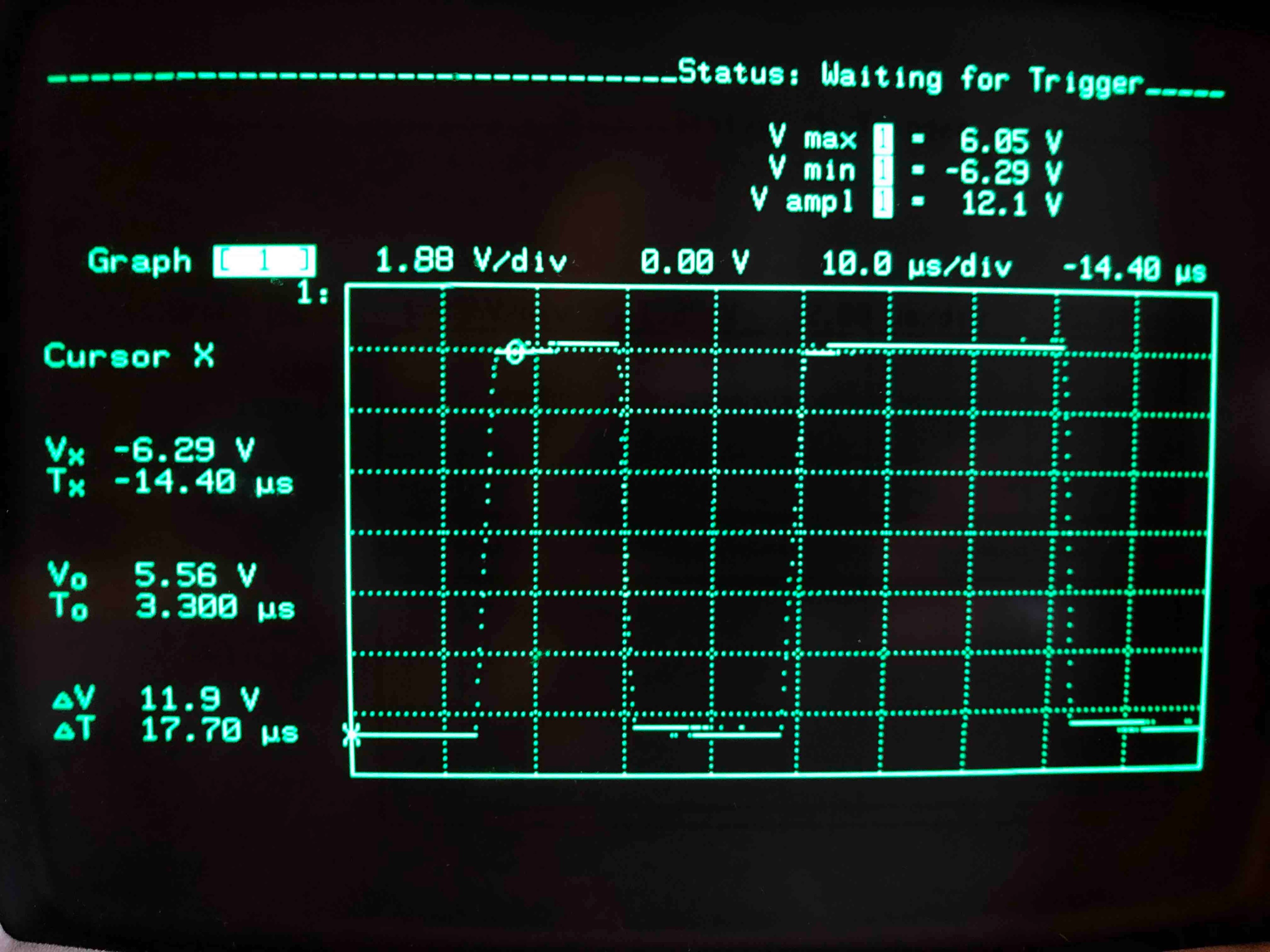

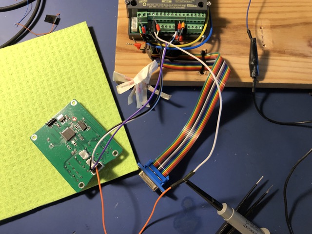

About the lack of transmission from my NVMPG:
I tried disassembling the MPG and taking some measurements.
To begin with: TX from Remora on NVME v5 to MPG is working fine, display is updated accordingly to LinuxCNC status. Only RX part, transmission from MPG to NVME is not there.
1. I tried plugging my scope directly to RX port on NVMPG internal board while without it being connected to NVME (TX, Vdd and GND are still attached to NVME and the display is updating) - see the `rx_floating.jpeg` image. I was getting correct (I guess) RS232 -5V/ 5V, similar to what was received on TX port (`rx_osci.jpeg`).
2. Second test was to try connecting RX port to NVME with probe in line. Unfortunately, I was not able to observer any signal at all. See the connection:
Any ideas why it might be the case? It at least looks like pull-down resistor between RX and GND in my NVME is bad/short-circuited (if it is even present in this design?).
- Resistance between MPG's GND and RX on NVME is around 25 ohm (with board disconnected from power)
- For comparison, between COM and INP3 (that works as expected) I'm seeing around 45kOhm.
