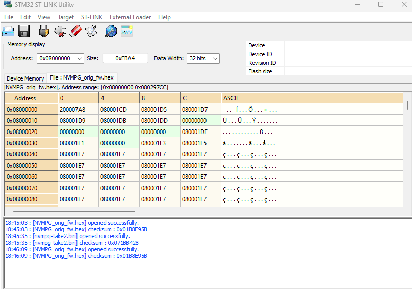

I connected stlink to my nvmpg to get a dump of the running firmware, it would be interesting to get a copy from someone that has a working to see if there's major difference? Scott, would you be able to take my .bin from my nvmpg and see if it differed from yours? I dont have the skills to reverse engineer things like you did up front but happy to poke about and learn more!

Hi, thanks but something is not right with the file. It's only 99KB where the hex file I dumped from the MPG with ST-Link Utility is 400KB. On inspection, the file does not look like a valid bin file either.

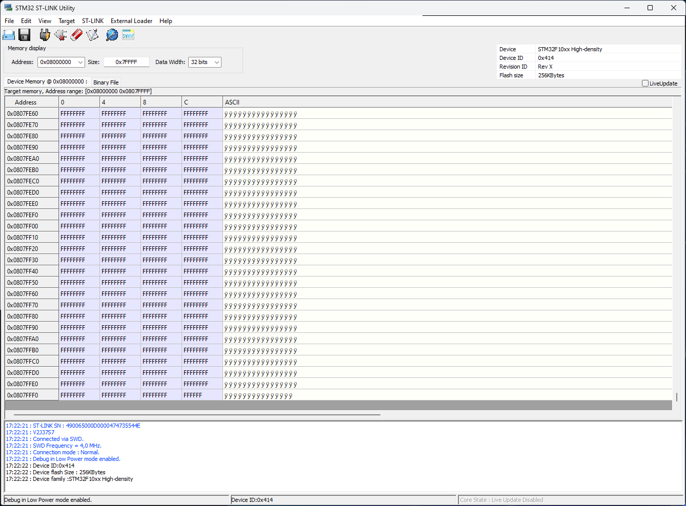

Let me try once more; quite new to this--This time around: I used st-link utility, from there i plugged address
The first time around I had the size set to something smaller as it appeared to be null data after some point? this time i changed the size to 0x07FFFF
New version shows 511KB when unzipped (had to zip to upload here)

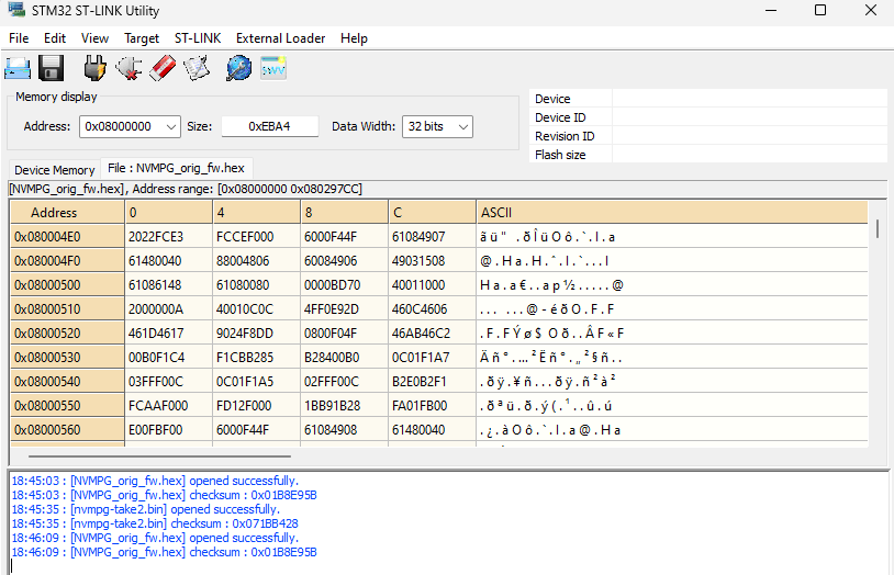

02 May 2024 08:49 - 02 May 2024 08:51 #299536 by scotta
Hi, the file is a better size but still does not look correct. Please save as a hex file starting from 0x08000000. Below is a snip of a valid NVMPG hex file.

I noticed your image your length is different than mine. After 0x000188B0 in my readout all the data displays as FFFFFFFF. so I set the data size as 0x188C0, which creates a ~236KB hex file. Attaching here and photos of what I  see.
refresh with new size:
