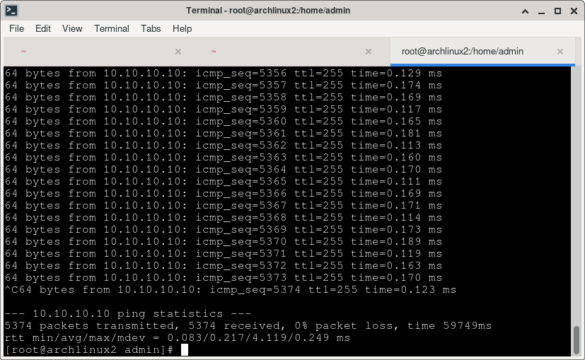

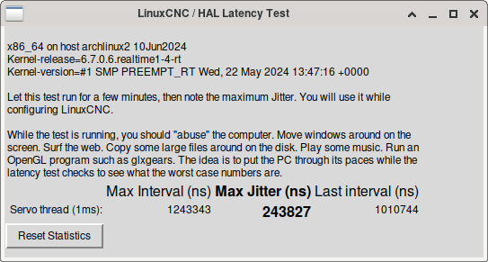

Hi, it's very unlikely that following errors are being caused by jitter. The control loop should compensate for that. Why do you have your [TRAJ] MAX_LINEAR_VELOCITY so much lower than you [JOINT_n] MAX_VELOCITY?Hi Everyone,
recently I was trying to get started with EC500. I was able to flash the firmware and was able to ping the board on the 10.10.10.10 address. It worked nicely with a pico probe and pyocd.
However, I continuously get joint following errors on all my joints while jogging and while executing gcodes. I cannot get rid of them.
Also, the following error is very high, even at low speeds it is more than 1mm. I also tried to increase the P gain or to increase the spike filter in remora-eth.c component without success.
My computer has the following latency values:
If I ping the board over a longer period of time, I get following values:
There are some outliers with high ping, but they are rare.
I already tried to reduce the jitter:
- Isolated two cores
- Moved kernel threads to the non isolated core
- Moved NIC interrupt to the isolated core
I can think there can be two source of problems now:
1. Latency jitter of the NIC
2. Latency jitter of the PC (Fujitsu Esprimo P556)
Can you give me some advice please how to debug this problem? How could I trace down which one is the issue?
Thank you for your help.

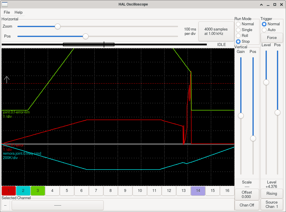

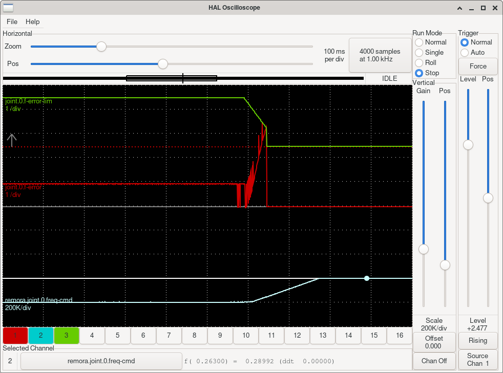

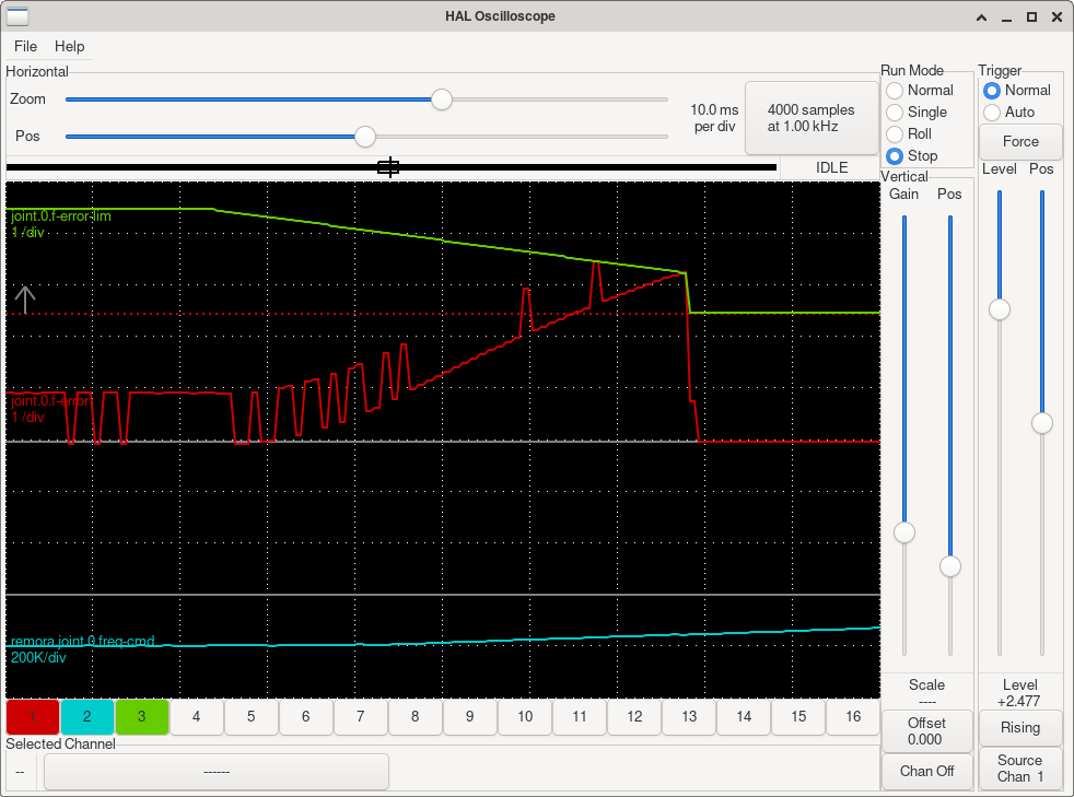

Hi Scott,
thank you for the hint. I'm loading the right version, just renamed it to keep overview.
I increased the values as my new attached INI configuration. I increased the [TRAJ]MAX_LINEAR_VELOCITY to a large value.
The P gain that worked best is 1000 (similar to a mesa configuration). I set the FF1 gain to 0.95, which gives reasonable results.
Now, the error comes not immediately, but for after 3-4 seconds, most often at the end of a jog move.
In this example, I'm jogging alternatively in positive and in negative directions. The following error has some very large sudden spikes.I made the spike filter parametric and experimented with different values, but they do not make any difference (n=2,4,8, m=500).
