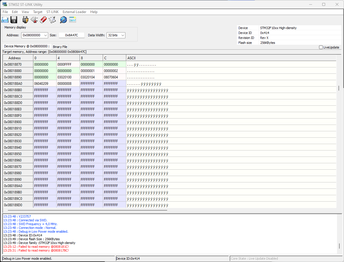

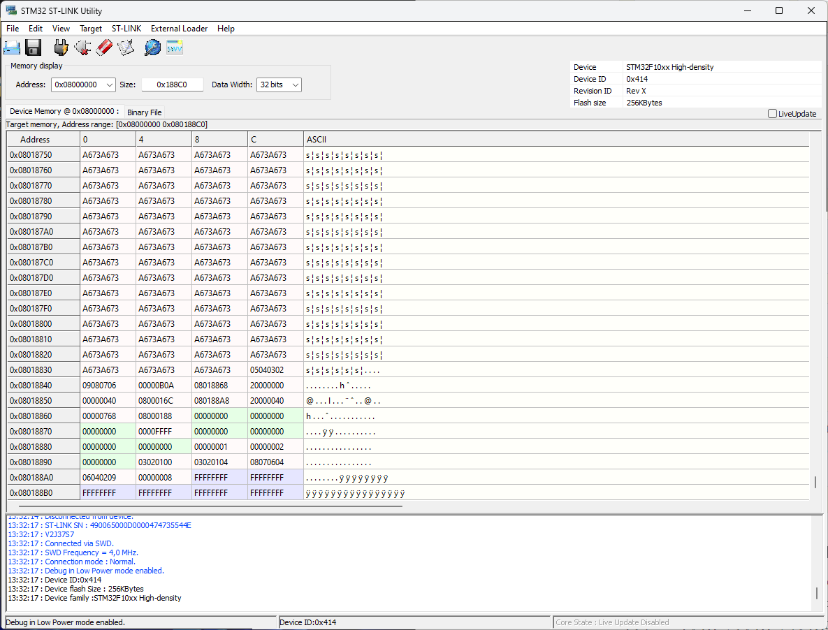

02 May 2024 23:29 #299598 by scotta
Thanks Scott,
I noticed your image your length is different than mine. After 0x000188B0 in my readout all the data displays as FFFFFFFF. so I set the data size as 0x188C0, which creates a ~236KB hex file. Attaching here and photos of what I  see.
refresh with new size:
File Attachment:
File Name: nvmpg-take-3.zip
File Size:42 KB
Cool, I'll take a look at the new file. I did get your previous bin file to decompile in Ghidra after playing with starting addresses etc. I'll need to go back and forth between the earlier decompilation and reverse engineering I did to see if the communication protocol has been changed.

02 May 2024 23:35 #299599 by scotta
Thanks for the hex file, this made the check very easy. The hex is byte for byte identical to the original firmware I also extracted. So the issue must be with the latest Remora firmware.... I'll be back home next week so will hook up my NVMPG and do some checking.

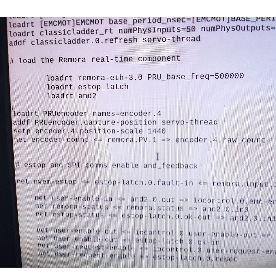

I install the remora-eth-3.0.c component and can start Linuxcnc using the  remora-rt1052-basic profile (having changed the hal file to use remora-eth3.0 module rather than the (old?) remora-nv module).
I can then connect linuxcnc to the NVEM and one of the LED's on the NVEM board turns on or off depending on if I enable or disable linuxcnc.
But when I try to move the x or y stepper nothing happens. Also if I view the remora.inputs I do not see any changes in response to pulling the inputs to gnd.  If I look at the remora.status using the hal viewer it shows the board as connected. If I look at the remora counters using the HAL viewer I can see them incrementing.
So on the face of it it looks like the board is connected but not actually doing anything.
So what have I missed?
Note: I am assuming the remora.inputs should be updated in the hal viewer even if the hal file was wrong.

07 May 2024 04:54 #300000 by scotta
Well, at least some progress. When you say nothing happens when you try to move x or y what is the behaviour? Does LinuxCNC show motion? No following error?
If LinuxCNC is showing motion in the gremlin view then I would suspect a driver wiring issue.
For the IO this only works when the board is not in E-stop condition. ie connection active.

31 May 2024 13:54 - 31 May 2024 14:03 #301954 by Murphy

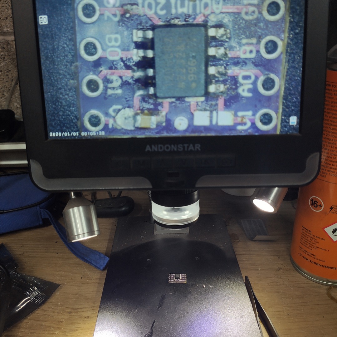

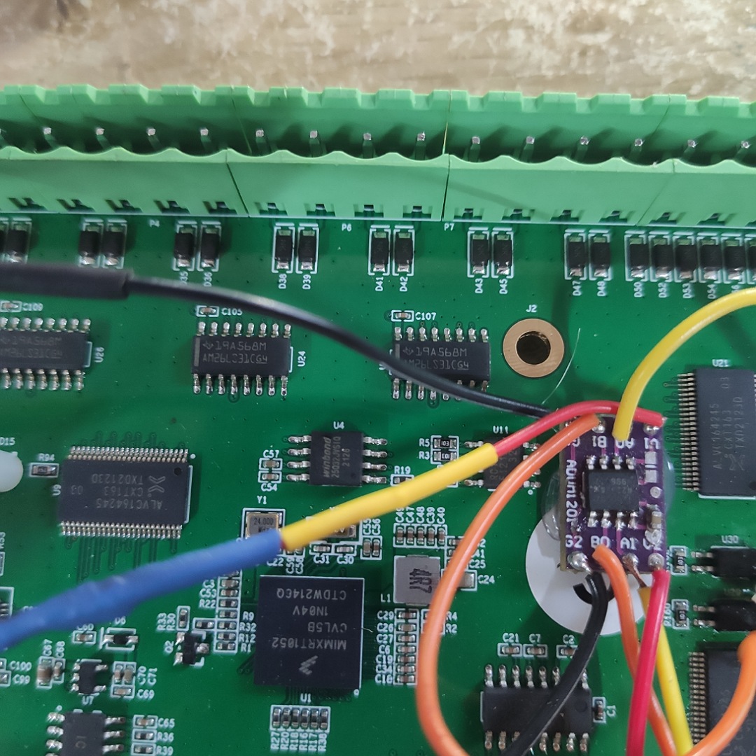

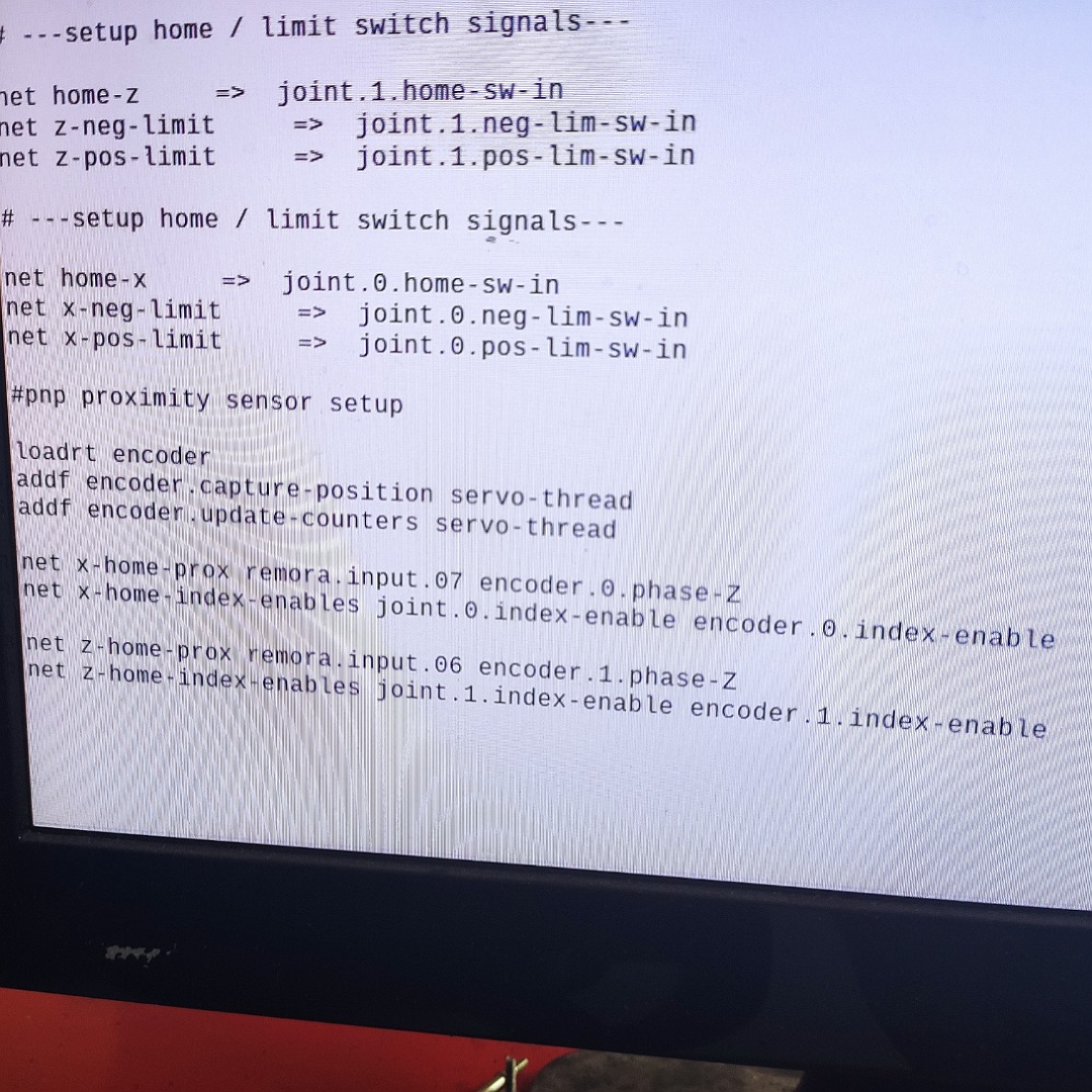

I need a little help testing my encoder setup.Are the following commands in my hal file enough to be able to see the encoder counting.(last pic is my encoder setup for proximity which is working perfect) I went the same route rbobey went and used an ADUM1200. Hooked WHA and WHB through the MPG socket on the board and bypassed the optocouplers. I'm going to use it as my spindle encoder eventually but need to test the encoder setup first to rule out if the board is faulty or If wired something wrong .  In the config file I changed the encoder number to 4 and PV.1
The pic shows ADUM1201, I soldered on a ADUM1200 chip
Last edit: 31 May 2024 14:03 by Murphy.

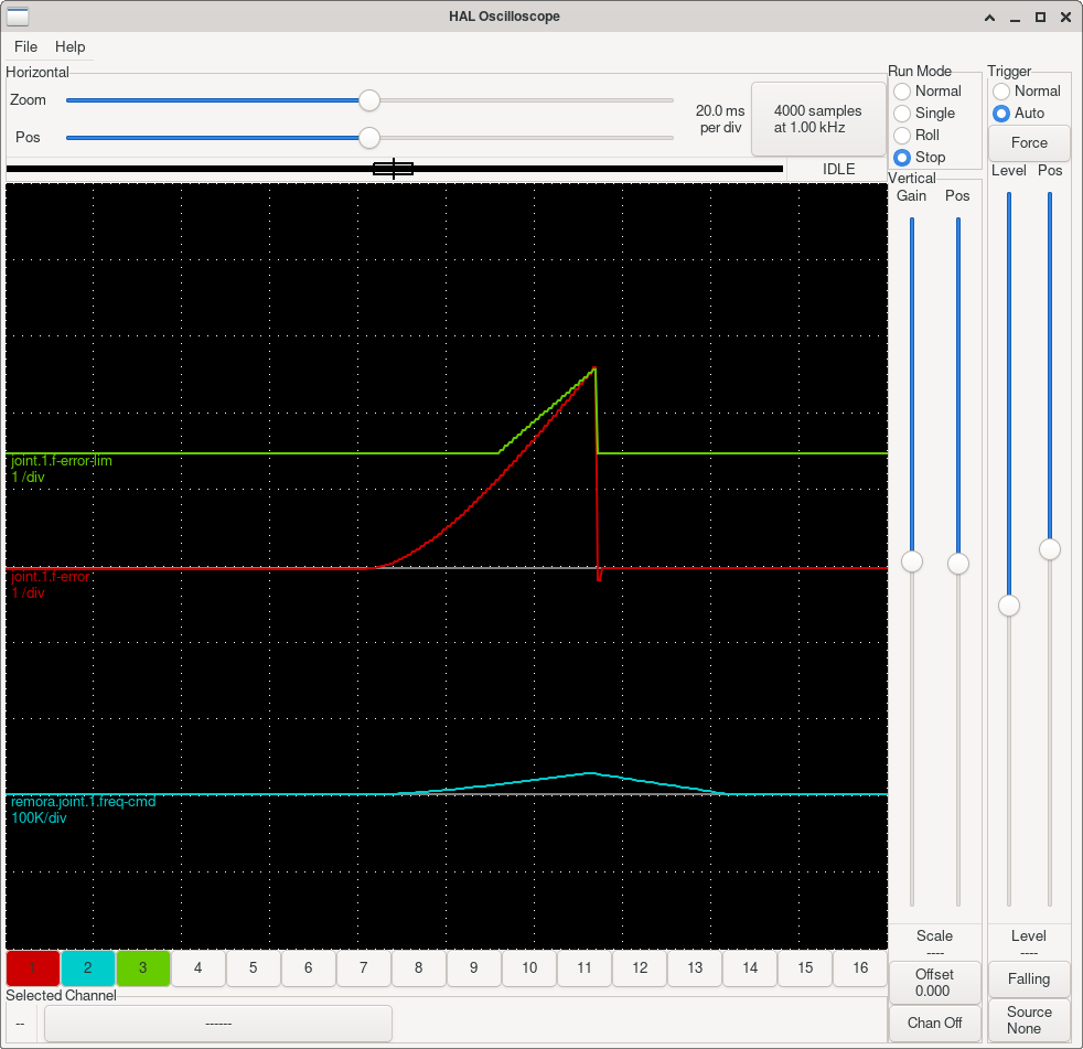

12 Jun 2024 08:15 #302863 by IonCarver
Replied by IonCarver on topic Remora - ethernet NVEM / EC300 / EC500 cnc board
Hi Everyone,
recently I was trying to get started with EC500. I was able to flash the firmware and was able to ping the board on the 10.10.10.10 address. It worked nicely with a pico probe and pyocd.
However, I continuously get joint following errors on all my joints while jogging and while executing gcodes. I cannot get rid of them.
Also, the following error is very high, even at low speeds it is more than 1mm. I also tried to increase the P gain or to increase the spike filter in remora-eth.c component without success.
My computer has the following latency  values:
If I ping the board over a longer period of time, I get following values:
There are some outliers with high ping, but they are rare.
I already tried to reduce the jitter:
- Isolated two cores
- Moved kernel threads to the non isolated core
- Moved NIC interrupt to the isolated core
I can think there can be two source of problems now:
1. Latency jitter of the NIC
2. Latency jitter of the PC (Fujitsu Esprimo P556)
Can you give me some advice please how to debug this problem? How could I trace down which one is the issue?
Thank you for your help.
