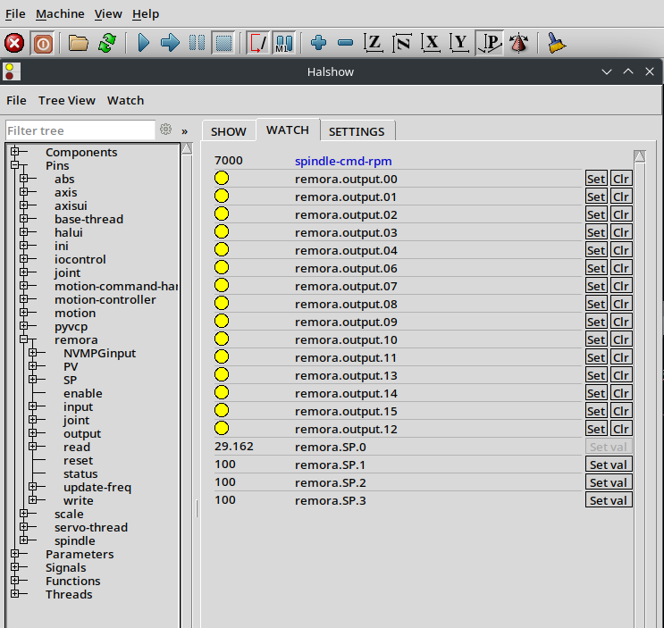

Replied by MrDe on topic Remora - ethernet NVEM / EC300 / EC500 cnc board
Hello,I’m experiencing an issue with the NVEM V5 board (RT1052) when using the Remora firmware. The spindle output (VSO) is functioning as expected, providing a 0-10V signal, but none of the other output pins are working at all. I’ve tried toggling all the output pins (as shown in the attached picture), but none of them are triggering HIGH.
Interestingly, all the input pins are working perfectly fine without any issues.
What I’m trying to achieve is to have the VSO pin control the spindle speed and use both OUT1 and OUT2 to control the direction (CCW | CW).
Has anyone encountered a similar problem or have any suggestions on what might be causing this?
Thanks in advance for any help!

Replied by BSOD on topic Remora - ethernet NVEM / EC300 / EC500 cnc board
I had two lines missing in the hal:
#spindle DAC 0-10 control
net spindle-cw remora.output.00
loadrt pwmgen output_type=1
output.00 is OT1 on the EC300 and if I'm not mistaken the EC500 and NVEM also.

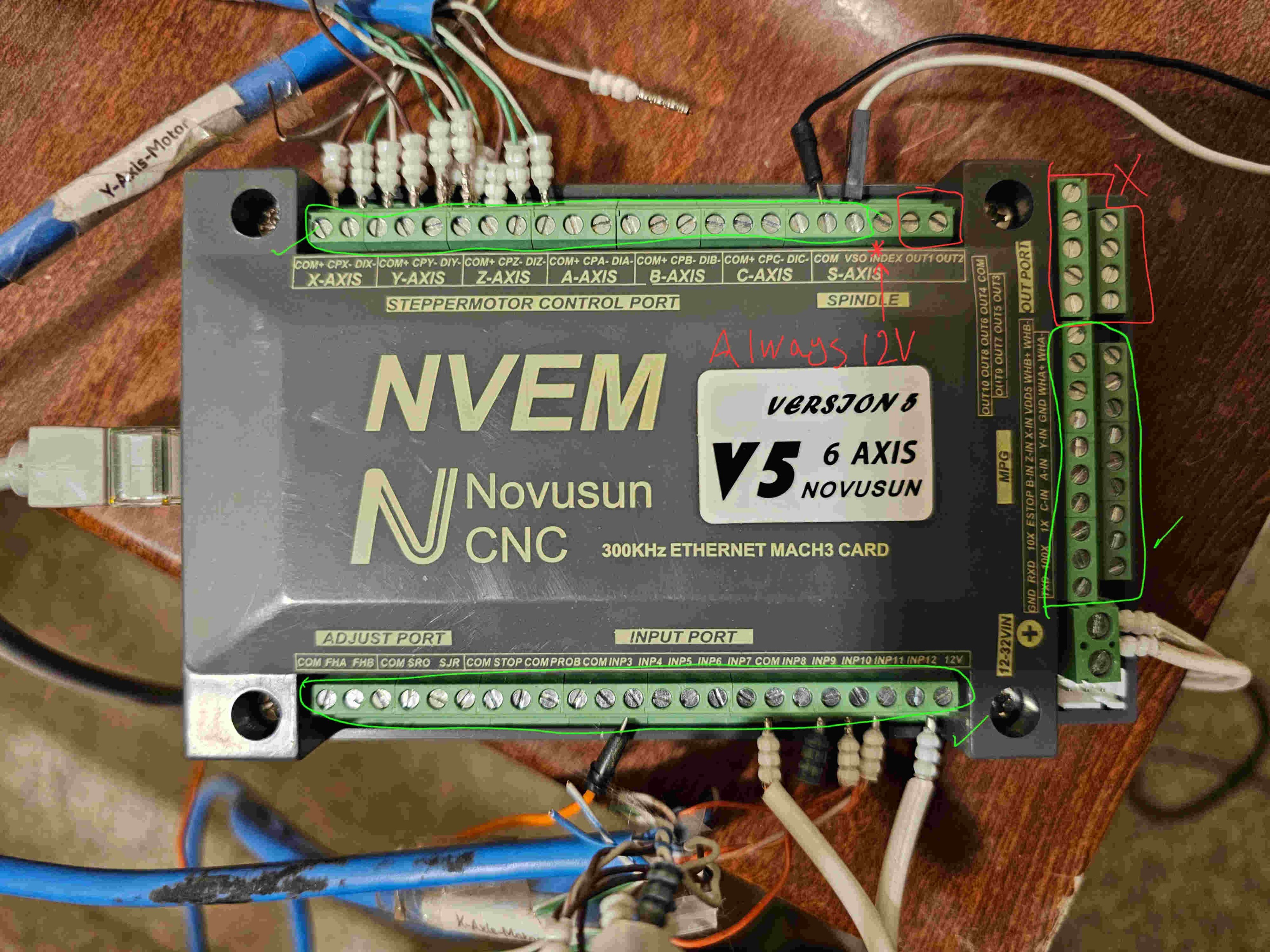

03 Jan 2025 15:32 - 03 Jan 2025 15:46 #317936
by MrDe
Unsurprisingly, your EC500 config file didn't work with my NVEM V5 board. So what I tried next was to git clone the repo named Remora-NVEM instead of the one I used previously named Remora-RT1052-cpp. However, when I uploaded the nvem-full-config.txt to the board, it messed things up, and now nothing works. It doesn't even accept any other config uploads anymore, and I'm stuck. I think I would have to reflash it and start all over again.
Anyway, back to my original problem: The outputs of the NVEM V5 board are all unresponsive, no matter what config I use. If anyone has a working setup for the output pins with the NVEM V5 board, please share it. Thank you so much.
By the way, just for a sanity check — when the output pins are high, should they be outputting 12V? What I'm doing is measuring all the OUTPUT(+) pins with COM(-), but I get a 0V reading. I assumed it’s not working, so any guidance would be much appreciated!
I’ve attached a picture that shows the difference between the responsive and unresponsive pins for reference.
