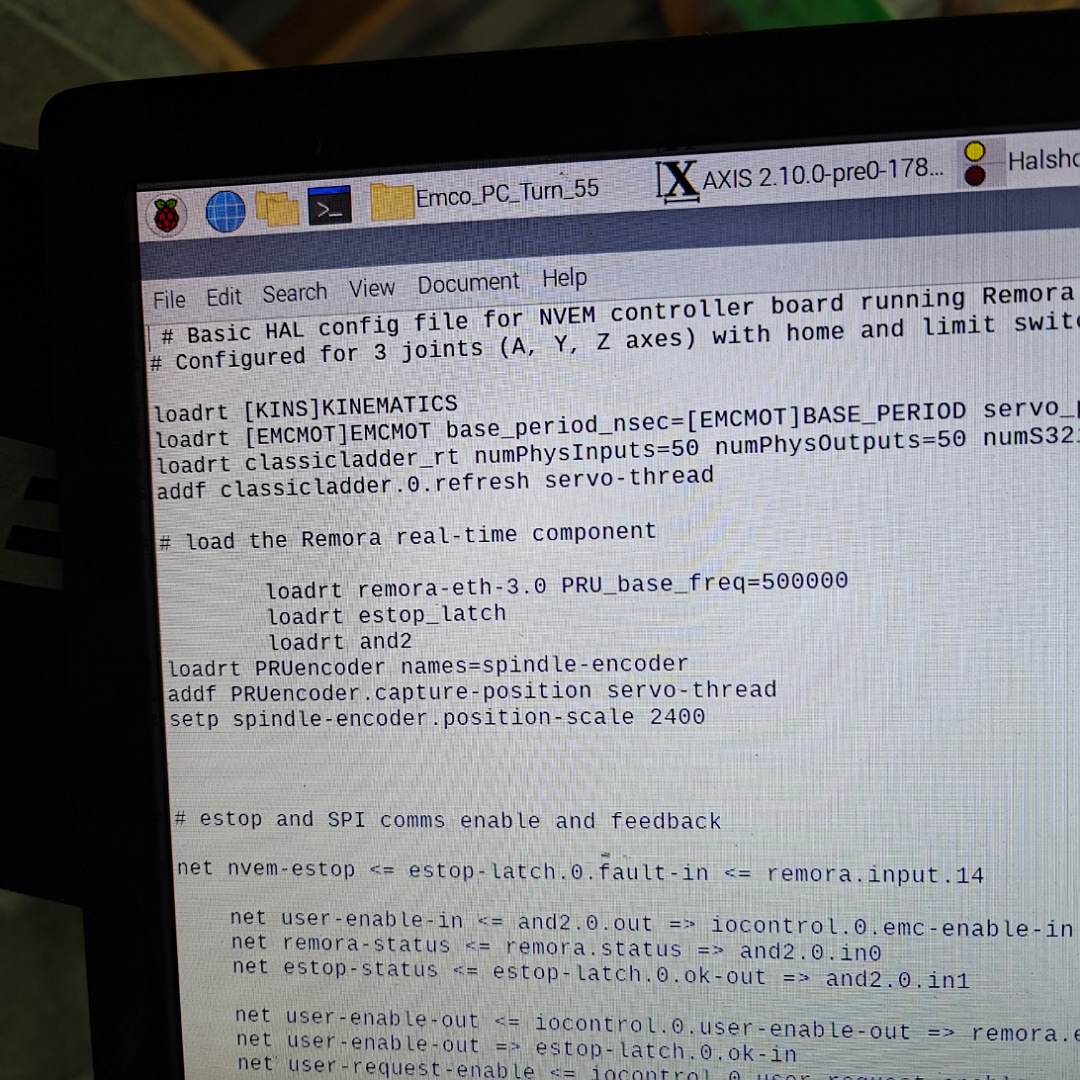

Hi can someone help me with the spindle. I have it working on a basic level 0-10v through a VFD, but want to add the encoder. I'm getting confused with the PRUencoder and linuxcnc encoder. I have no spindle speed displayed. I think I need to add the phaseZ pulse somewhere. Pv and raw count is counting in both directions. I have no index enable , is this a physical output pin connected to something? phaseZ is coming in on remora.input.13.

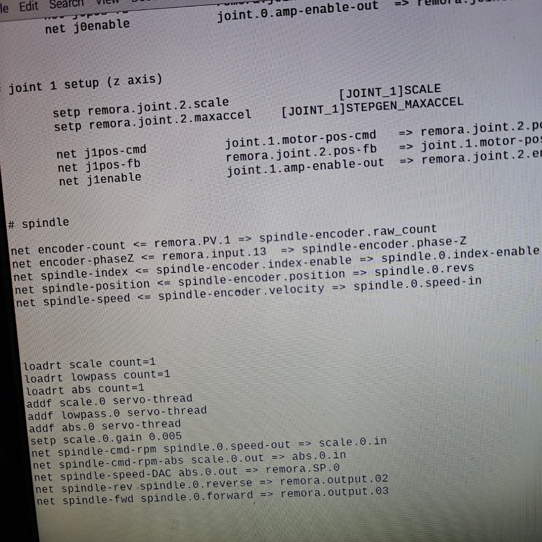

Murphy, here is how I have done my spindle

Thank you Cakeslob, with your encoder scaling, you have it set to ENCODER_SCALE for position to be rpm. I have mine set to the ppr of the encoder which is 2400. When I rotate it by hand and it gets to 2400 counts after one rev encoder position is set to 1 in halshow. So it seems to be scaled right. PhaseZ is triggering in halshow also. I have a separate Z pulse coming from the emco encoder wheel on the spindle which triggers around 1400 counts(I don't think this matters?)but when z triggers nothing resets, is this normal? tried deleting the ppr scale number and putting ENCODER_SCALE but it won't start with it, dosnt recognise it. Am I missing something on the ini file for encoder position to be rpm ?

Nothing should reset until you flip the index enable pin, then when you rotate, it will reset the revs(i think) pin when it hits z index pin

Thanks Cakeslob I entered some of your hal file in mine for the spindle rpm. The spindle seems to be working a lot smoother than before. I also have the rpm displaying now.
Iv ordered a Chinese clone differential line encoder. So I'll single end it with an AM26ls32 IC. Hopefully that will get rid of the noise

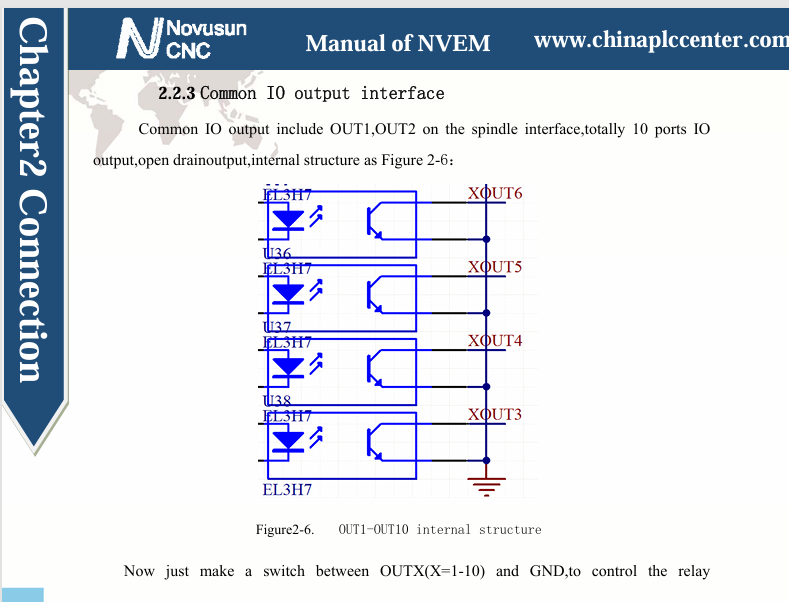

Hi, the outputs on the NVEM are not an output voltage like your thinking. They are as shown in the diagram attached. Basically a switch sinking to ground.
