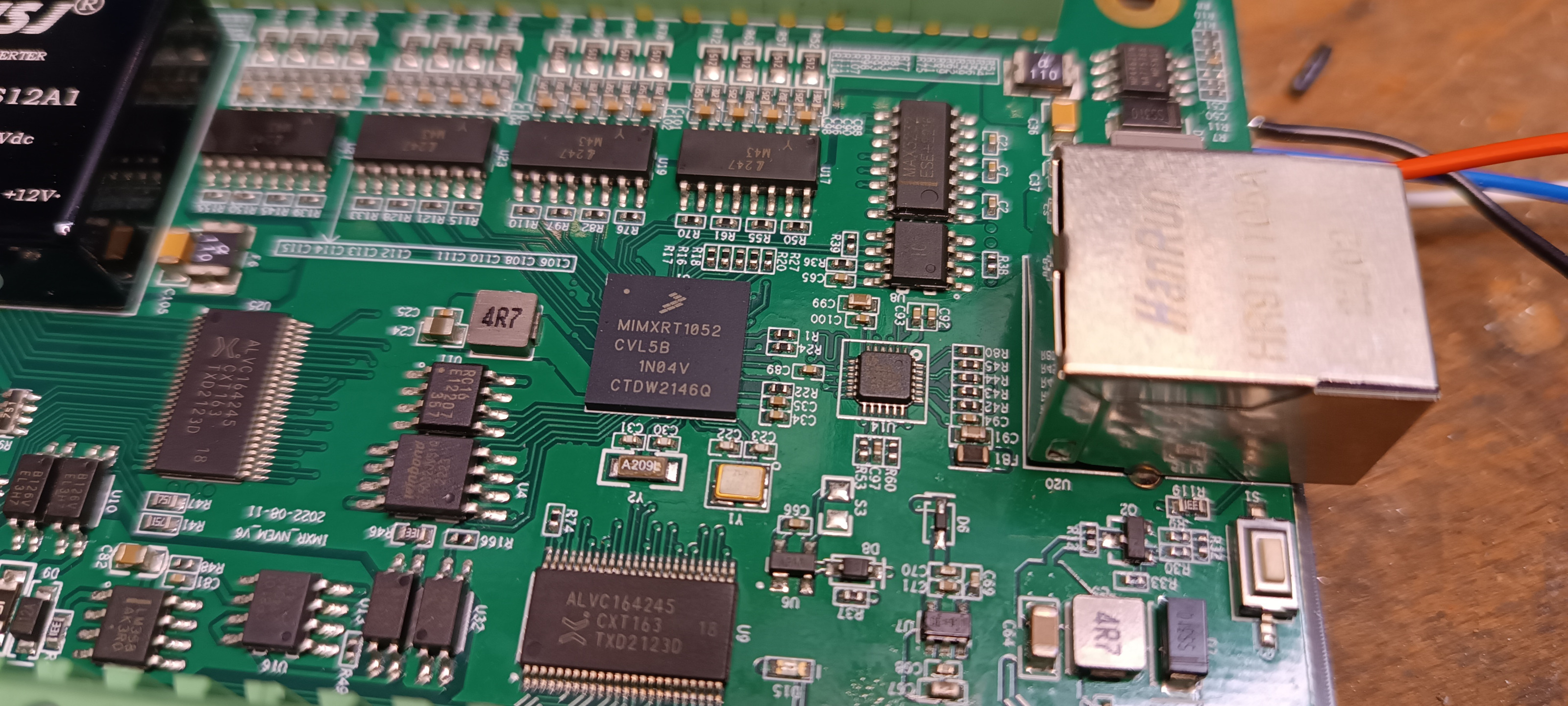

Good morning guys, I bought my nvem v5 board to test with linuxcnc, I'm still waiting, I saw in the files that there is an encoder component to compile in linuxcnc to use in remora, this component was created to only accept the mpg encoder or is there a possibility of using the mpg input to connect an encoder to a spindle or the spindle shaft of a lathe, I don't know if it is possible to use just the mpg encoder input or there is a way to use other inputs if configured, could you give me more details of this part of the encoder on the nvem board? thank you in advance thank you very much
Hi, for the MPG the encoder counting is done in LinuxCNC using the normal inputs as the speed is low. The PRUencoder module is used for the hardware based encoder modules. The NVEM is limited on Inputs, but please check the EC500 configuration below with the NVEM configuration to identify which inputs are available for the QDC encoder module.

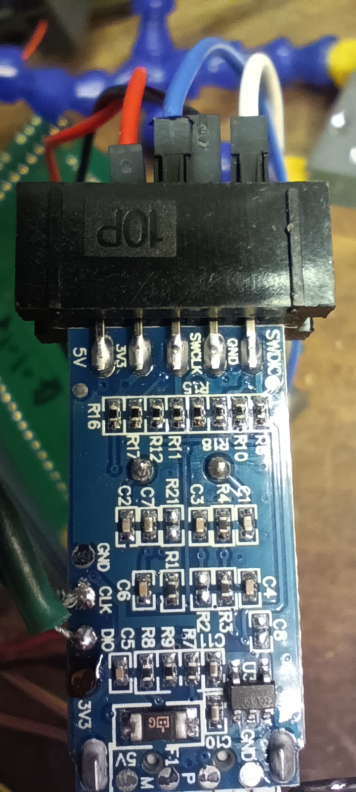

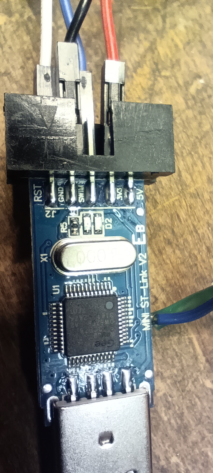

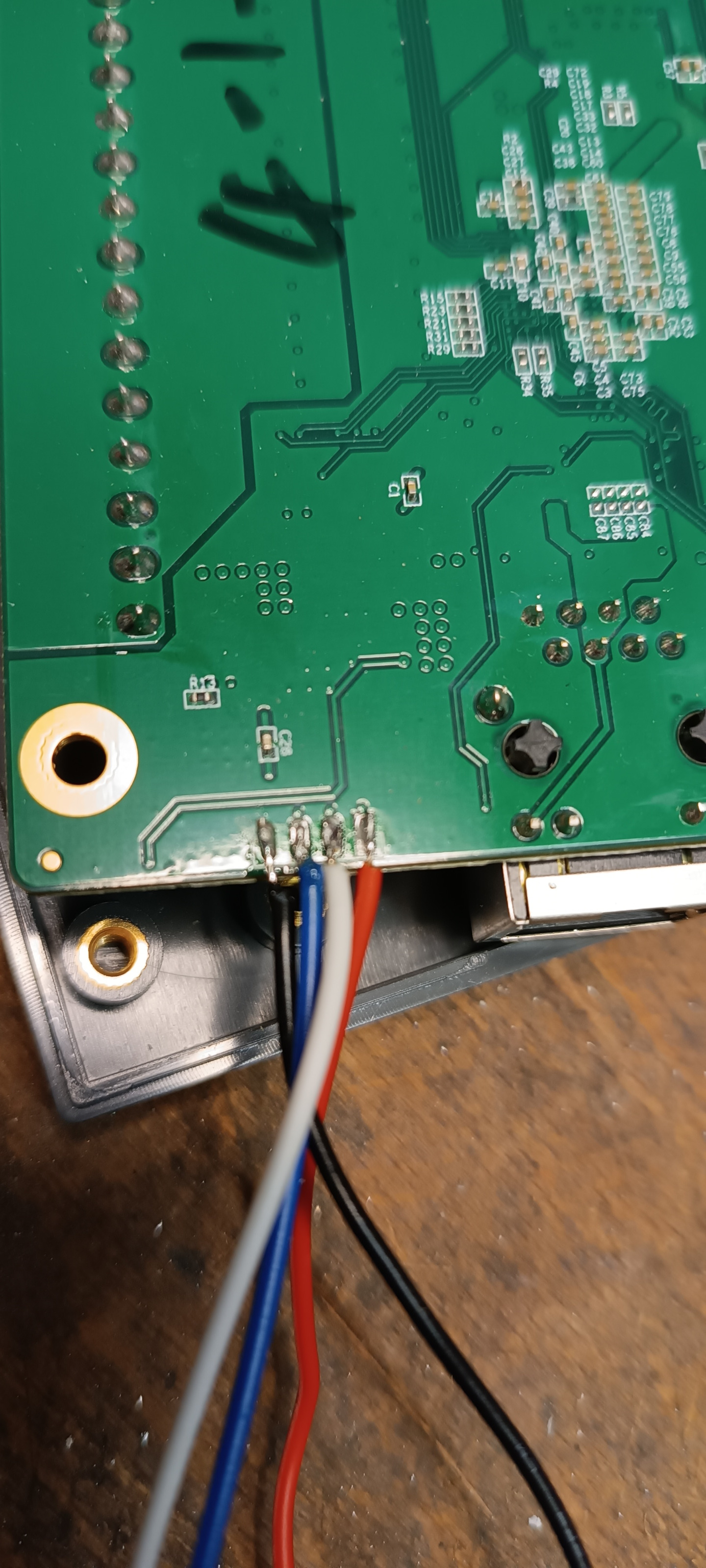

Hello all
I now have installed pyocd, but no luck with connecting. I guess it should show a target id here ?
xx@xxxxxx:~# pyocd list
# Probe/Board Unique ID Target
0 X893 ARM CMSIS-DAP 0001A0000000 n/a
Flashing fails then too:
xx@xxxxxx:~# pyocd flash /home/bf/Downloads/remora-rt1052-3.1.3.bin –-target mimxrt1050_quadspi
0000497 W Generic 'cortex_m' target type is selected by default; is this intentional? You will be able to debug most devices, but not program flash. To set the target type use the '--target' argument or 'target_override' option. Use 'pyocd list --targets' to see available targets types. [board]
0000674 I Loading /home/bf/Downloads/remora-rt1052-3.1.3.bin [load_cmd]
0000690 C No boot memory is defined for this device [__main__]
Anything wrong with the wiring ? I got 24v supplied to the remora board
schnellmued
The pyocd warning is hinting that the command line is not correct and it's defaulting the generic target type that cannot flash memory.
pyOCD/docs/target_support.md at main · pyocd/pyOCD
Is there a typo in the command line arguments?

26 Nov 2024 18:45 - 26 Nov 2024 18:48 #315317 by schnellmued
Replied by schnellmued on topic Remora - ethernet NVEM / EC300 / EC500 cnc board
I used the "--target" option, like show in the help output, but i found the variable "target" in "board.py" was allsways "None". So i did the quick & very dirty fix to change default to my board:
# As a last resort, default the target to 'cortex_m'.
if target is None:
target = 'cortex_m'
to
if target is None:
target = 'mimxrt1050_quadspi'
Finaly it flashed the board and i got it connected to linuxcnc :D
