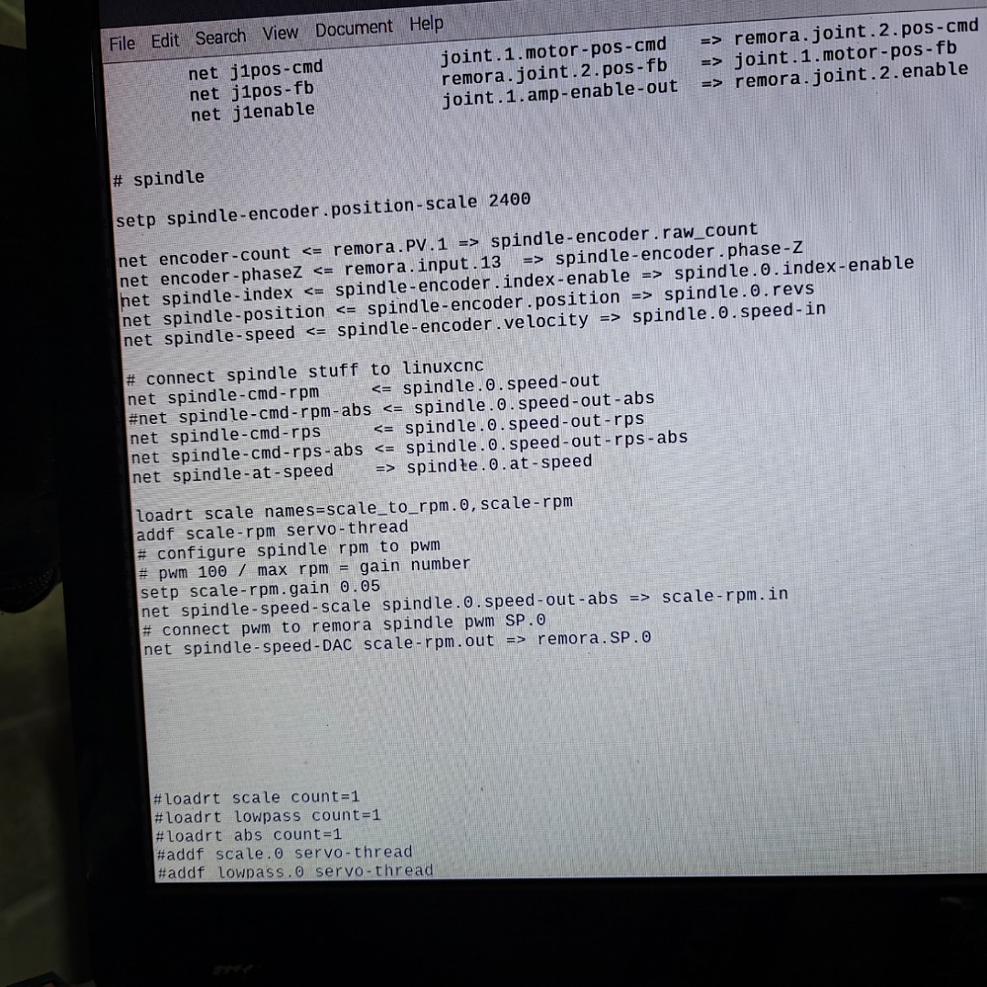

18 Jan 2025 15:17 - 18 Jan 2025 15:21 #319290
by Murphy
Replied by Murphy on topic Remora - ethernet NVEM / EC300 / EC500 cnc board
I'm still having issues with interference with the encoder. But it works at very low speed. I'm trying to get the feed per rev working but I can't. anyone spot any issues with the halshows pins in the video? Spindle is working fine and displayed on the axis scale. It looks like there is no spindle rev ,
youtube.com/shorts/x5vOVZpoqSU?si=Opf2Nhoud6VPGWp0

18 Jan 2025 19:13 #319305
by cakeslob
Replied by cakeslob on topic Remora - ethernet NVEM / EC300 / EC500 cnc board
Hey Murphy, i cant really see whats happening in the video but i think I can tell
github.com/cakeslob/RRW_LAB/blob/inc/Lin...c/remora_encoder.hal
github.com/cakeslob/RRW_LAB/blob/inc/Lin...c/remora_spindle.hal
check out these 2 hal files, specifically the encoder one, or just try them out. the encoder one has a lowpass filter to smooth out the rpm signal

18 Jan 2025 20:02 #319309
by Murphy
Thanks cakeslob, I copied everything from yours last time, the only thing I don't have is the low pass, I'll give it a shot thanks

18 Jan 2025 21:04 - 18 Jan 2025 21:08 #319315
by cakeslob
yeah the lowpass if what gives a stable(ish) velocity output from the encoder

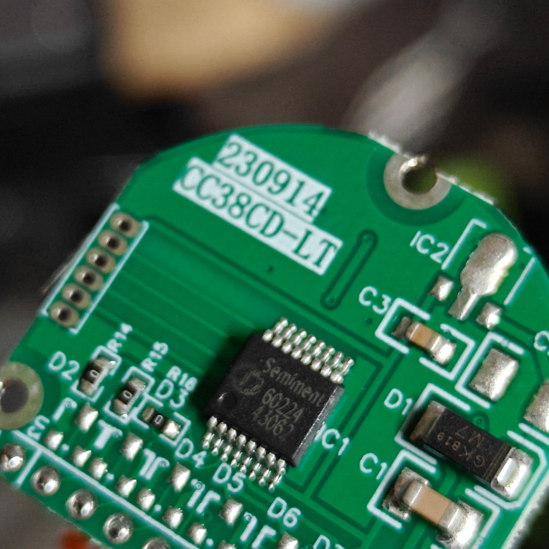

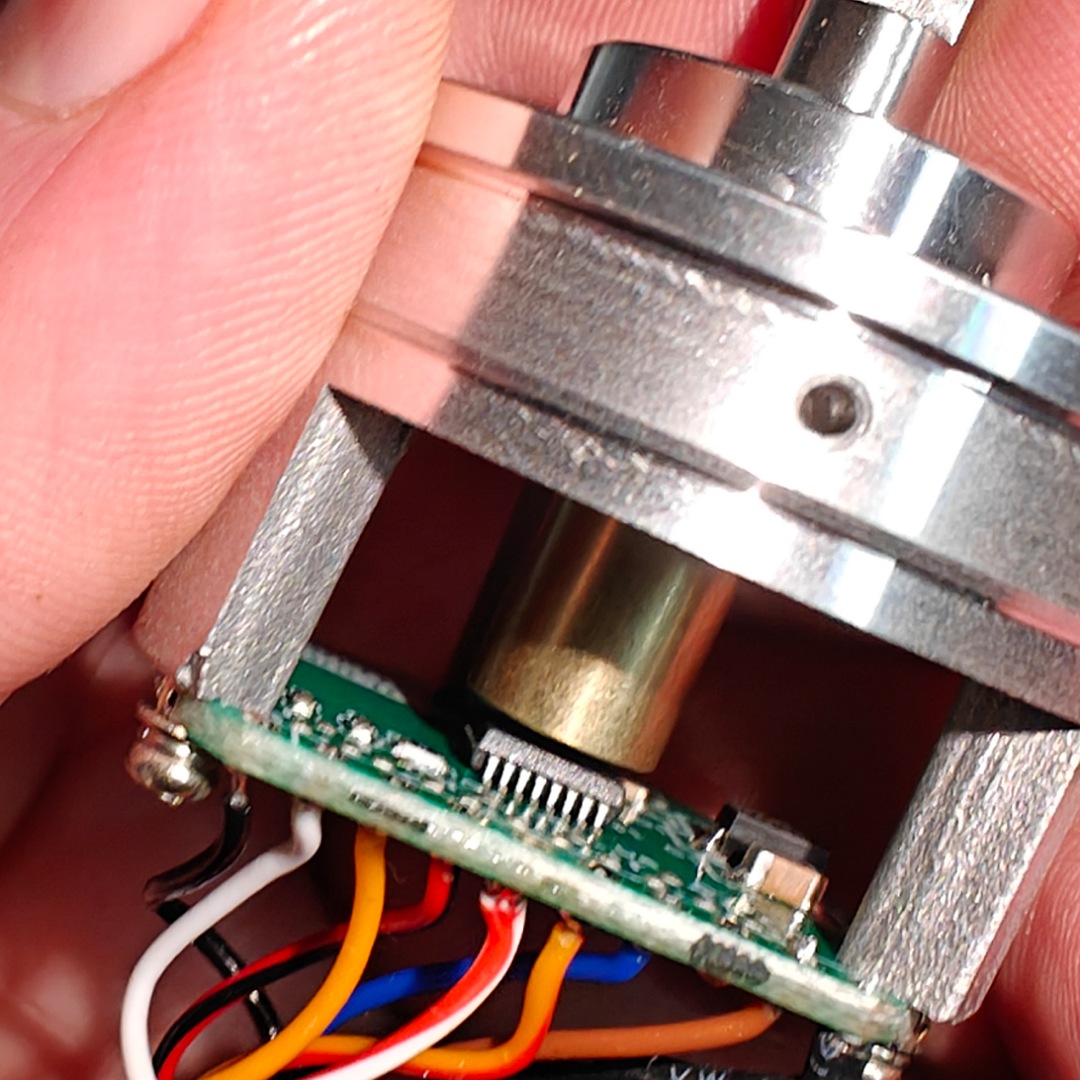

19 Jan 2025 19:57 #319401
by Murphy
I'm going to buy a genuine omron encoder. I think a lot of my problems are with these cheap knock offs. All of the ones I have opened don't have an encoder wheel inside. Iv no idea how it's able to get the signal accurately. See pic attached of one of them.
So how does the Z index pin work with the ec500. I have A and B working and connected to the WHA and WHB of the MPG bypassing the opticouplers. If I want to attach the Z from the encoder what pin does this connect to? Will I have to bypass another opticoupler?
