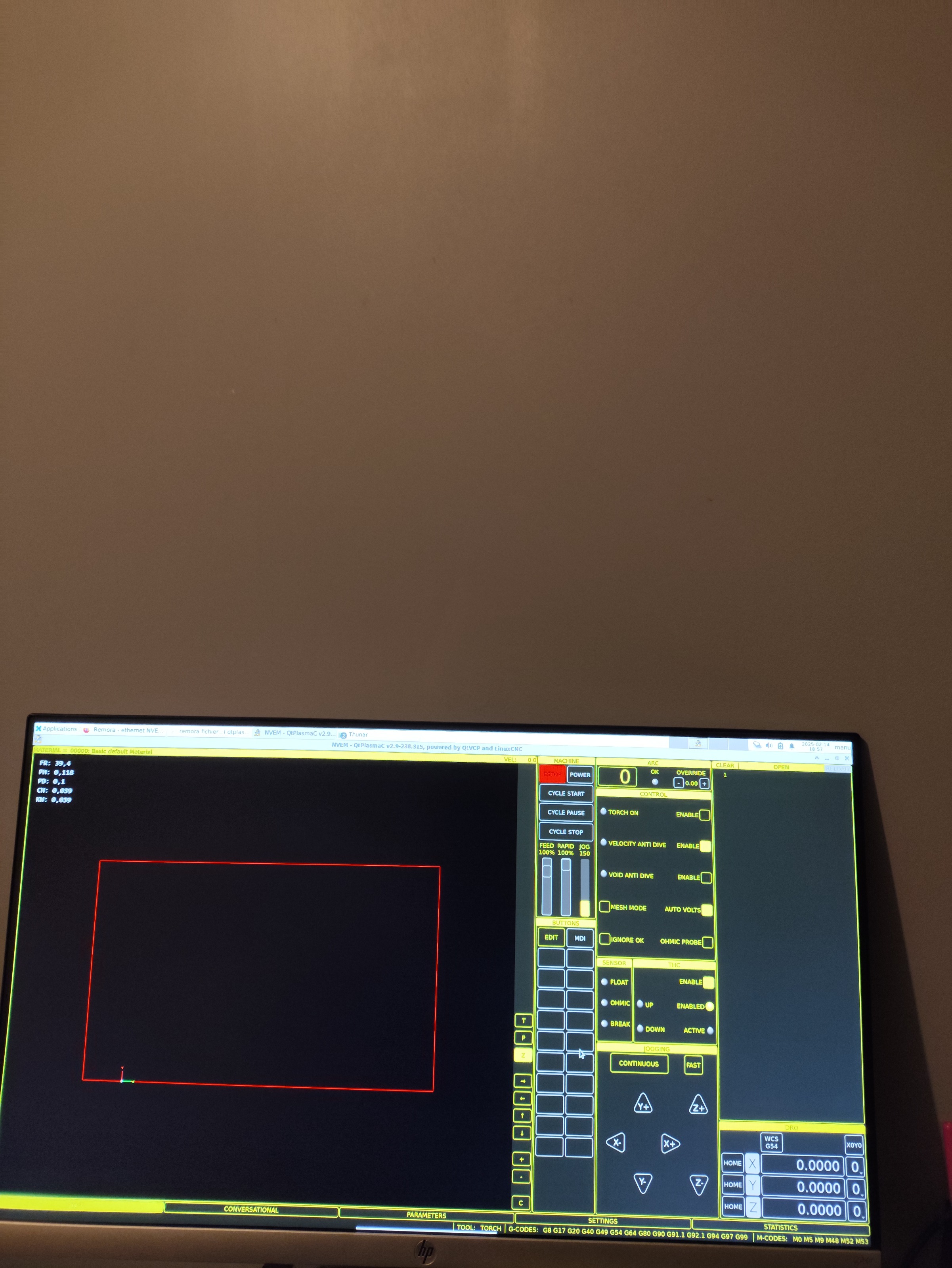

If anyone had a qtplasmac config for the NVEM, they would have ended our suffering 2 pages ago.
its probably this, i think the THC probably uses external offsets.
add this line and report back
github.com/rodw-au/showstopper/blob/master/my_Plasma.ini#L226
or the next time an error pops up, you can try and trace it out, using all those other plasmac examples I posted before, or by referring to rods config I just listed, otherwise this will be a very long process.
Replied by cakeslob on topic Remora - ethernet NVEM / EC300 / EC500 cnc board
has anyone made qtplasmac work with a NVEM card?
File "/usr/share/qtvcp/screens/qtplasmac/qtplasmac_handler.py", line 220, in __init__ float(self.iniFile.find('AXIS_Z', 'OFFSET_AV_RATIO')) * 60 File "/usr/share/qtvcp/screens/qtplasmac/qtplasmac_handler.py", line 220, in __init__ float(self.iniFile.find('AXIS_Z', 'OFFSET_AV_RATIO')) * 60

well I'm saved because I see that you are starting to lose patience,
but I'm not fired because I have the emergency stop that does not unlock but I think I know where it comes from,
for info I went to debian 12 with linuxcnc 2.9.4 while I was on mint with linuxcnc 2.9.0
Many thanks to you I will post my file and the 2 to 3 things that I know

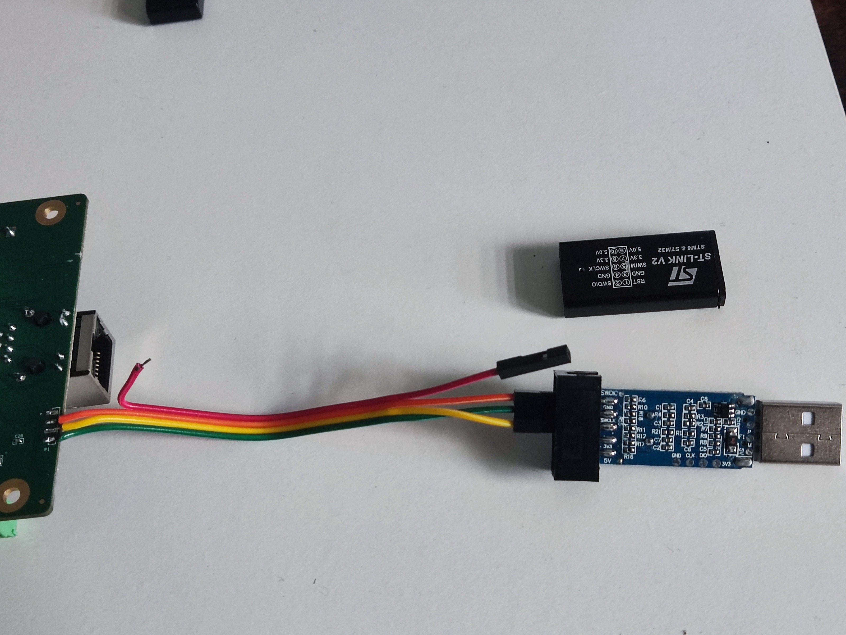

Good evening, I tried to follow this tutorial, but I couldn't find the stlink bin file, the DAPLink file no longer exists, I couldn't find it anywhere
Replied by Thayloreing on topic Remora - ethernet NVEM / EC300 / EC500 cnc board
- scotta
- Posts: 959
- Thank you received: 489
17 Feb 2025 19:43 #321860
by scotta
This is no longer the recommended method to flash the board. pyOCD has proven to be more reliable.
Use the first part of the video to convert a ST-Link to a CMSIS-DAP probe with the following firmware.
github.com/scottalford75/Remora-NVEM/blo...NVEM-STM32-1.0.0.bin
And then use pyOCD to flash the board as described in this thread.

Should I just download the bim from pyodc and put it in stlink v2 and after that I will be able to record remora on nven? Could you detail me step by step?
- beauxnez
- Posts: 149
- Thank you received: 10
18 Feb 2025 17:57 #321926
by beauxnez
Replied by beauxnez on topic Remora - ethernet NVEM / EC300 / EC500 cnc board
hi no you use a stlink (the green one on the video) to flash a second stlink adapter (the blue one on the video),
then you take the key that you flashed (the blue one) you connect it to a pc and you use PYOCD with the command pyocd flash .\remora-rt1052-3.1.3.bin --target mimxrt1050_quadspi as in the photo
youtube.com/shorts/kLOyWslSZU0?si=C3GMQaH--oAvvTZk

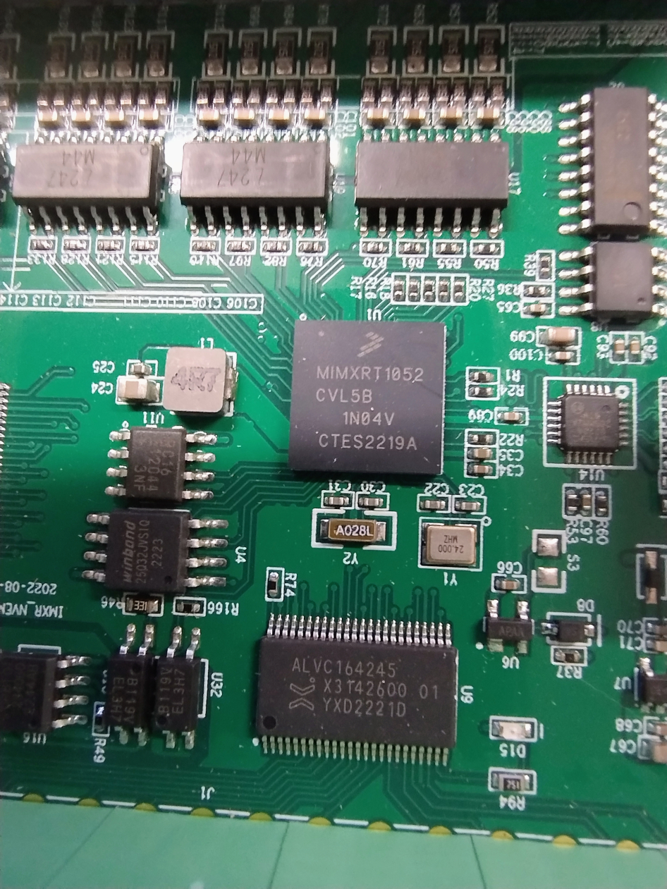

hi Scotta
I wanted to compliment you on the work you have done and made available
to the LinuxCNC community.
I am excited about it and I bought an NVEM V5 to try to install the Remora firmware,
but when I opened the case I noticed that the chip is not an STM32F207 but the one in the photo
is it still compatible or did I buy the wrong card?
Thanks if you can give me some advice
P.S. sorry Scotta
I went a bit back with the posts and at 191 there is the answer to my question, thanks,
I'll move on....
P.S. sorry Scotta
I'll move on....

Thank you so much for your help, your video helped a lot, I was able to flash on Stlink V2, but how do I install and use pyqcd, I didn't find anything that helped me, I could explain to me, or point someone who has already asked this question to see what He did1
