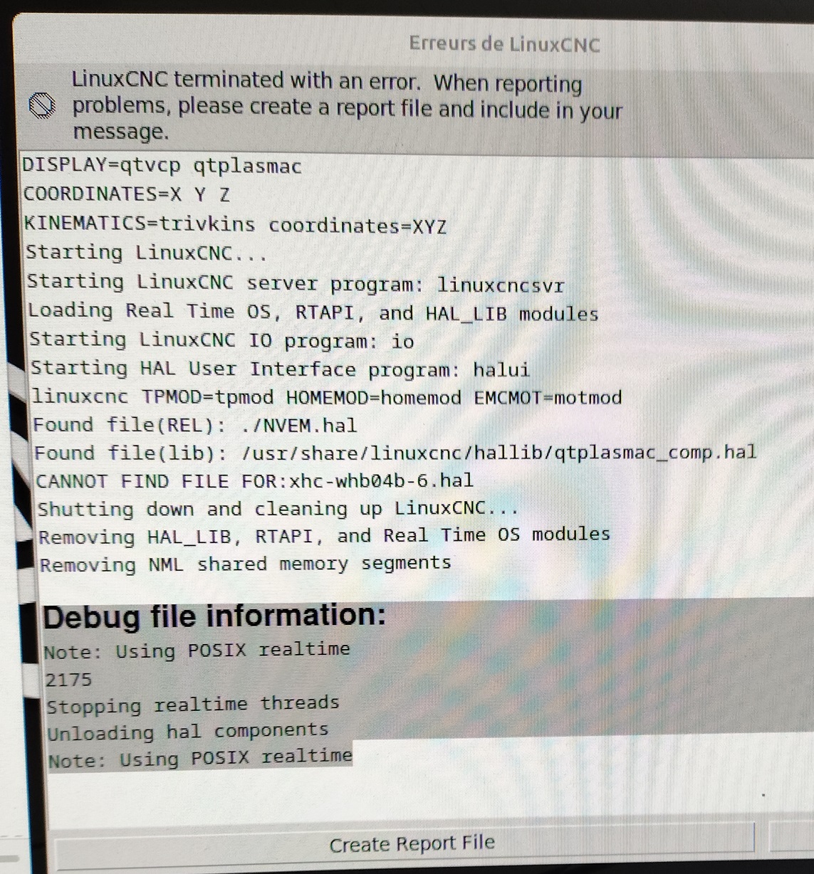

thanks but I'm really sorry but I don't know what I'm doing (it's Chinese to me)
I see in the qtplasmac_comp.hal file the line "net plasmac:scribe-start spindle.1.on => plasmac.scribe-start"
should I copy it into my NVEM.hal file?

add this to [TRAJ] in your ini file
SPINDLES = 3Please Log in or Create an account to join the conversation.

same error when modifying the .ini file

alright in hal, change this line to this
loadrt [EMCMOT]EMCMOT base_period_nsec=[EMCMOT]BASE_PERIOD servo_period_nsec=[EMCMOT]SERVO_PERIOD num_joints=[KINS]JOINTS[TRAJ]SPINDLES

still an error
Debug file information:
Note: Using POSIX realtime
MOTION: num_joints is 33, must be between 1 and 16
motmod: rtapi_app_main: Operation not permitted (-1)
./NVEM.hal:5: waitpid failed /usr/bin/rtapi_app motmod
./NVEM.hal:5: /usr/bin/rtapi_app exited without becoming ready

yeah, did you fix the other 2? the first one is you didnt install the nvmpg component, and the second one is the halfile for that usb pendant isnt present
but yes thats how you connect the x thing probably

I think I misread that first error,
remove the xhc-whb04b-6.hal
[HAL]
HALFILE = NVEM.hal
HALFILE = qtplasmac_comp.hal
HALFILE = xhc-whb04b-6.hal
HALFILE = custom.hal
POSTGUI_HALFILE = postgui_call_list.hal.remove the xhc-whb04b-6.hal
