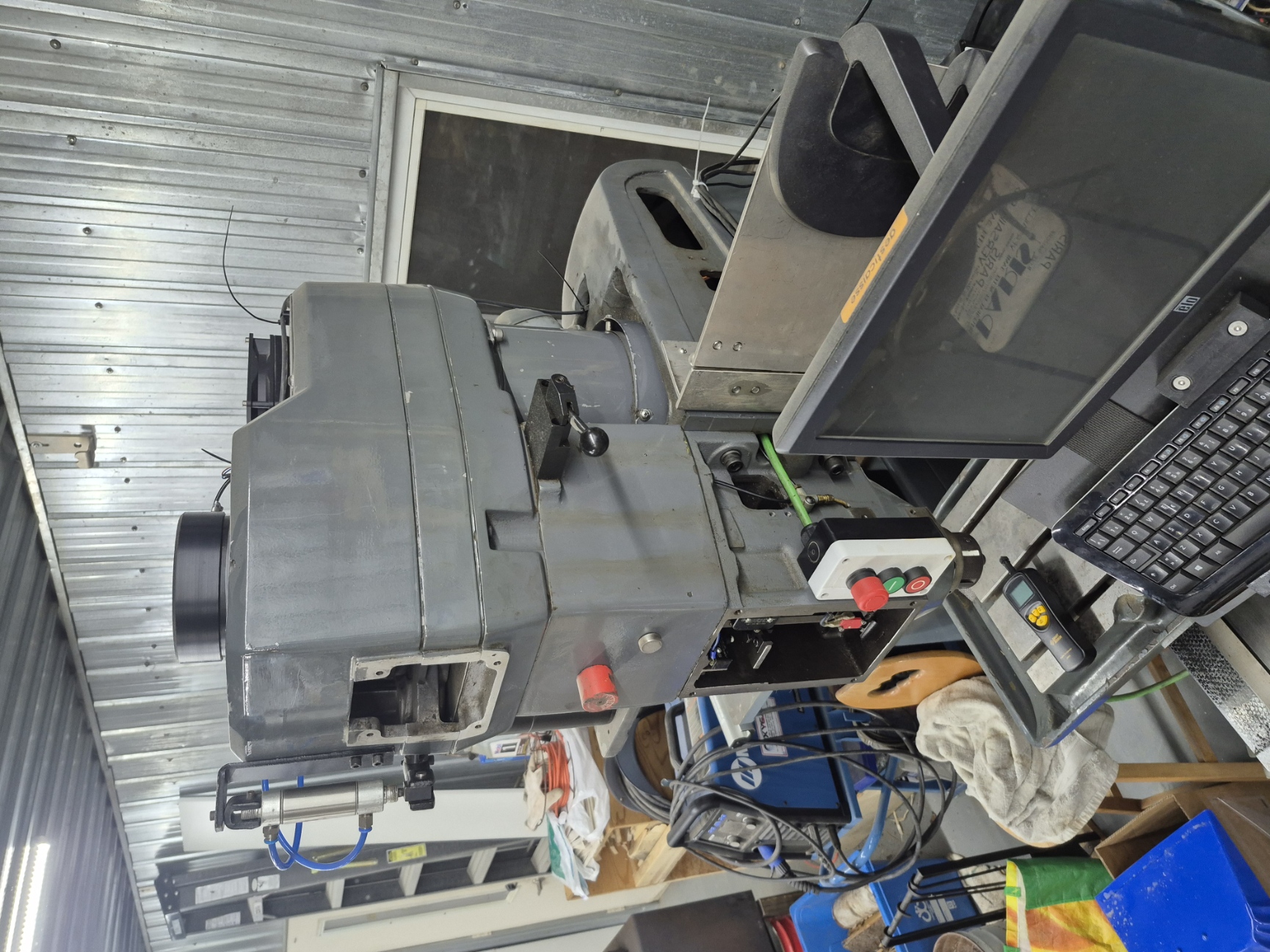

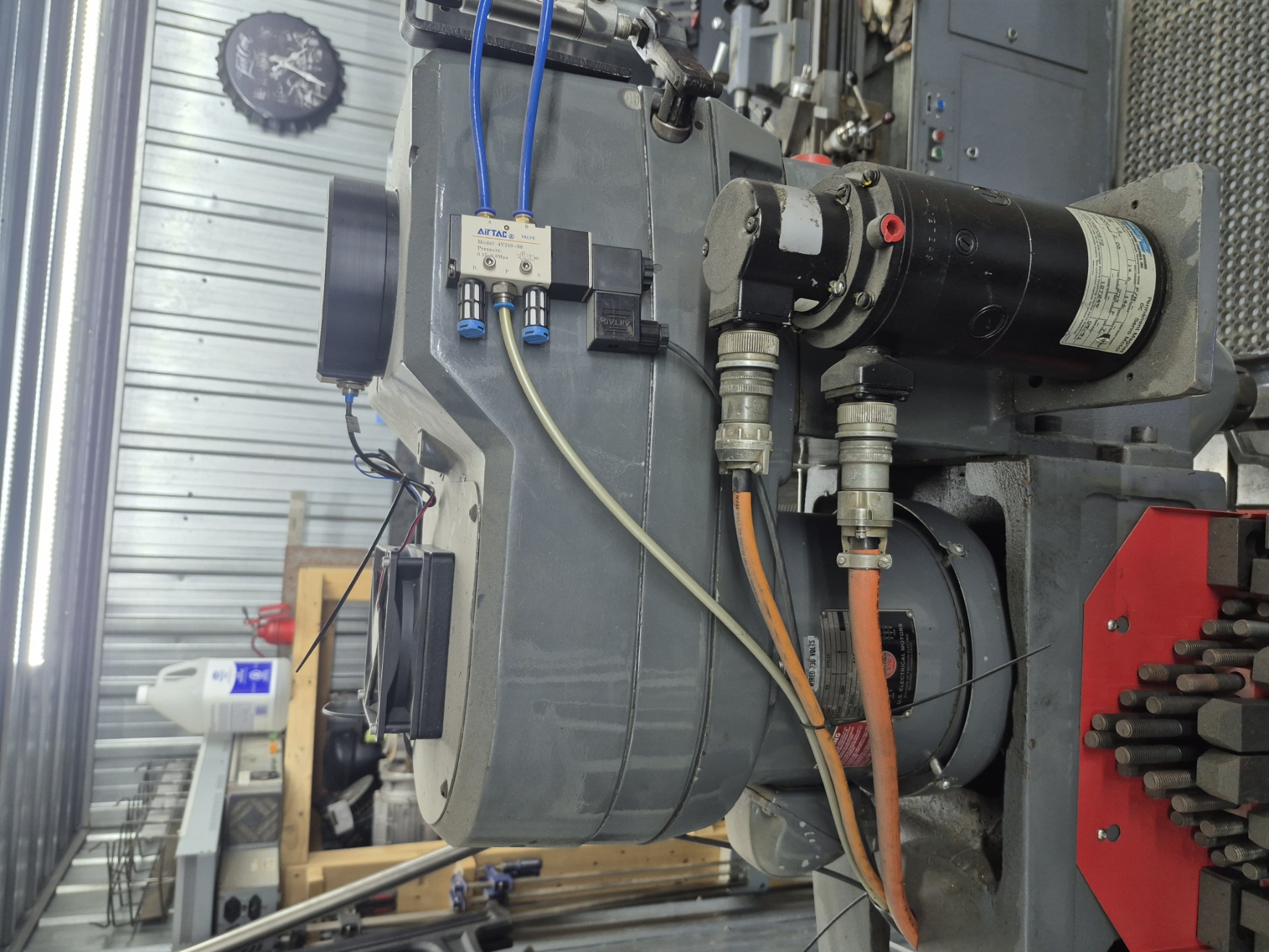

22 Jan 2025 10:04 #319624
by vpomerleau
Replied by vpomerleau on topic Remora - ethernet NVEM / EC300 / EC500 cnc board
Hi Cakeslob! Thank you for your reply. I attached some picture of my mill for clarity. So I got 1710 RPM motor with a fixed 1.8:1 pulley ratio, the encoder is on top of the second pulley, after that I have a lever for High/Low lever that with a 8.3:1 ratio. It's possible to put the encoder after all that but a lot of work. So my ultimate goal is when I call M3 S1650 the control output what he think is the correct 0-10v voltage, read the value from the single pulse Hall sensor and adjust the voltage to hit the target perfectly. I think it's closed loop. The cherry on top would be the ability of rigid tapping but not sure if it is possible with my current configuration. Probably a lot of work and if I need another kind of encoder i'm willing to replace it, i started this project 5 years ago and i'm not in a hurry. If I understand correctly, the remora PRUencoder doesn't work with single pulse hall sensor so your code is probably not suitable for my setup. The maximum pulse frequency is 5000/minute, does the EC-500 can handle that?

22 Jan 2025 22:31 - 22 Jan 2025 22:31 #319682
by cakeslob
Replied by cakeslob on topic Remora - ethernet NVEM / EC300 / EC500 cnc board
Ok, and the quill is motorized it looks like? We can figure out the ratio stuff later. lets start by ensuring you get the proper rpm from remora. I think the board is doing a 0-10v analog correct? You should be able to measure the voltage output from the board and verify its outputting correctly.
If I have this correct, when you S5000 M3, it should read 10v.
edit, to do threading, you will need an encoder.

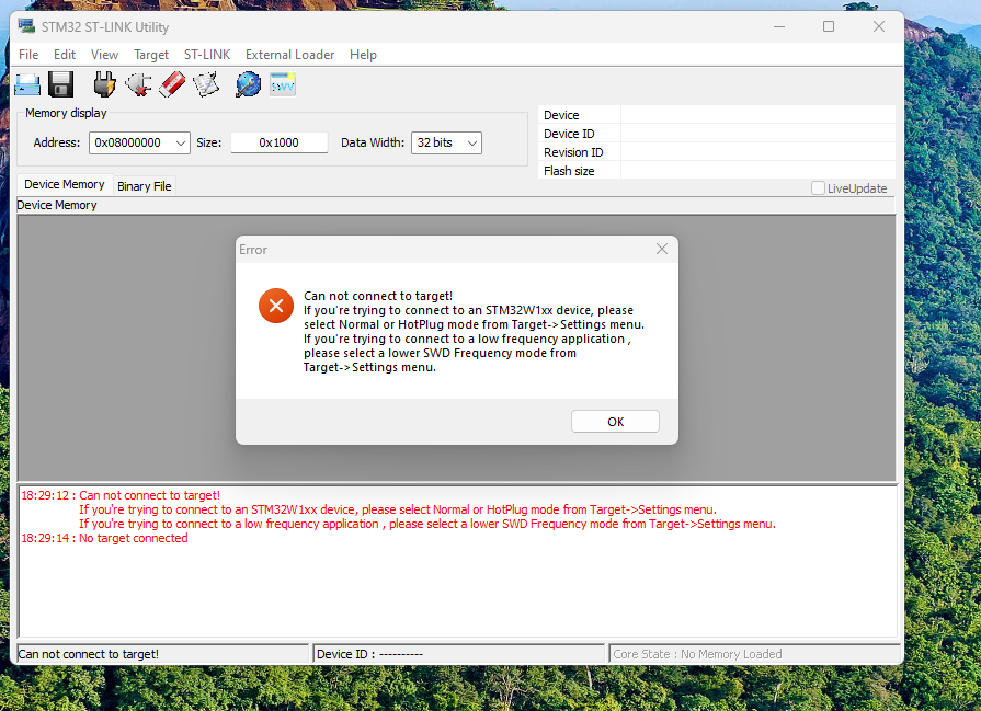

- beauxnez
- Posts: 149
- Thank you received: 10
05 Feb 2025 17:31 - 05 Feb 2025 17:34 #320769
by beauxnez
Replied by beauxnez on topic Remora - ethernet NVEM / EC300 / EC500 cnc board
1. Convert an ST-Link to a CMSIS-DAP probe by using a a second ST-Link and the ST-Link utility to flash the CMSIS-DAP firmware.
mvdlande.wordpress.com/2015/10/05/cmsis-...ink-v2-mini-adapter/
2. Use pyOCD with the newly flashed CMSIS-DAP probe to flash the firmware to the controller board
python -m pip install -U pyocd
pyocd flash .\remora-rt1052-3.1.3.bin --target mimxrt1050_quadspi
github.com/scottalford75/Remora-RT1052-c...ora-rt1052-3.1.3.bin
Hello, I'm coming back to the charge on my RT 1052 card, I'm trying to flash with the CMSIS-DAP firmware but I have an error message the card is not detected?
