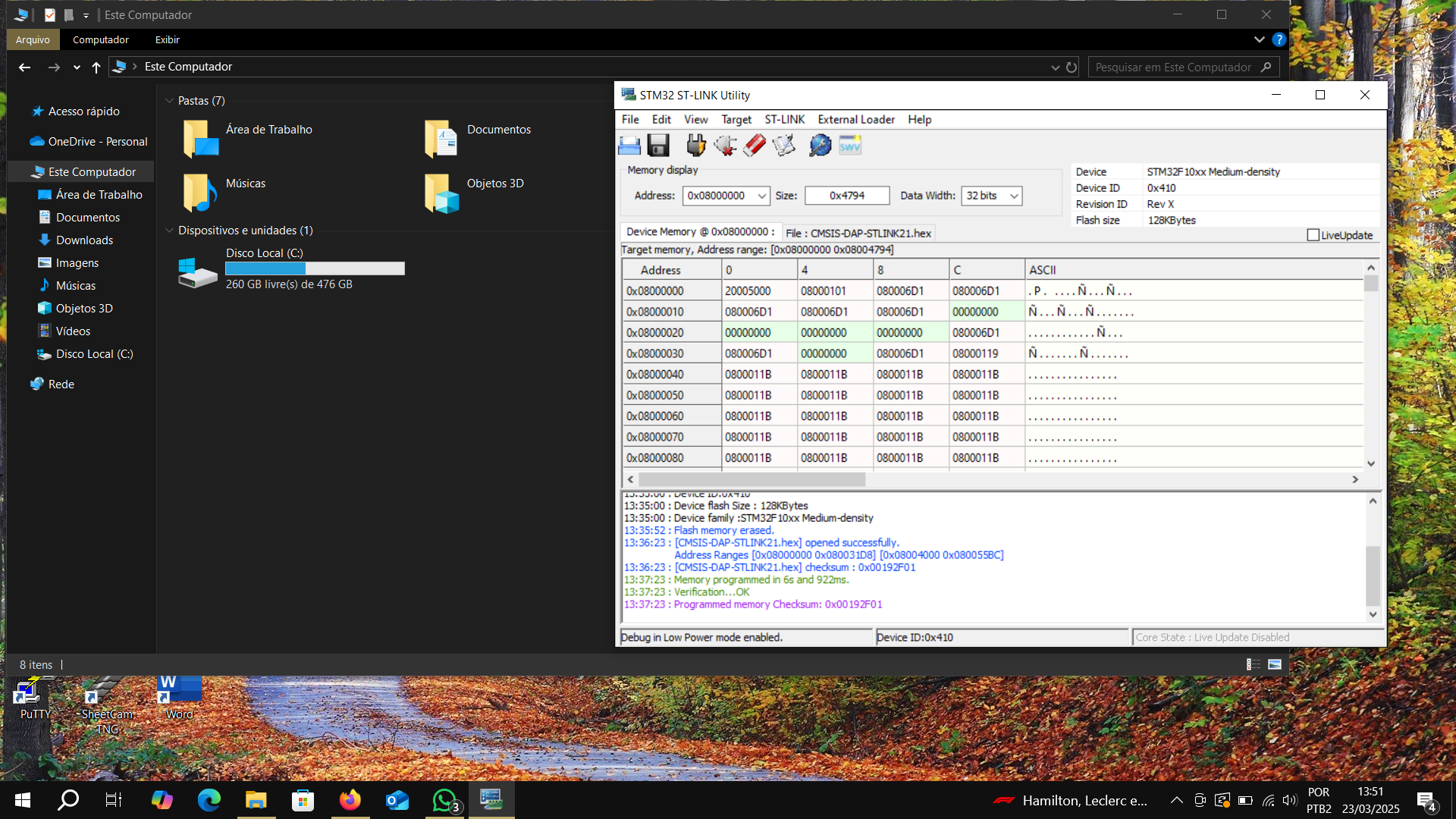

23 Mar 2025 16:52 #324675
by Thayloreing
Replied by Thayloreing on topic Remora - ethernet NVEM / EC300 / EC500 cnc board
I did the whole process to change the firmware of the stlink, it was successful, but it does not appear on my PC, the only difference is that I did not find the blue stlink so I did it in a green one, I used two green stlinks, would there be any difference? If so, how do I find the blue stlink, when I go to buy the cover and everything is the same

29 Mar 2025 17:00 #325265
by cakeslob
Replied by cakeslob on topic Remora - ethernet NVEM / EC300 / EC500 cnc board
um... good question...
you dont actually load the stlinks with remora firmware. stlinks probably need the daplink firmware or something, and then the stlink passes the firmware from the computer to the NVEM
- tuxcnc
- Posts: 275
- Thank you received: 52
30 Mar 2025 06:14 #325302
by tuxcnc
Replied by tuxcnc on topic Remora - ethernet NVEM / EC300 / EC500 cnc board
No. The ST-Link works without any modifications.stlinks probably need the daplink firmware or something

- tuxcnc
- Posts: 275
05 Apr 2025 17:01 #325769
by tuxcnc
pyocd erase --chip --target mimxrt1050_quadspi
pyocd reset --target mimxrt1050_quadspi
pyocd flash remora-rt1052-3.1.3.bin --target mimxrt1050_quadspi
pyocd reset --target mimxrt1050_quadspiyes?how?
The following user(s) said Thank You: DarkPhoinix
