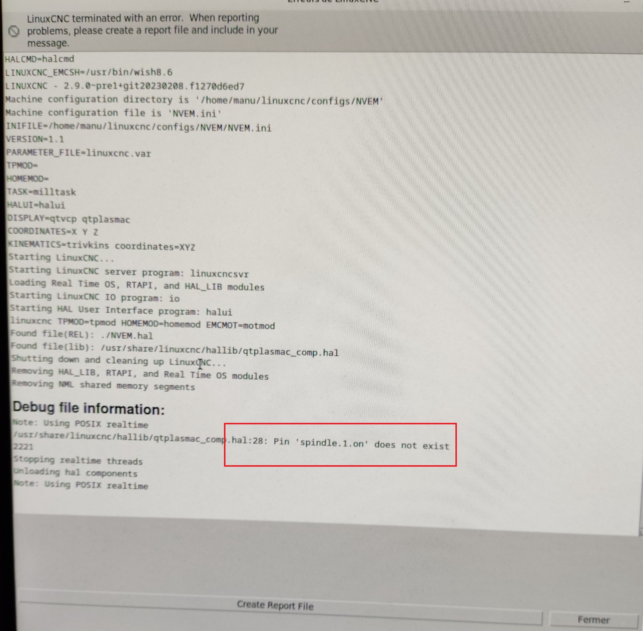

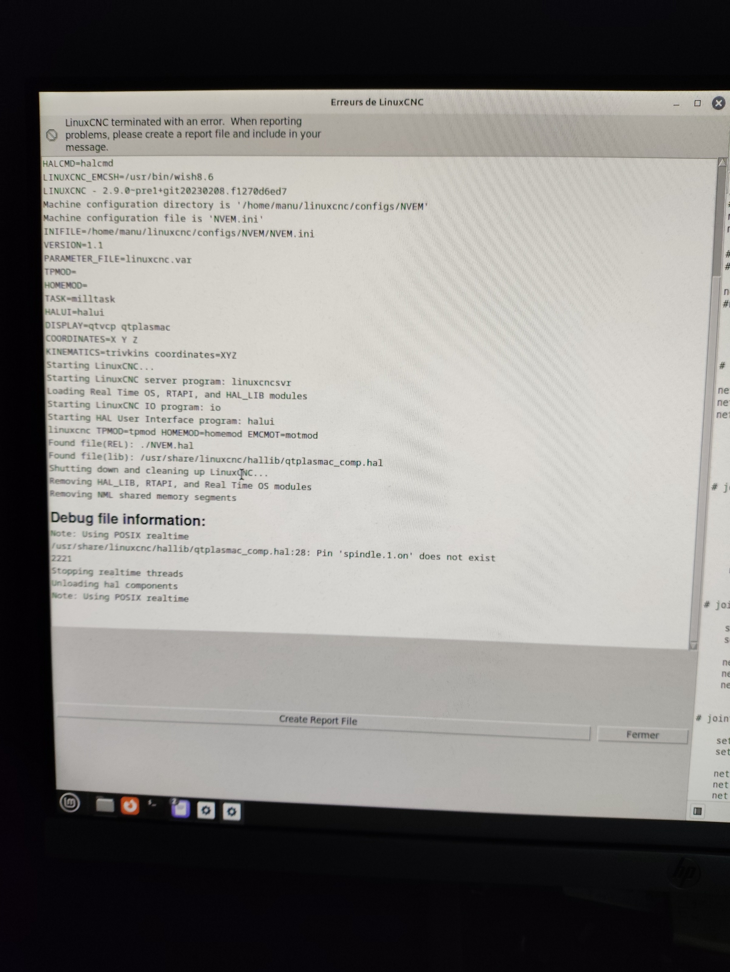

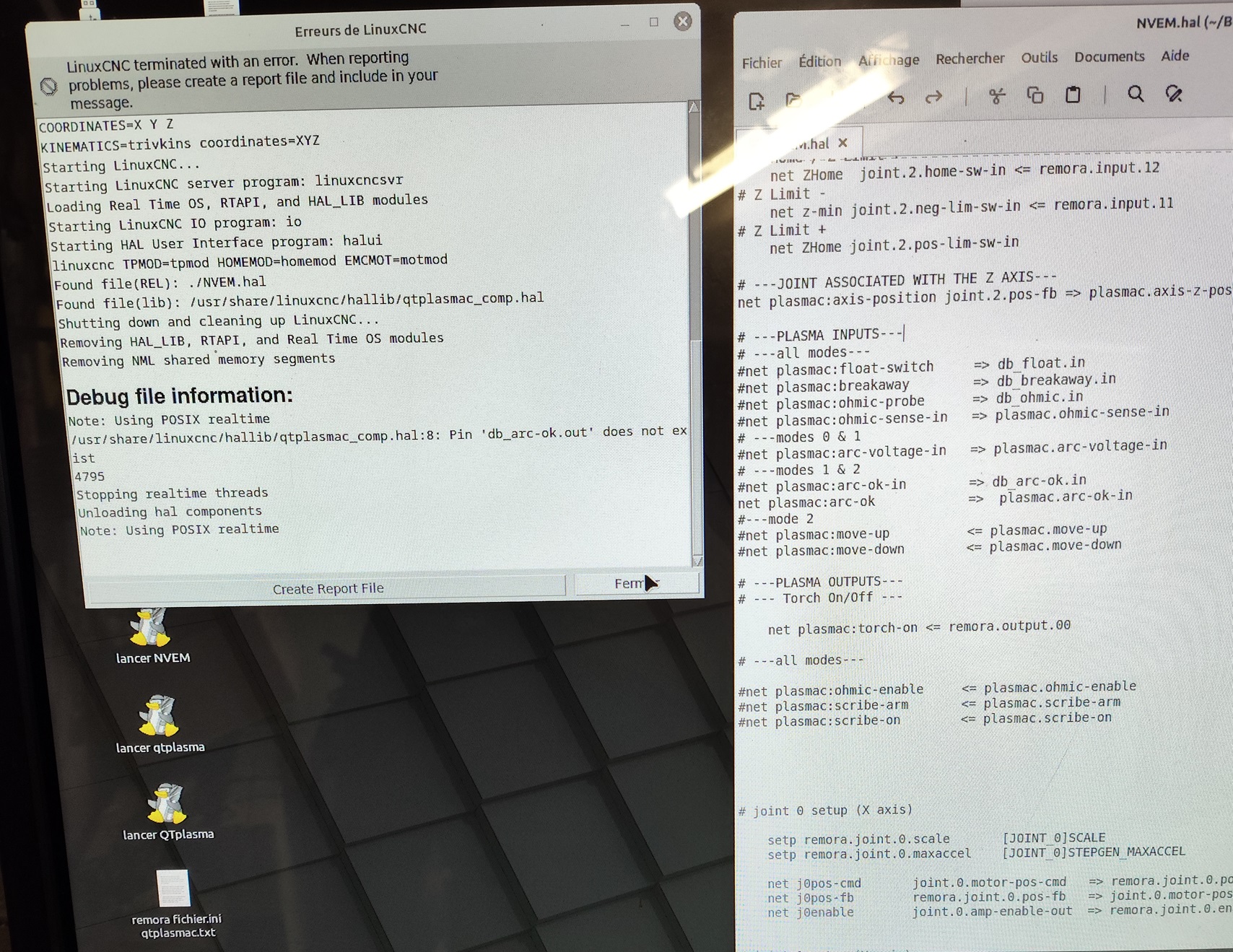

08 Feb 2025 21:49 #321023
by beauxnez
I saw that you managed to make a card work under remora with qtplasmac
my card now works with the 3 axes under axis
I would now like to pass it under qtplasmac, I need help because I have an error message?
Replied by beauxnez on topic Remora - ethernet NVEM / EC300 / EC500 cnc board

08 Feb 2025 23:57 #321031
by cakeslob
Replied by cakeslob on topic Remora - ethernet NVEM / EC300 / EC500 cnc board
github.com/LinuxCNC/linuxcnc/blob/master...smac/machine.tcl#L83
the error says db_arc-ok.out does not exist ,
the qtplasmac_comp.hal needs those debounce pins
github.com/LinuxCNC/linuxcnc/blob/master...tplasmac_comp.hal#L8
you need to set up those debounce pins to use qtplasmac

09 Feb 2025 21:47 #321119
by cakeslob
the error says spidle.1.on does not exist ,
the qtplasmac_comp.hal needs those spindle pins
github.com/LinuxCNC/linuxcnc/blob/master...plasmac_comp.hal#L28
you need to set up those spindle pins to use qtplasmac
github.com/LinuxCNC/linuxcnc/blob/master...c_metric_ini.inc#L46
