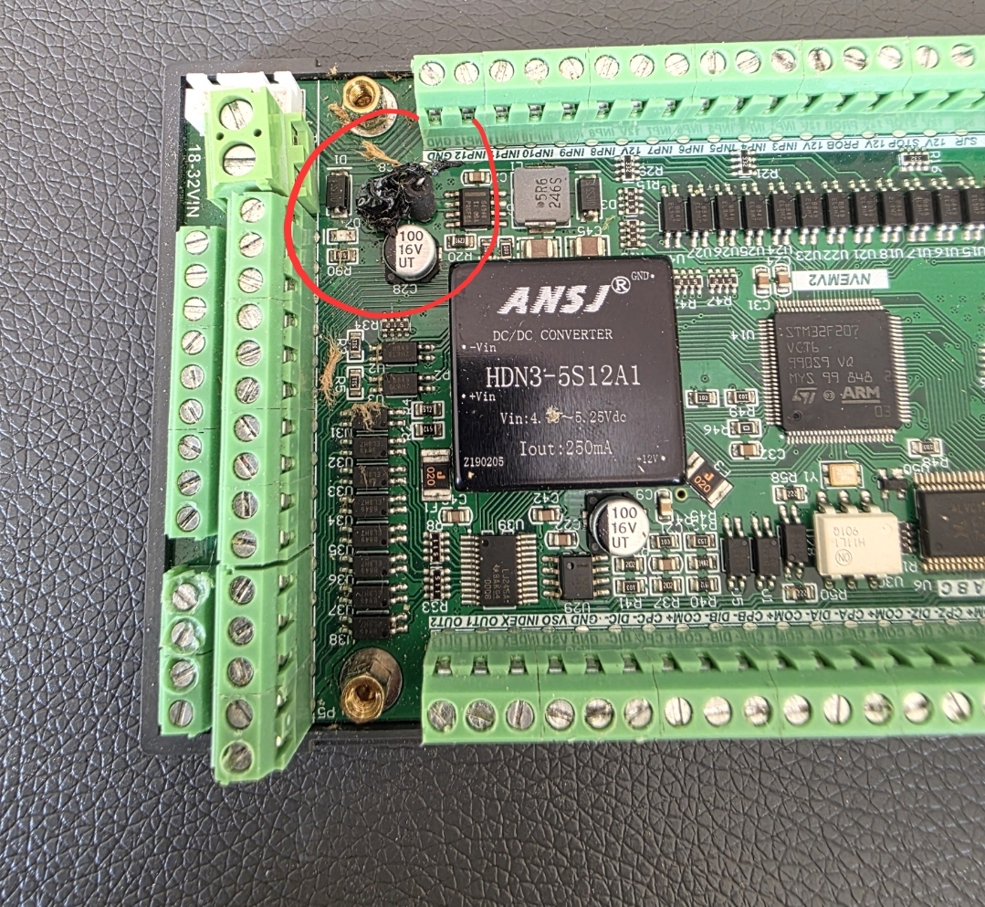

Hi Guys,
as easter project, i tried to put 32v von my nvem v2... damn it ...a capacitor blew up
can someone please give the values of it?
i can not read it anymore.
thanks in advance
best wishes
thanks in advance
best wishes

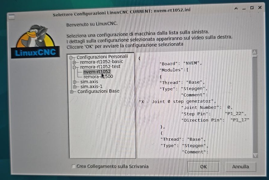

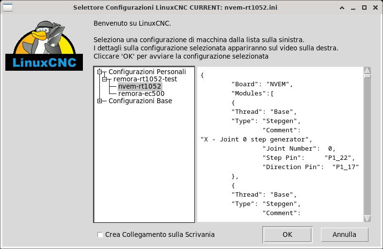

pair the contents in this dir:
github.com/scottalford75/Remora-RT1052-c.../remora-rt1052-basic
download this: github.com/scottalford75/Remora-RT1052-c...xCNC/nvem-rt1052.txtpair your files:nvem-rt1052.hal,nvem-rt1052.ini
then:
and try again please
Replied by DarkPhoinix on topic Remora - ethernet NVEM / EC300 / EC500 cnc board

23 Apr 2025 06:48 - 23 Apr 2025 06:51 #326935
by jjdege
Replied by jjdege on topic Remora - ethernet NVEM / EC300 / EC500 cnc board
Last edit: 23 Apr 2025 06:51 by jjdege.

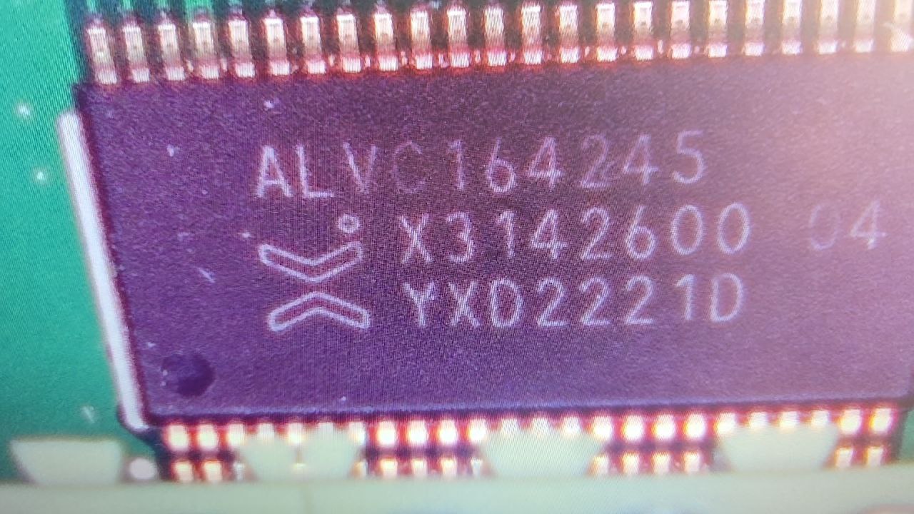

can you desoldering and test this? or replacing it shouldn't cost too much.
www.ti.com/lit/ds/symlink/sn74alvc164245...2Fwww.mouser.kr%252FThank you

23 Apr 2025 10:21 #326947
by jjdege
I have the first unusable board with two of those chips, I'll see what I can do, I've never unsoldered/soldered chips like that.
thanks
I guess the culprit is that chip, I already tried to redo the soldering, but it was no use.
