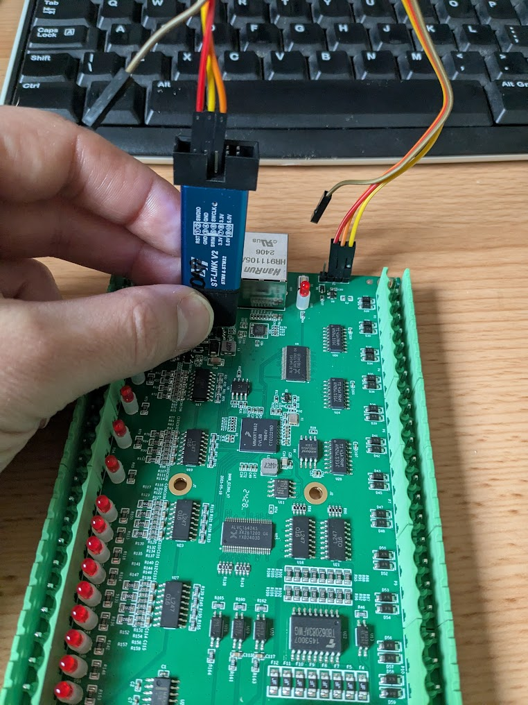

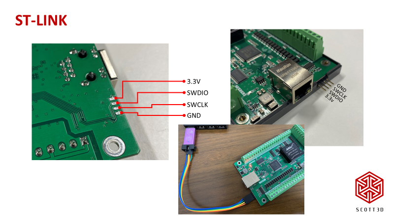

29 Apr 2025 15:43 #327301 by Spyderbreath
Replied by Spyderbreath on topic Remora - ethernet NVEM / EC300 / EC500 cnc board
Thank you for the reply Daz, and the offer to help
I now have what appears to be a successfully flashed and converted ST to DAP-link.
Now I am at the point where I need to hook this newly converted DAP-link to the NVEM controller. Is there a wiring schematic somewhere or something that tells me which pads on the controller get which wires? The pads are not labeled on the controller.

29 Apr 2025 20:26 #327313 by Daz
Here are the photos of how to connect to the board. Please note that the microcontroller gets the 3.3v from the board thus you need to power up the board with 24v when uploading the firmware
29 Apr 2025 23:39 - 29 Apr 2025 23:43 #327320 by Spyderbreath
Thanks for the pics, that is just what I needed to know.
At this point you had said to follow the instructions above, but those look to be for the EC300. Are they all the same files or are there different ones for the NVEM?
