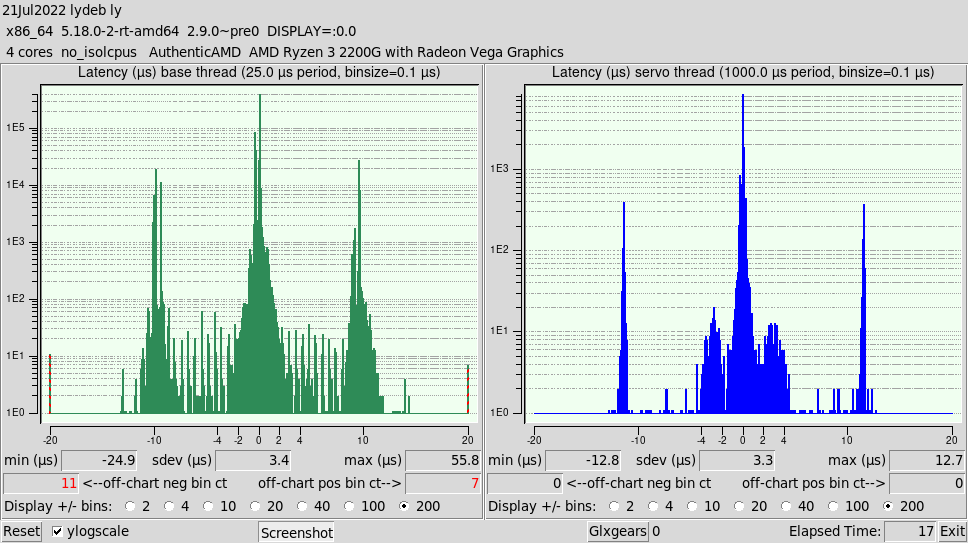

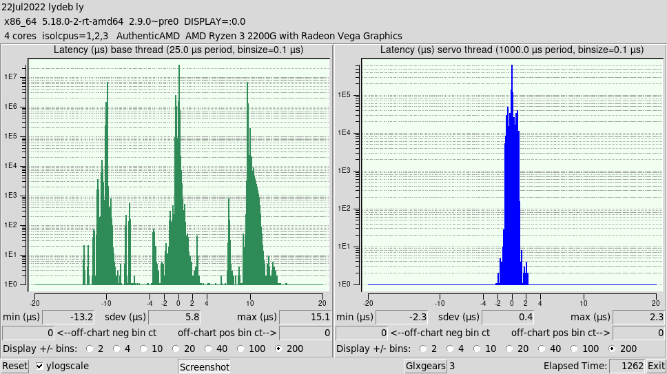

21 Jul 2022 17:43 - 22 Jul 2022 00:49 #247993
by Bari
Just for comparison. No BIOS tweaks on Sid.
ASUS TUF B450M-PLUS Gaming MB
We have a newer RT kernel and with the BIOS settings and isolcpus the same hardware is at 33uS worst case on the base thread. Will post a pic later.
Same ASUS TUF B450M-PLUS Gaming MB with same kernel as above but with isolcpus=1,2,3
Replied by Bari on topic Current Motherboards
Last edit: 22 Jul 2022 00:49 by Bari. Reason: MB part number and more info

21 Jul 2022 18:59 #247996
by Bari
The following user(s) said Thank You: JT

22 Jul 2022 09:48 #248039
by Bari
Yes, I have installed from Deb11 and then changed the sources to unstable.
The big difference in the latency numbers for the Ryzen system above is with and without the use of isolcpus. Using isolcpus reduced jitter by 3-4x.
