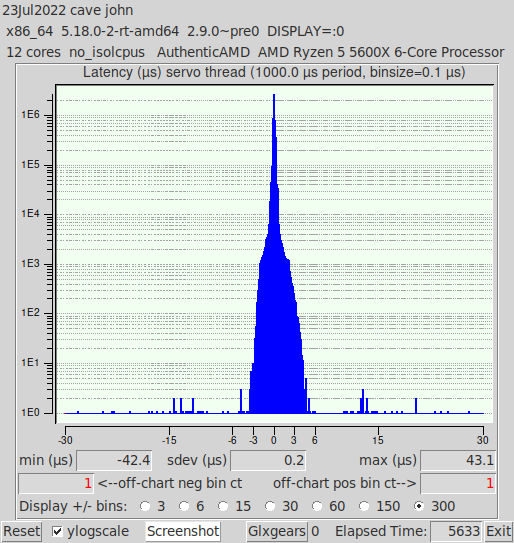

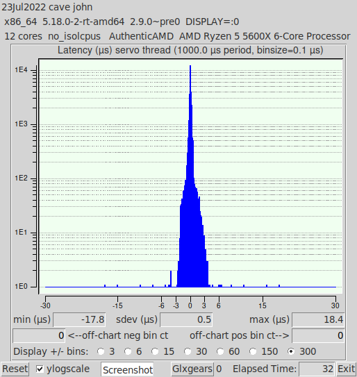

I changed to Sid and the kernel now recognizes the video card and monitor.
I just started the latency-histogram --nobase --show --sbins 300
JT

23 Jul 2022 07:06 #248113 by tommylight
Replied by tommylight on topic Current Motherboards
Much better.

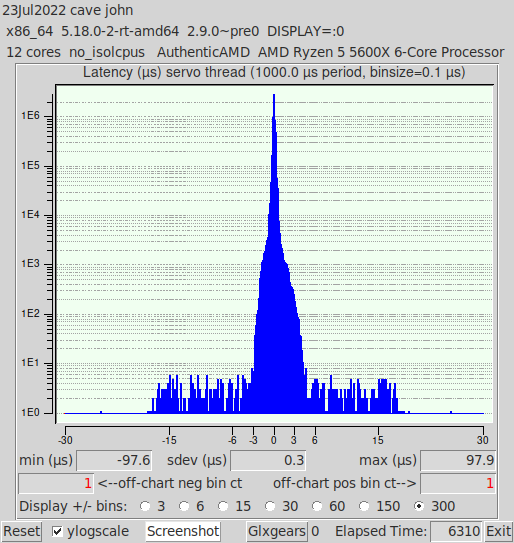

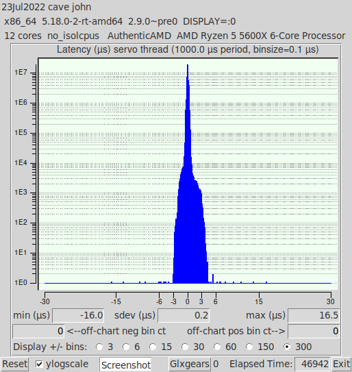

So after a couple of hours the latency test still shows good, I've not touched anything in the BIOS.

I went to the BIOS and did
F7 Advanced Mode
Ai Tweaker
ASUS Performance Enhancement = Enabled
That cut the latency in half.

If you go into BIOS and disable SVM (virtual machines) and CPU Performance Boost and all the C states in power management, it will drop even further.
Using isolcpus should also drop your base thread to lower latency than what you are getting now on the servo thread.

Edit: SVM was off and I found a couple of things that was mentioned on the IRC and turned them off and now latency is <4us.

24 Jul 2022 05:37 #248161 by tommylight
Last screenshot is very good, two before are not, they have excursions out of vissible area and that might or might not cause issues with Mesa boards.
