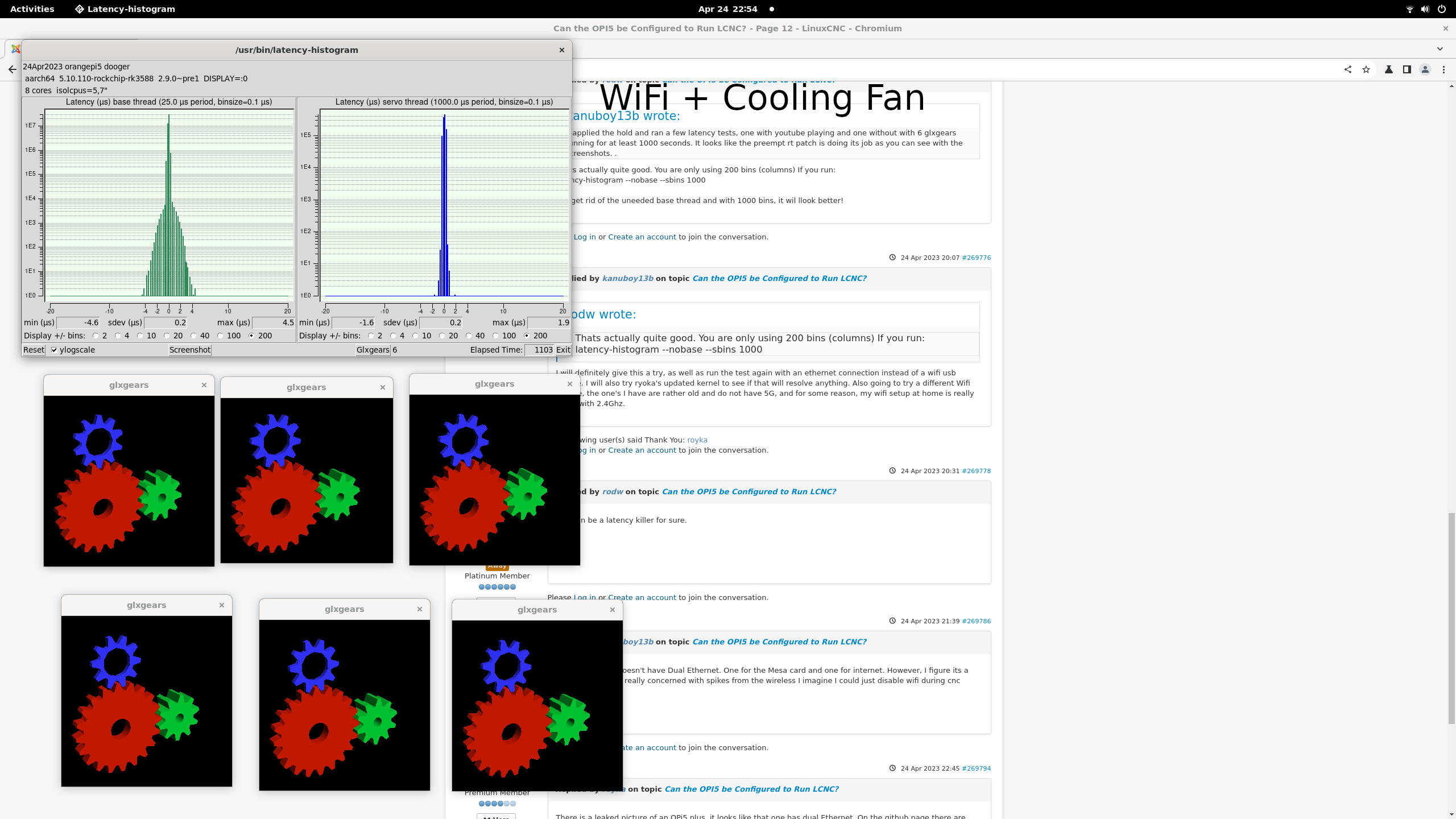

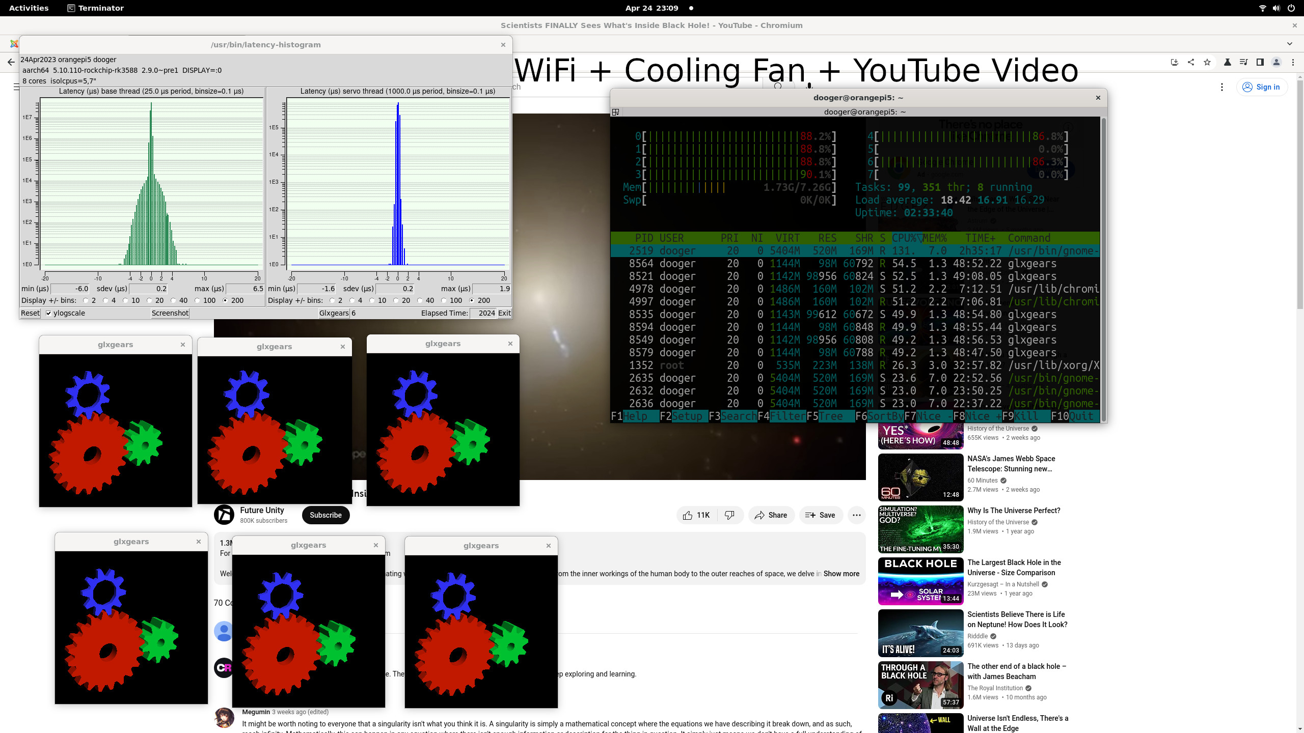

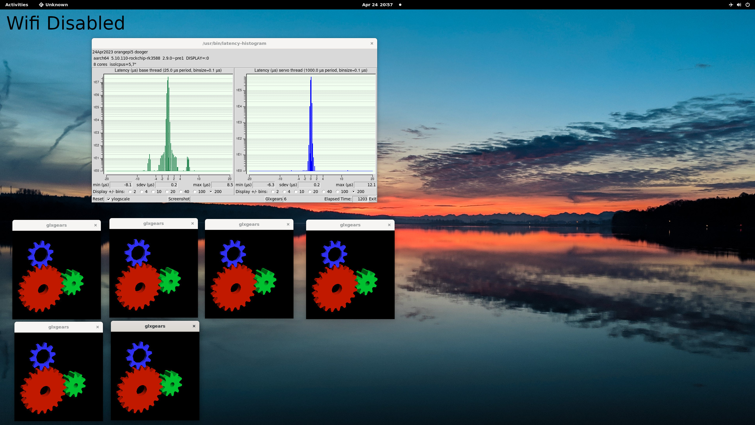

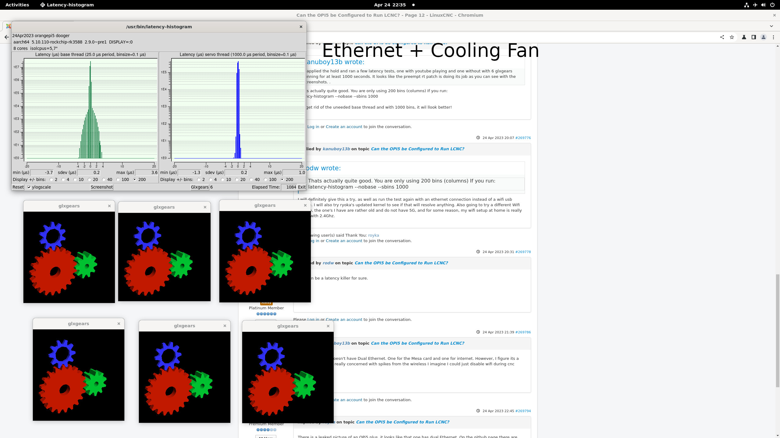

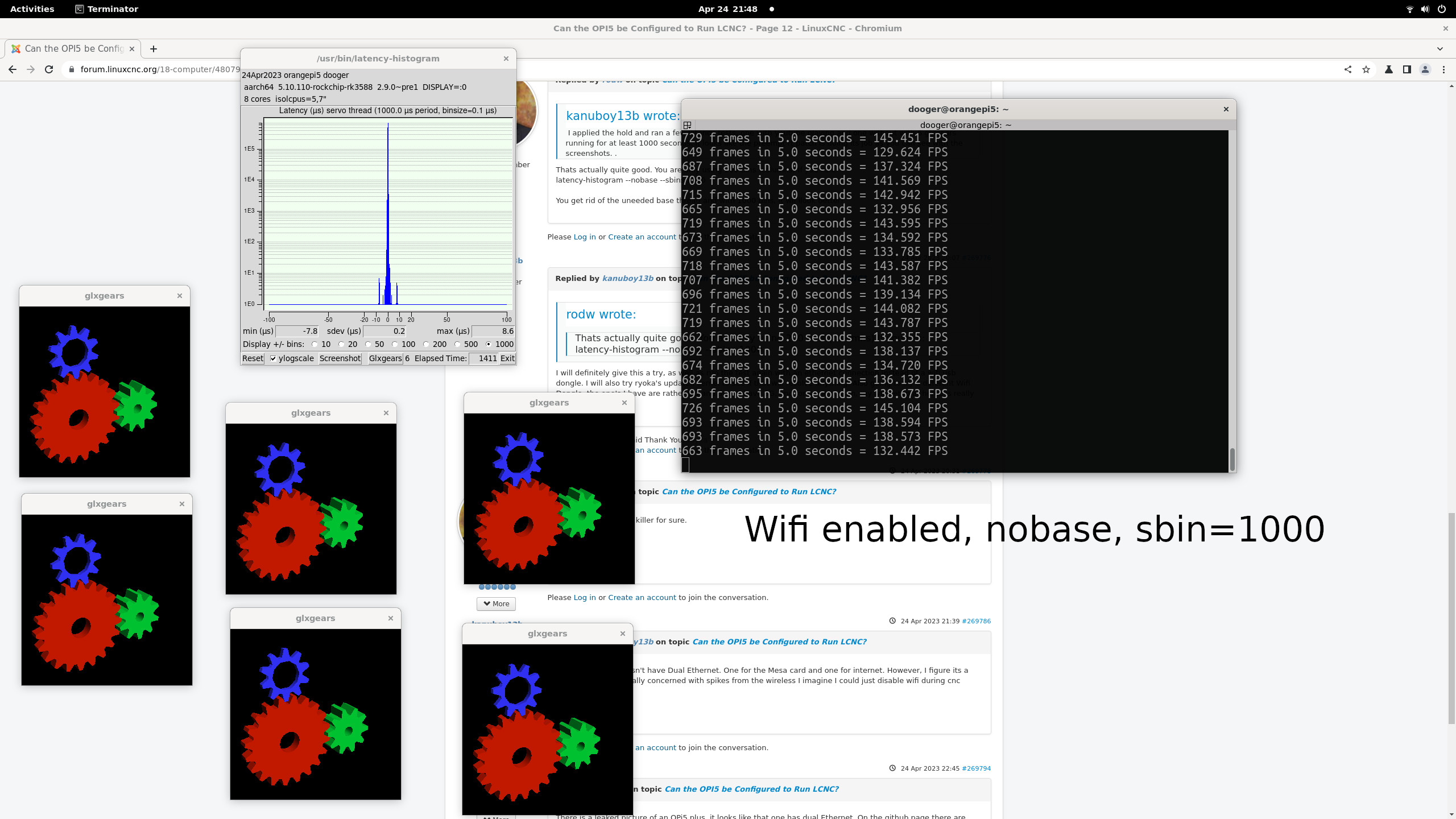

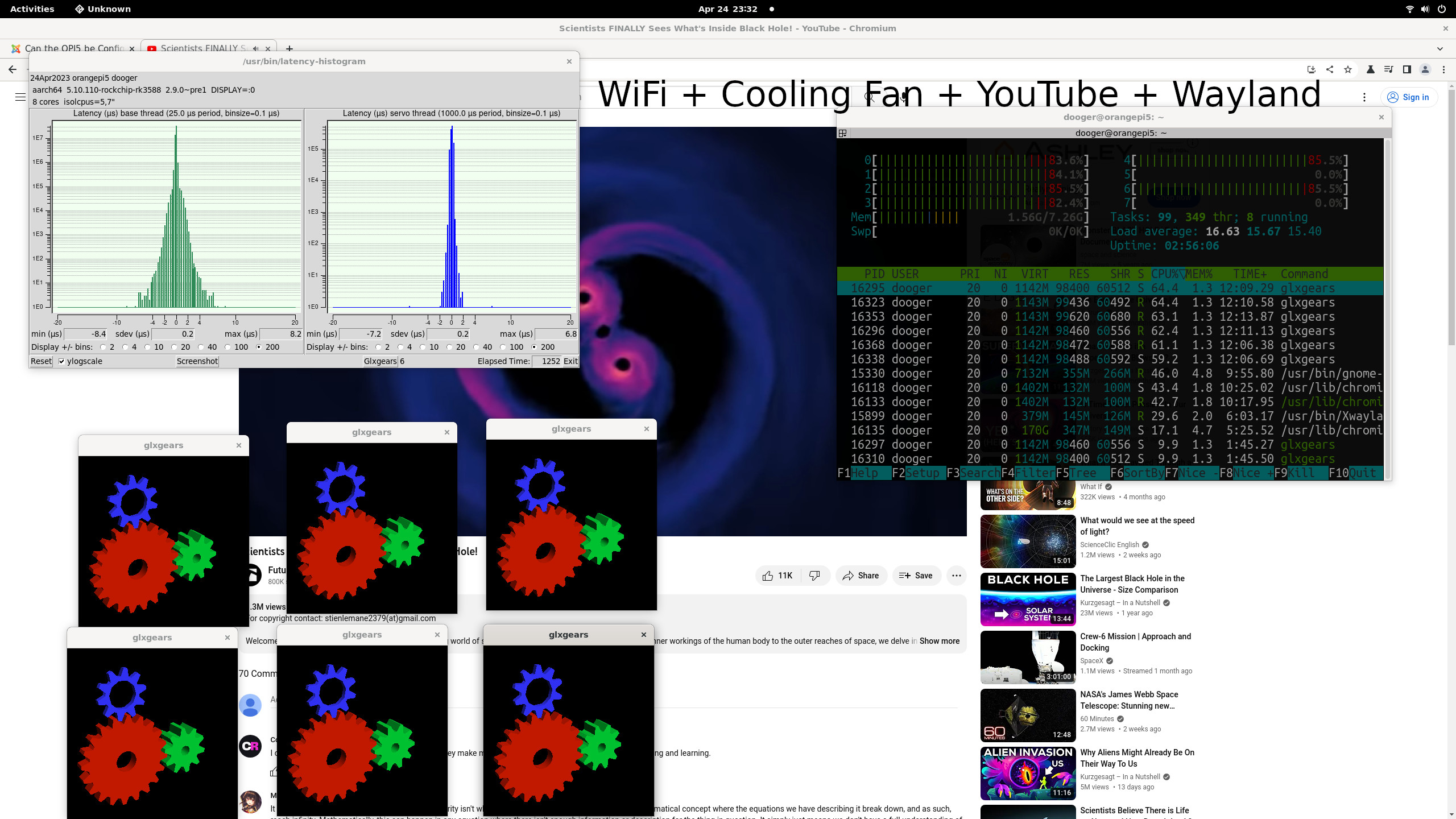

So I ran a few more Latency Tests this evening, to see how much of an impact Wifi has or other factors. Nothing really scientifically controlled. But interesting observations. I have included the results of each test. Every test was ran for at least 1000 seconds
Test 1: was disabling WiFi while running the latency histogram. So no internet connectivity at all.
Test 2: enabled WiFi, Loaded a static web page in Chromium.
Test 3: same as test too but ran command line args --nobase --sbins 1000
Test 4: Wifi Disabled, Ethernet internet connectivity. I noticed the OPi5 was a little warm so I setup a 60mm CPU fan and ran direct air on the board.
Test5: Intrigued by the Low Latency numbers, I re-ran the WiFi test with the Fan. Surprisingly I got some low numbers on WiFi as well.
Test6: Let Test 5 Continue but played a youtube video in the background. It was at this point I realized I wasn't logged in using Wayland.
Test7: Same as Test 6 but logged in to Gnome with Wayland.
WiFi definitely does seem to effect Latency, but I am curious if the Cooling fan was helping. It was definitely helping the board stay cooler. Without it the hdmi cable connection was warm to the touch, running the fan, it fell to ambient temps, so I imagine the SOC was benefiting as well.
Anyrate. I plan on running some more with Royka's updated Kernel. I wanted to run these ones first before installing the new kernel to see if there was a noticeable difference.

Heat can definitely affect things. I was getting error finishing reads on one pretty solid fanless PC on 40 deg C days.
Those numbers are crazy good!

Interesting results! Didn't expect the cooling fan would solve the latency "problems" with WiFi.
To be honest I don't expect the updated drivers will improve the latency in this case. It might make it even a little bit worse but the graphics should improve. With these numbers there is plenty of room for that.

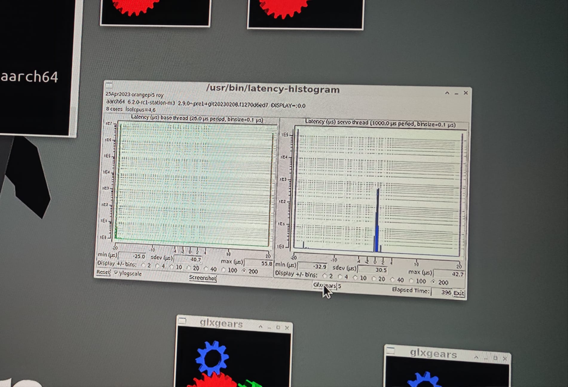

Great your WiFi does work now, I've no idea if that will be better than a USB dongle, one way to find out. His latest screenshots shows some more than good enough numbers, especially with cooling.
Did some tests with linux 6.2 kernel (non rt), the latency went quick over 2000us. After playing with the irq affinity and taskset the latency was actually pretty good for a non rt kernel and 4 glxgears open.
Moved all irqs to cpus 0-3 (0F) and moved the rtapi pid to cpu 4,6. "taskset -pac 4,6 pidnumber"
Then I thought to open a few other glxgears and the kernel locked up, so not very stable yet. To be continued

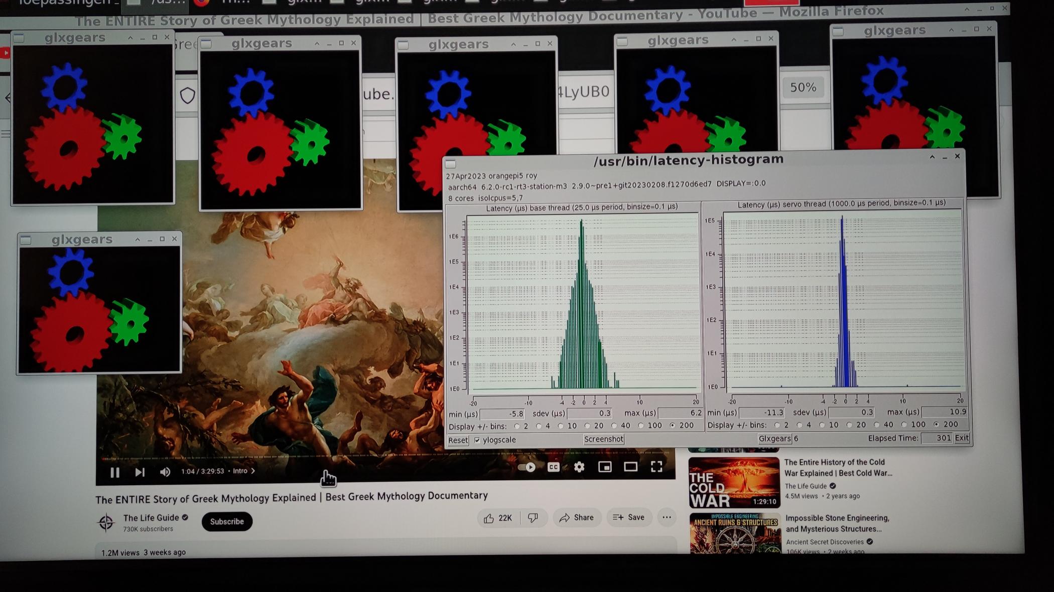

Linux 6.2 does actually perform better than I thought but no audio and graphics not as good as with the legacy kernel yet and few other things do not work. First I'd tried the mainline kernel with some patches from balbes150 and the rt patch, it booted up but no display.
Then tried the so called midstream with rt patch and to my surprise that did work, after some adjustments in the kernel config (nearly the same as the config for linux 5.10.110) and copied over some boot args, the latency is almost as good. Screenshots doesn't work so had to take a picture again.
github.com/150balbes/build
