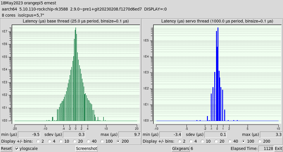

19 May 2023 00:57 - 19 May 2023 01:24 #271639 by echristley
Replied by echristley on topic Can the OPI5 be Configured to Run LCNC?
Tonight, I visited a buddy. We're both "techno hoarders". Neither of us want to throw away something that might be useful in the future. He got a Enco tapping jig, that I got with the mill. I got two FRP electronics enclosures, relays, cables, connectors, bus bars, fuse holders, and a few other odds and ends. None of that stuff seems expensive, until you have to outfit a build with it all.
When I got home, following the LinuxCNC install directions posted in the OP, I installed the Arbiam OS on the OPi5. I had to download and install Belena Etcher, a program for writing the images to SD cards. The RaspberryPi writer wouldn't work. Said the image was corrupted. Anyway, on the other computer right now, I'm watching a This Old Tony video, the one where he tries to replace the ball bearings in a ball nut. He's such a hoot. In the background, I have the linuxcnc latency test running and have 20,312 in the servo thread and 7,375 in the base thread.
I haven't figured out how to post a picture to this forum, but with six glxgears running, and browsing this forum with Firefox ESR This is with nothing more that royka's image, and the installation of linuxcnc-uspace.  Is wayland really needed?
Last edit: 19 May 2023 01:24 by echristley.
19 May 2023 13:32 - 19 May 2023 13:33 #271672 by echristley
I changed the isolcpus to 2,5,7 and got essentially the same results. After the screenshot, I got a few outliers out to +-12us when I loaded some videos and browsers and stuff. That is about what I'm getting this morning with the updated settings.
Looking at what people are reporting from other computers, I think I can call this good enough for now and move on to the next steps? Linking the GPIO pins to the BOB and getting them configured to drive steppers?  I think for that I need the dtb prepared by Guglielmi (I think)?
