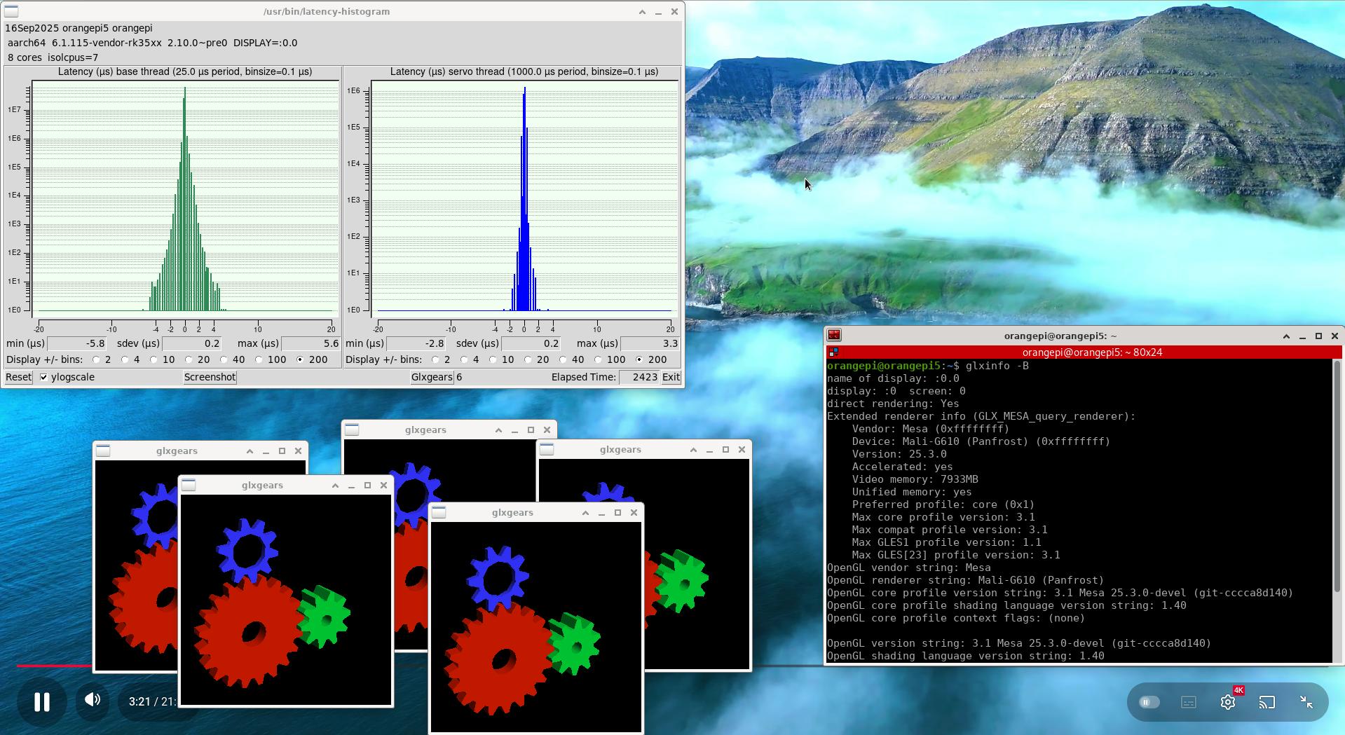

I installed Trixie with Cinnamon and 3D acceleration. I applied rt-kernel over the original 6.1.115 kernel and it wouldn't boot. I commented out overlays=panthor-gpu in armbianEnv and it booted. So the system has the capability to use 3d acceleration but something in rt-kernel is stopping it.
- royka
- Posts: 383
- Thank you received: 135
16 Sep 2025 20:13 - 23 Sep 2025 23:45 #335086
by royka
Replied by royka on topic Can the OPI5 be Configured to Run LCNC?
Thanks for pointing out. I was using it with the vendor blobs, but when i tried Panthor I had the same. They changed a lot with the scheduling which made it not rt-friendly anymore.
It kept me busy for a while but I think it's working correctly now. glxinfo -B shows "Device: Mali-G610 (Panfrost) (0xffffffff)" and Chromium is with acceleration and 4k without frame dropping. I'll upload the patches there
Update: mpp can give huge spikes during seeking with YouTube,so it might be better to disable hardware video decoding. Or make a symlink with hw decoding for when you don't use your CNC and one with software decoding (still nod bad).
I'll see if it's fixable.install the libv4l-rkmpp package from the Google Drive.
Btw this forum is lately very difficult to reach.
drive.google.com/drive/folders/17WBVgRBA...4GUaGlhR?usp=sharing
Last edit: 23 Sep 2025 23:45 by royka. Reason: Error fixed

- ccc774
- Posts: 24
20 Sep 2025 14:31 #335210
by ccc774
Replied by ccc774 on topic Can the OPI5 be Configured to Run LCNC?
sorry I only replied now, I was sick. I installed and tested your packages today and they work better than last time. I appreciate your help which is always of the best quality and very prompt. Thank you Royka!
