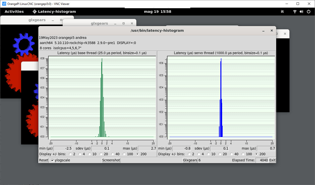

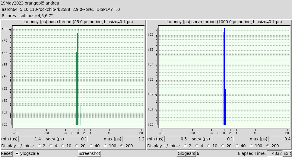

Hi, this is my latency test with wifi active:
and this without wifi:
Impressive!
To be honest I never tried to activate videos or other stuff, just 6 Glxgears because the OPI5 in my case will run only LinuxCNC..
I need a stable reference in order to understand the best setup.
Here I would exagerate isolating all bigger cores...
In order to use GPIOs I can provide the driver that it's currently working on my side but as I wrote I tested only one channel with oscilloscope.
I will not use BOB interface but I will build on my own, so I need some days more to create pcb and try with hardware.
After that I will share here.

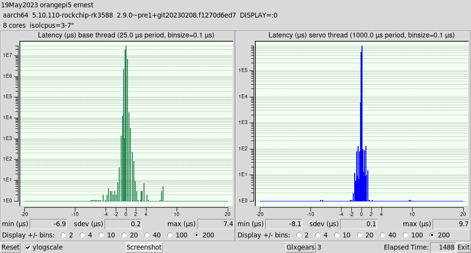

More testing.
Why do we run glxgears? It doesn't seem to make a difference at all in the latency. If I have six running, and start the histogram, I get the same result as if I have none. The big hits are when I move windows around in the UI or start a video.
Could it be that the animation just isn't a big hit on the OPi5 like it is other architectures?

install and run htop.
Run it with a latency test
It shows the CPU utilisation on each core
You should see the CPU load increase each time you add a glxgear
On another 6 core ARM, it was fine up to about 8 sessions then a core maxed out @ 100% then latency increased if you added more

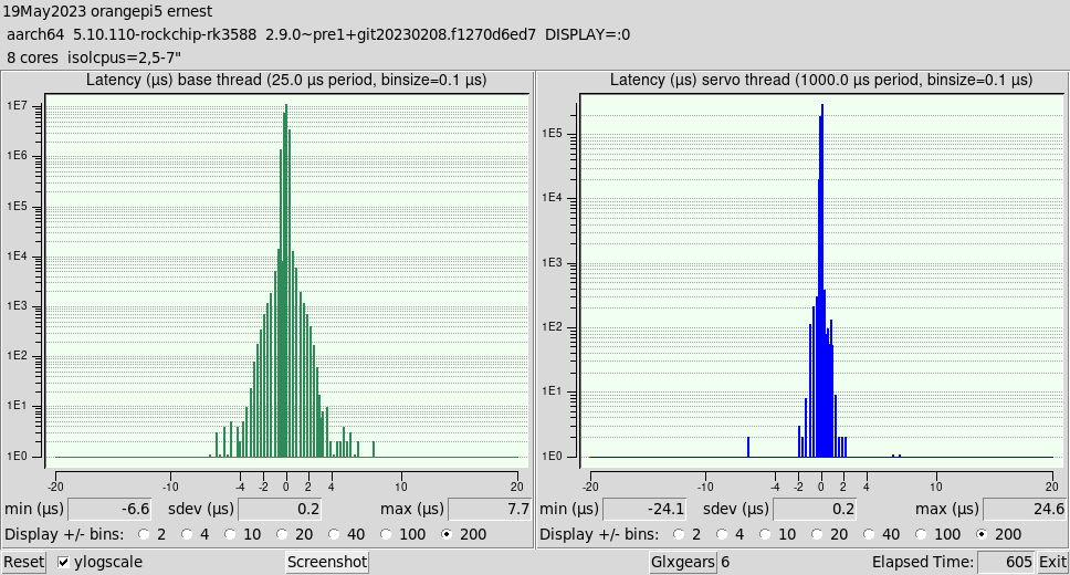

htop showing cpus 0,1,2 at 95-100% utilization. 6 glxgears. The rest at zero. Glxgears going from default to full screen and back. editing this post. video to full screen and back. the little blips out on the end of the servo thread show up when I'm restoring the tab in FF that is running the video. The UI is draggy, but picks up when I drop down to 3 glxgears.
Again, the glxgears don't seem to contribute to the latency. Starting apps does, though. I've ordered a flash drive. I'm hoping that will eliminate even the blips.
Note, this histogram had six gears running until I checked to see how many to drop to get performance back.
