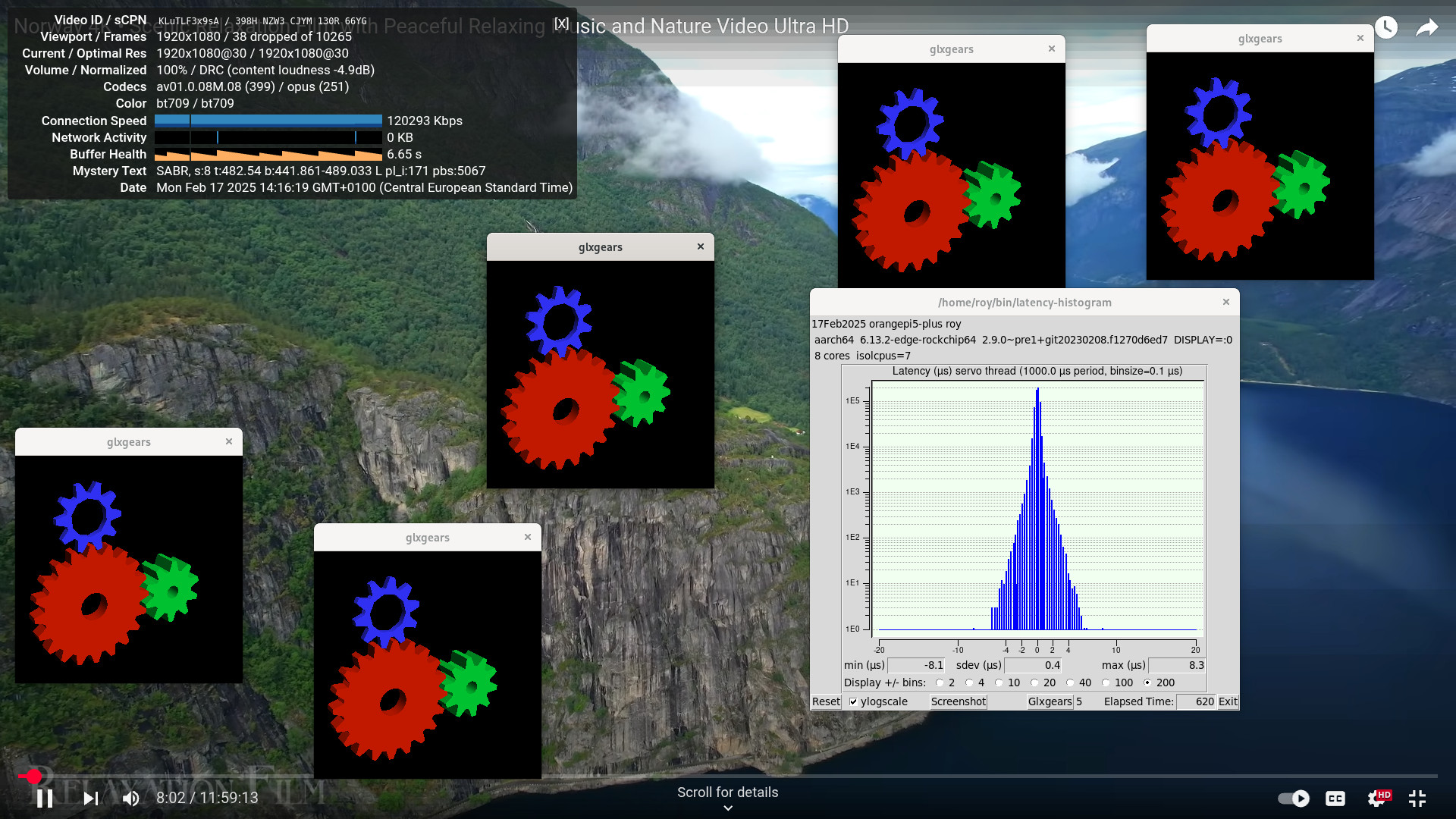

17 Feb 2025 14:08 #321835
by royka
Replied by royka on topic Can the OPI5 be Configured to Run LCNC?
Built an image with Armbian and chose "Bleeding edge" kernel with this config
, booted from sd (nvme got recognized though)
Isolated core 7 and added the following environment setting so linuxcnc 2.9 will work with RT priority (not needed with a recent 2.10 build):
echo 'LINUXCNC_FORCE_REALTIME=1' | sudo tee /etc/environment
First tried with cinnamon (X11) it works but it isn't smooth, you can see the cursor flickering sometimes.
After that tried Gnome on Wayland, this works smooth.
HDMI audio doesn't work yet with 6.13, but the patches are sent so possibly it will work from 6.14
gitlab.collabora.com/hardware-enablement...n/mainline-status.md
Somehow when I run latency-histogram with base thread, the latency of the servo thread goes over 100us. Without the base thread it stays below 10us, so with Mesa it'll work perfectly fine.
It works fine, but I'll self stay with the vendor kernel 6.1.75 for now because it still works great for months without any problems.

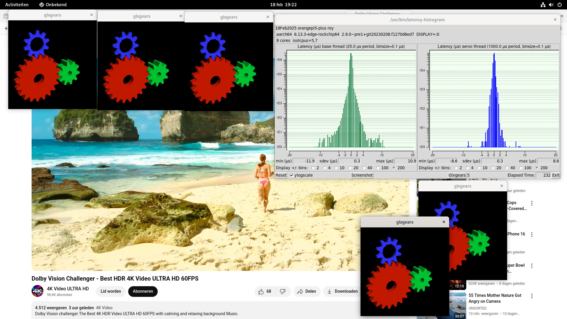

18 Feb 2025 18:14 - 18 Feb 2025 22:21 #321927
by royka
For the rockpro 64 the first 2 cores (0,1) are the faster ones. To move the RT processes to cpu1, you can run this script as root (rename to prio.sh)
This was the rt kernel I made for the rk3399 back then:
drive.google.com/drive/folders/12VfNmKC3...zaNAk2EN5sHDfeCnnzYX
Maybe you've more luck with using the script (don't forget to hit the reset button in latency-histogram after running the script.)
With the Orange Pi 5 plus, when I split the processes to core 5 and 7 with the script above the latency with base thread is better with Linux 6.13
