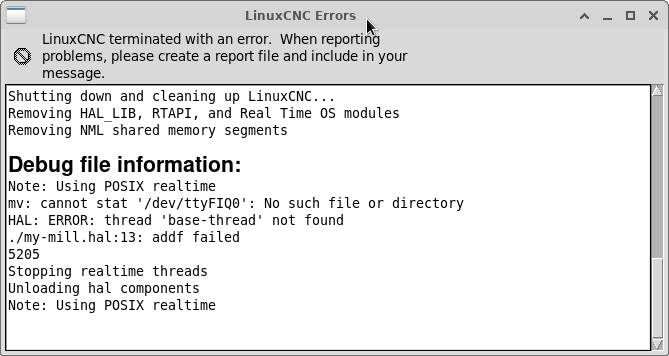

Now I'm getting this error:
Thread 'base-thread' not found.
does it mean something wrong with my hal_op5_io?

Here's my hal and ini file.
The whole error is attached too.

Your hal file in missing the lines that load the base & servo thread. And few other bits & pieces.
At the start of your hal file you'll need something like this
And you need to sort out the issue withThis could be the file not existing or you don't have the correct permissions to access the file. Unfortunately as the whole error log isn't there, just a screenshot or a small part, I can't comment any further.
# first load all the RT modules that will be needed
# kinematics
loadrt [KINS]KINEMATICS
# motion controller, get name and thread periods from INI file
loadrt [EMCMOT]EMCMOT base_period_nsec=[EMCMOT]BASE_PERIOD servo_period_nsec=[EMCMOT]SERVO_PERIOD num_joints=[KINS]JOINTSAnd you need to sort out the issue with
mv: cannot stat 'dev/ttyFIQ0'
The following user(s) said Thank You: Hossein74Majidi

Yes Thanks a lot. That was the problem
and also after correcting that, "mv: cannot stat 'dev/ttyFIQ0'" doesn't show up anymore too.
