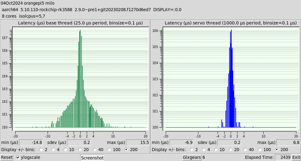

Hi, guys!
It seems that using a GPU improves latency on this board.
Without:
With:
Good thread:
Without:
With:

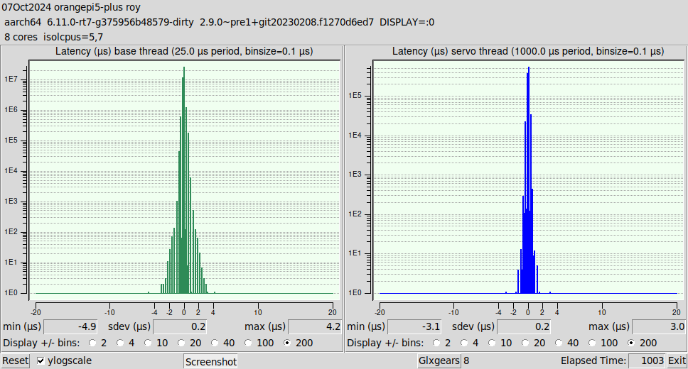

6.11 also seems to give good results, rt patched the source from:
github.com/Joshua-Riek/linux-rockchip/tree/oracular
Audio doesn't work here and perhaps some other features are missing, for those who would still like to try:
Kernel deb package and config:
drive.google.com/drive/folders/1JglCIPKv...cjOvr?usp=drive_link
An easy way to install with gpu acceleration is to install the image 6.10.6 with backported mesa from:
mirror.vinehost.net/armbian/dl/orangepi5/archive/
or
mirror.vinehost.net/armbian/dl/orangepi5-plus/archive/
Install the kernel with: sudo apt install ./linux*.deb
Then copy the dtb files: sudo cp /usr/lib/linux-image-6.11.0-rt7-g375956b48579-dirty/rockchip/* /boot/dtb/rockchip/
And link the Image file to the rt-kernel: cd boot; sudo ln -sf vmlinuz-6.11.0-rt7-g375956b48579-dirty Image

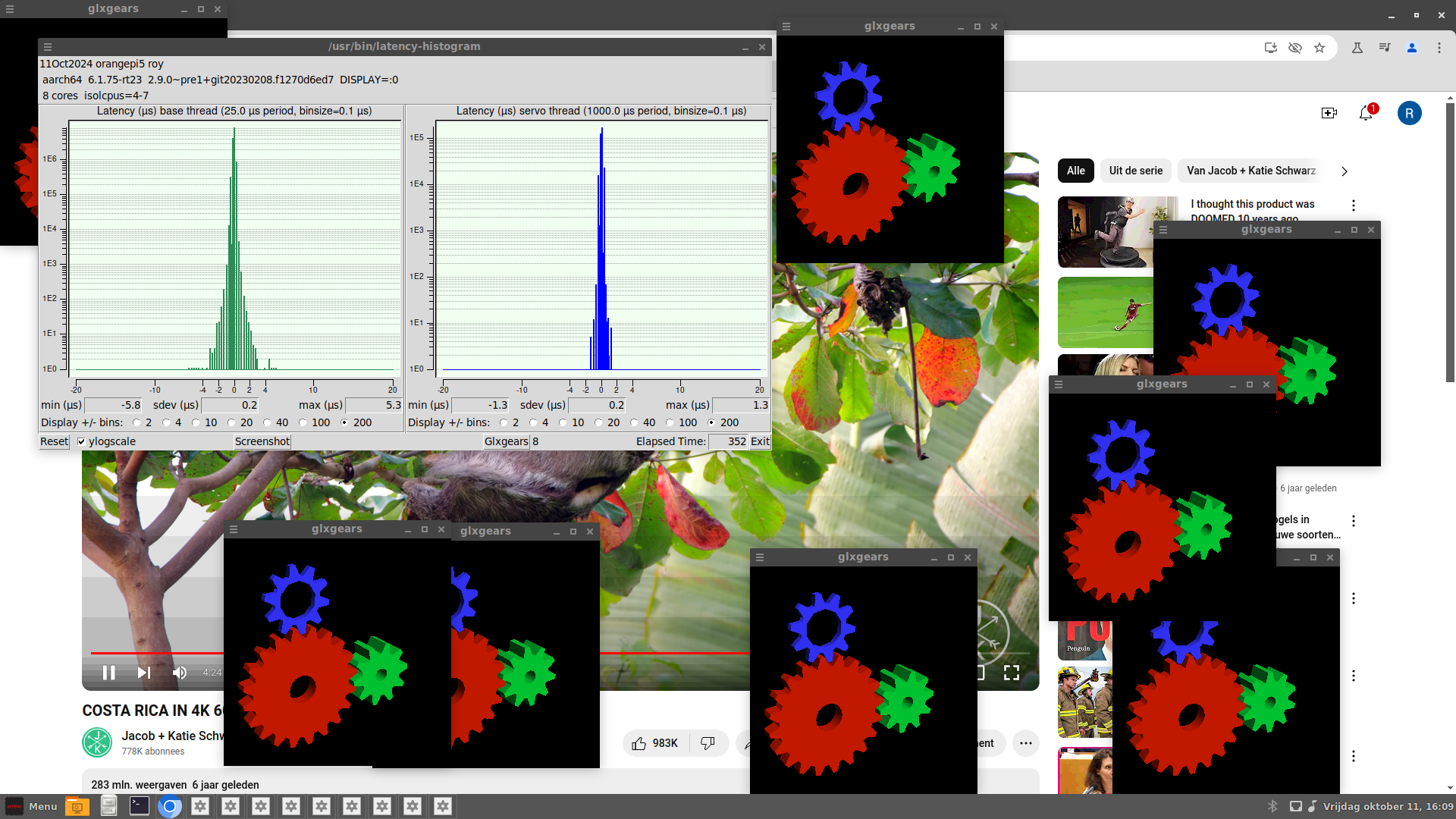

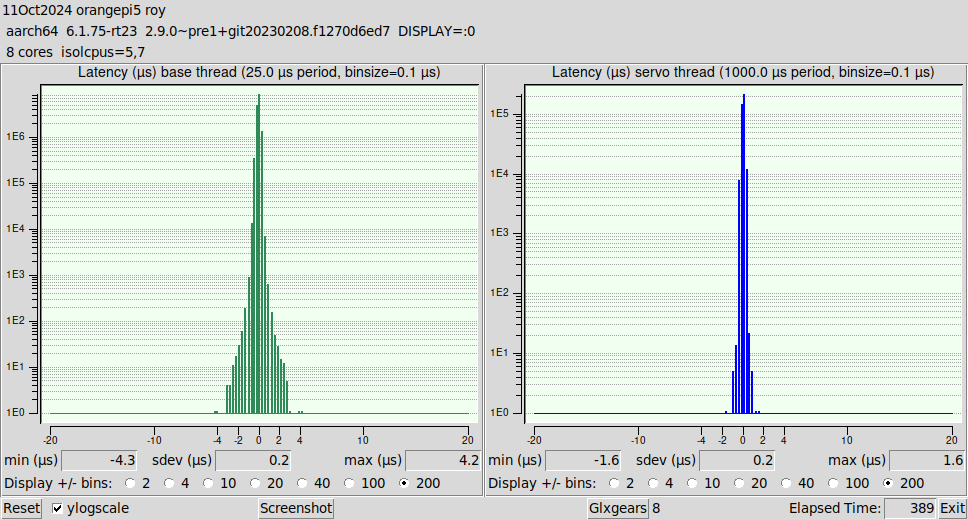

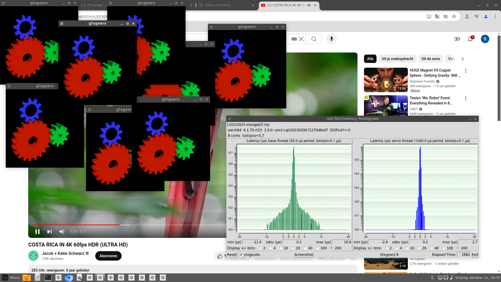

Also tested the 6.1.75 vendor kernel (with panthor driver), only after loading chromium and watching videos on youtube the latency raised a bit as you can see, but still very acceptable. Isolating all the fast cores improved that, but for me it's not worth it as it becomes noticeable slower.
For the rt-patch only a few had to be done manually for the serial 8250 driver because of some vendor edits.
Kernel/config
An easy way to install with gpu acceleration is to install the kernel on the image 6.1.75 with backported mesa from:
or
And link the Image file to the rt-kernel: cd boot; sudo ln -sf vmlinuz-6.1.75-rt23 Image
