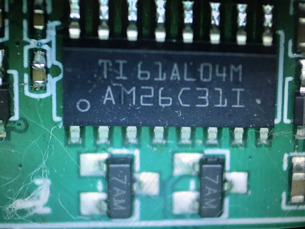

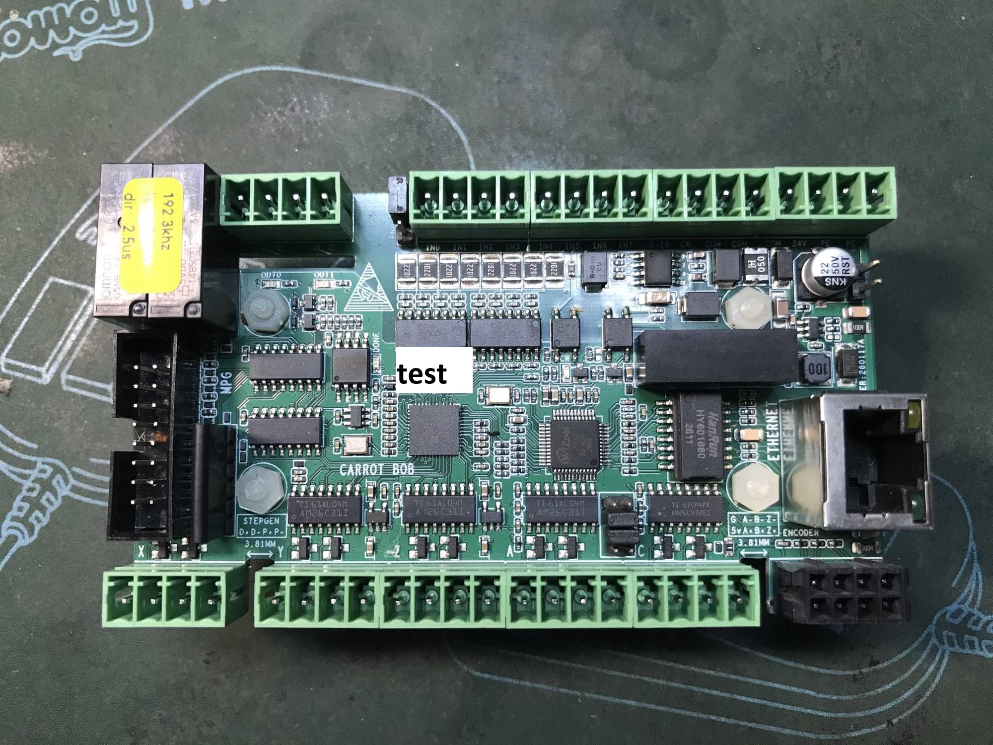

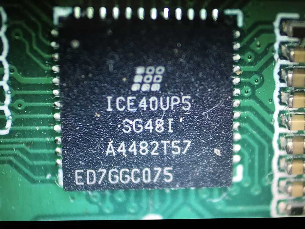

I have a Riocore + ICEBreakerV1.0e + 26LS31 (pulse, dir) control board. I tested connecting it to an unmodified DM542 (dir / pc817), but it still cannot return to the zero position correctly.There shouldn't be any problem connecting this board to the motor driver using the 26C31 differential output. Adjusting the dirhold value had no effect. I suspect it might be caused by a deviation in the dir/step during the forward and reverse rotation of the riocore.
ICEBreakerV1.0e board
26C31 Differential Output Driver
FPGA
FPGA

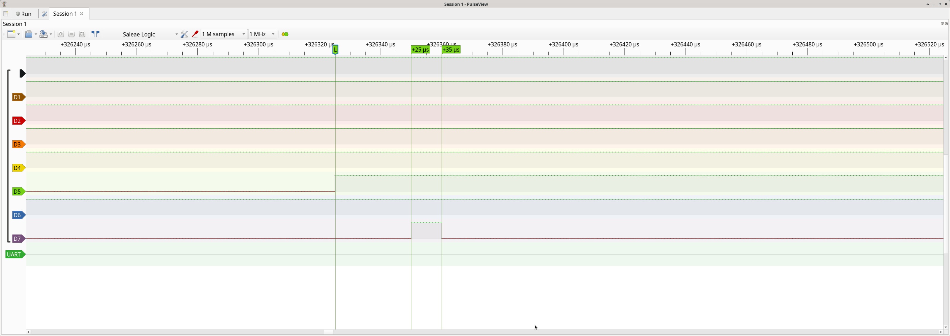

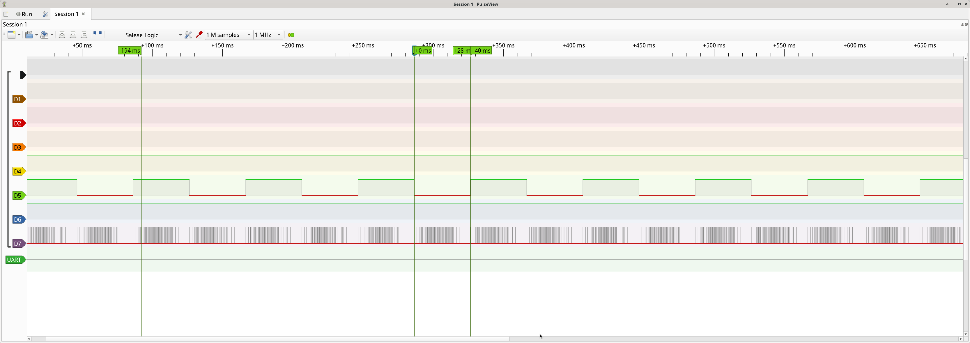

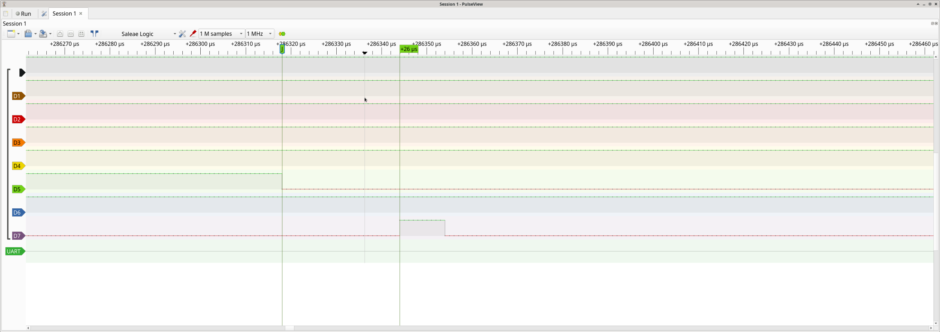

- meister
- Posts: 805
- Thank you received: 502
14 Aug 2026 14:27 #348742
by meister
Replied by meister on topic LinuxCNC-RIO - RealtimeIO for LinuxCNC based on FPGA (ICE40 / ECP5)
Hey, that’s a bit mean – I want a board like that too
Yes, that really is strange, but I can’t explain it at the moment and I’d be glad if I knew the solution.
All I can do here is take some more measurements; I’ll connect it to a logic analyser again and record the pulses for a bit longer to check them.
But on that board too, please measure the voltage arriving at the driver.
That board looks really good

14 Aug 2026 14:50 #348744
by meister

- Posts: 18104
- Thank you received: 5328
14 Aug 2026 17:48 - 14 Aug 2026 18:42 #348749
Replied by PCW on topic LinuxCNC-RIO - RealtimeIO for LinuxCNC based on FPGA (ICE40 / ECP5)
If this is a drive level issue, note that a 26C31 does not swing to 5V
and its output level is about 2 diode drops below 5V (3.6V) with a 5 mA load.
