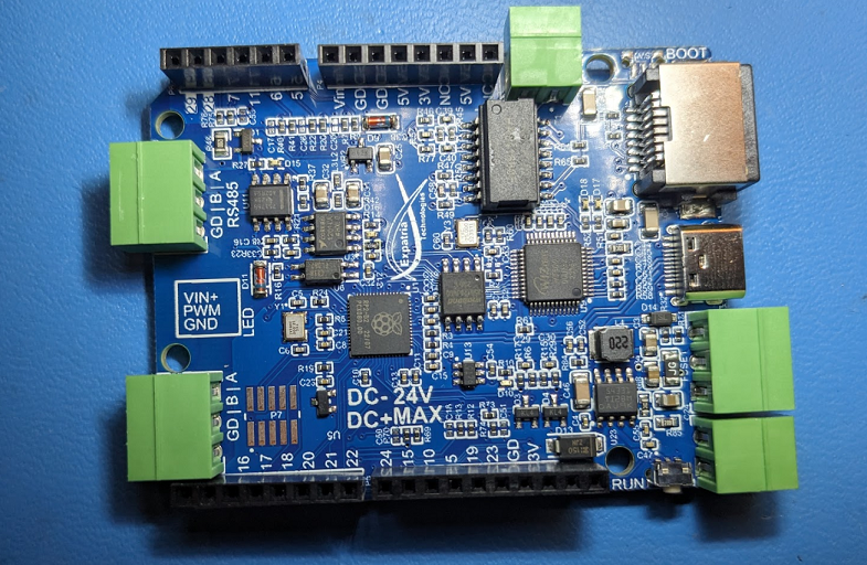

02 Feb 2024 02:01 - 02 Feb 2024 02:04 #292184
by drewnabobber
Replied by drewnabobber on topic Remora for RP2040
Just putting the finishing touches on the PicoHAL, which can be used as a Remora stepgen, amongst other things. Probably a bit easier for hacking around than PiocBOB.
