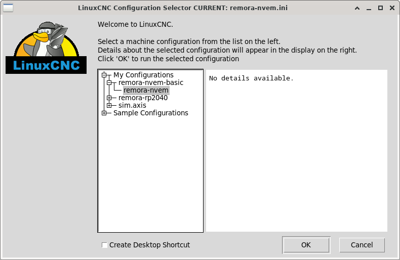

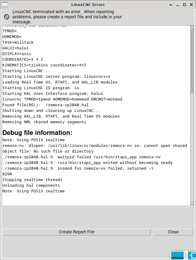

Hi, i am testing the linuxcnc hal file and remora rp2040+w5500 and have a question how add outputs in the config file for enable spindle and enable coolant?. Thanks.
"Thread": "Servo",
"Type": "Digital Pin",
"Comment": "outy",
"Pin": "GP13",
"Mode": "Output",
"Data Bit": 2,
"Invert": "False"
}probably something like this

you need to install the component
github.com/scottalford75/Remora-NVEM/tre...Components/Remora-nv
remora-docs.readthedocs.io/en/latest/sof...mp-installation.html

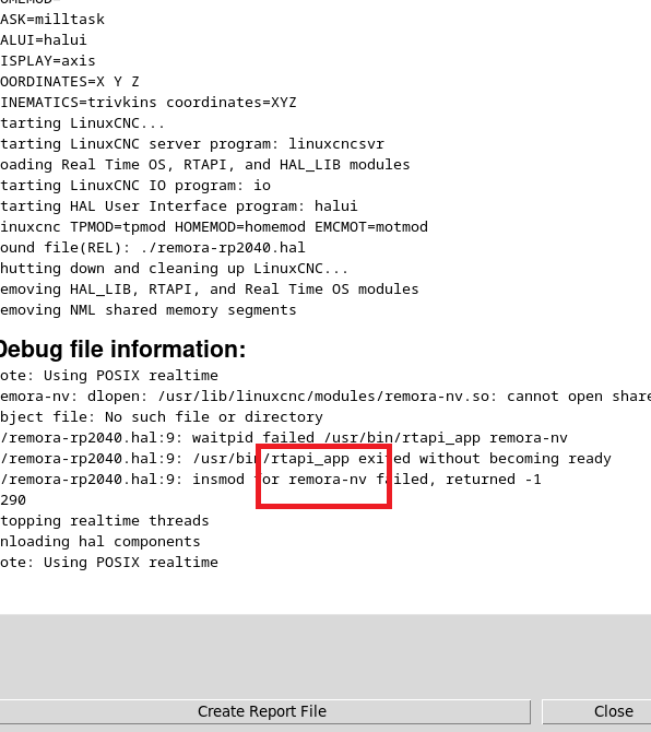

I do
(sudo halcompile --install remora-eth.c) from here github.com/scottalford75/Remora/tree/mai...omponents/Remora-eth
(cp -a ~/linuxcnc/Remora/LinuxCNC/ConfigSamples/* ~/linuxcnc/configs) from here github.com/scottalford75/Remora/tree/mai...igSamples/remora-eth

dont use the eth, it is most likely outdated. your hal file is asking for remora-nv

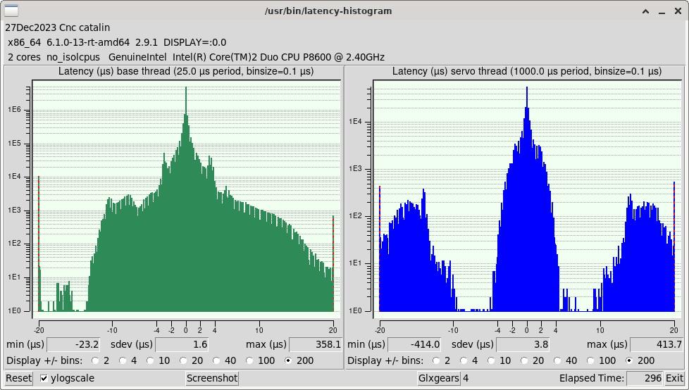

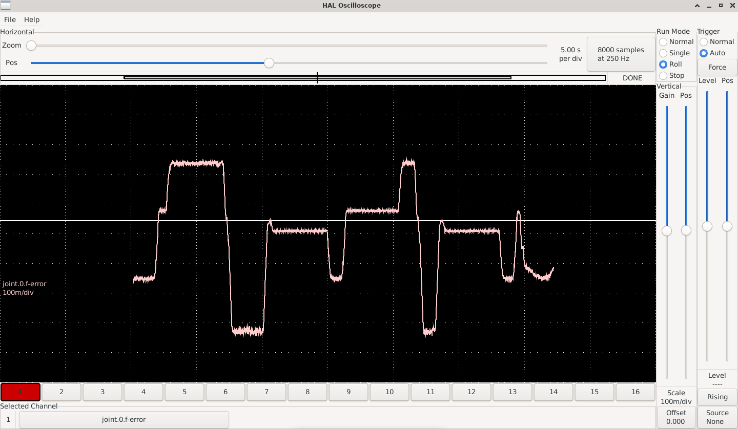

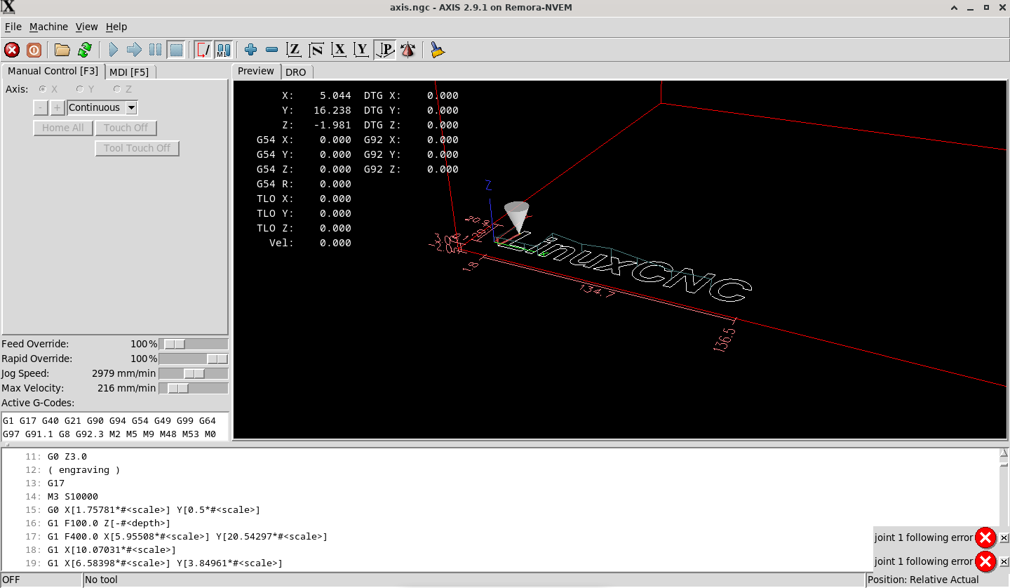

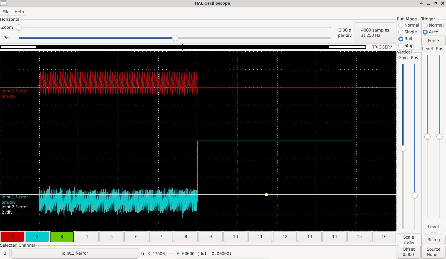

I do all settings from Expartia github link and now support velocity until 7500mm/min but some time crash with 'joint X following error', error is random not every time in same 'place' of gcode and joint nr cud be any. (0,1,2). The crash dont appear every time, for example 3 time run all code without problem and 4 th time crash 2 times.
I suspect the latency problem.
- Posts: 22001
- Thank you received: 7488
29 Dec 2023 14:45 #289313
Replied by tommylight on topic Remora for RP2040

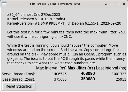

From what i can gather, it is a latency issue, the screenshots you posted are terrible but that might be due to using base period for tests.
The main issue is you still get the warning about latency excursions on the servo period when starting LinuxCNC, and that has to be addressed first.

30 Dec 2023 11:59 - 30 Dec 2023 14:01 #289372
by fklco
Replied by fklco on topic Remora for RP2040

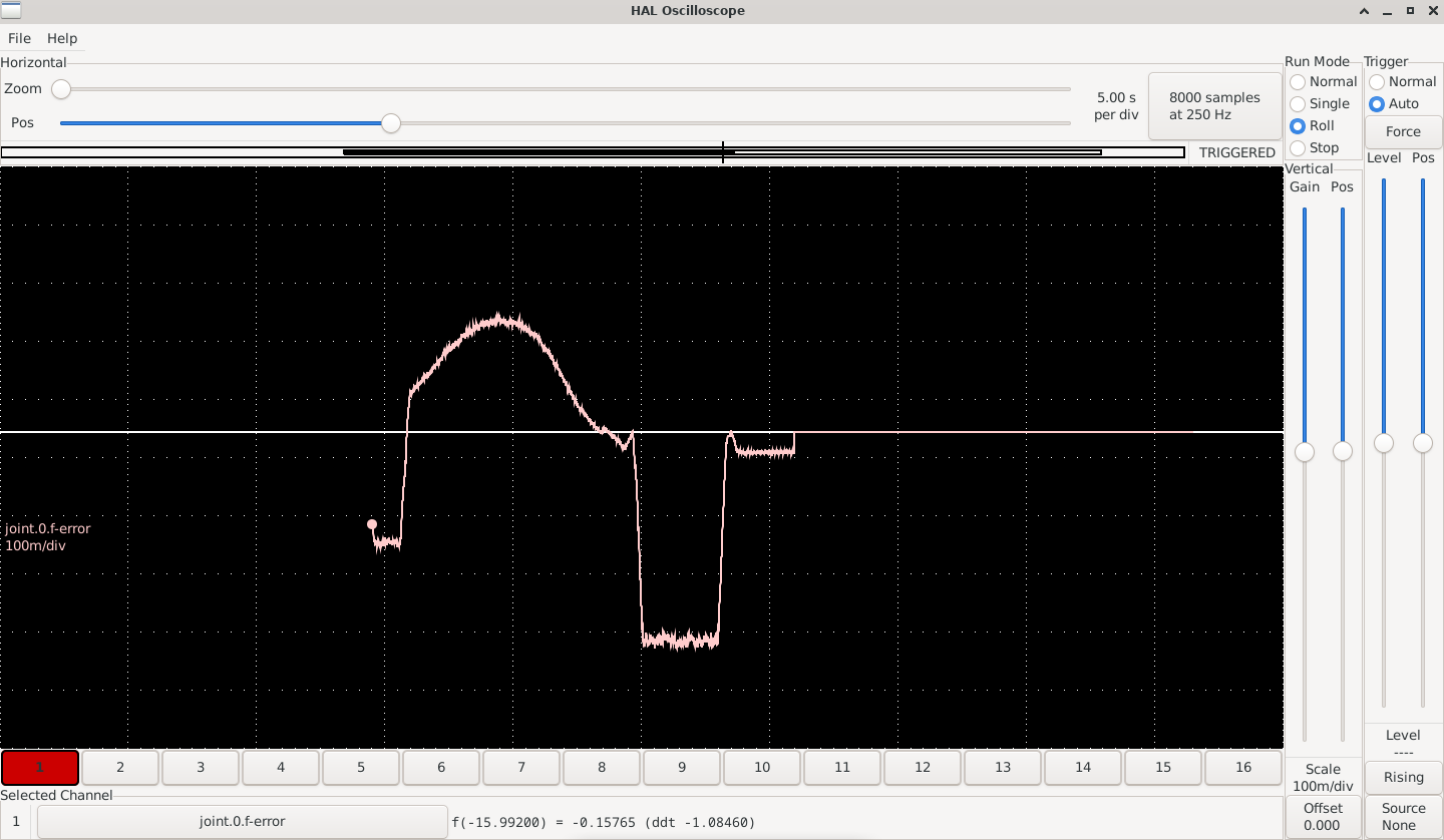

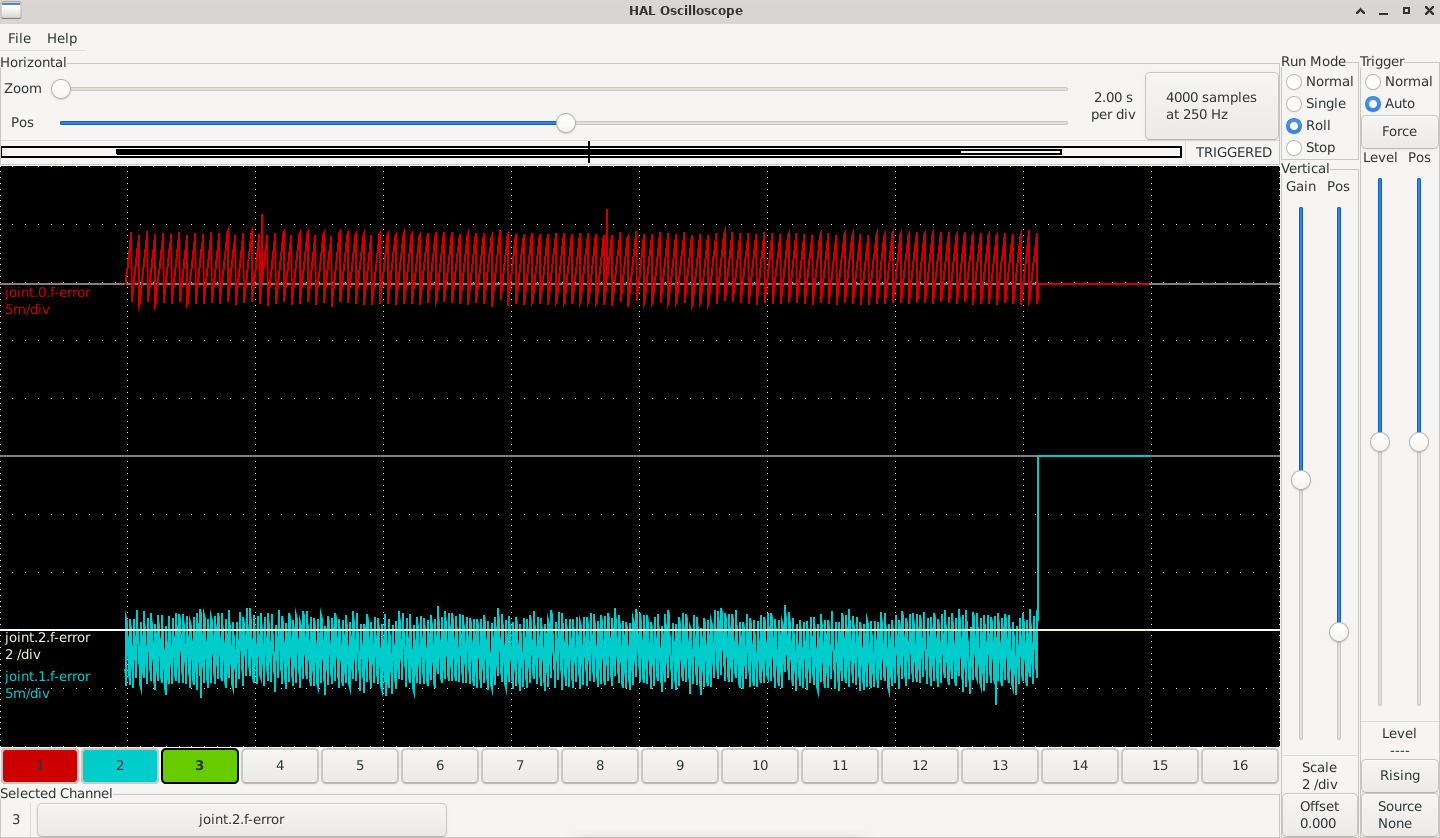

Hall scope on Joint0 fferror
When works ok. At Feed 4000 and G0 at 7500mm/min
When crash
At low speed Feed 400mm/min and G0 2000mm/min
I think is PID problem not latency.
Edit : With firmware form hire github.com/scottalford75/Remora-RP2040-W5500/tree/main/build is more stable now, but need PID adjust.
When crash
