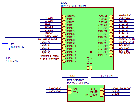

Found a whoopsie but have the W5500 pinging and connecting via websockets. Is there a particular branch of your code that I could try here Scott?

Also, just noted the uart is not on GP0 and GP1 so a custom board definition will be needed. Which pins?

28 Jun 2023 13:57 #274392
by drewnabobber
Replied by drewnabobber on topic Remora for RP2040
Just to give an update on the design. We have found that we get disconnects (lose ping) between the W5500 and the RP2040 after running for around 4-6 hours. Don't currently have access to a way to debug this in detail, but it looks so far like it might be that the IRQ line needs an additional pullup.

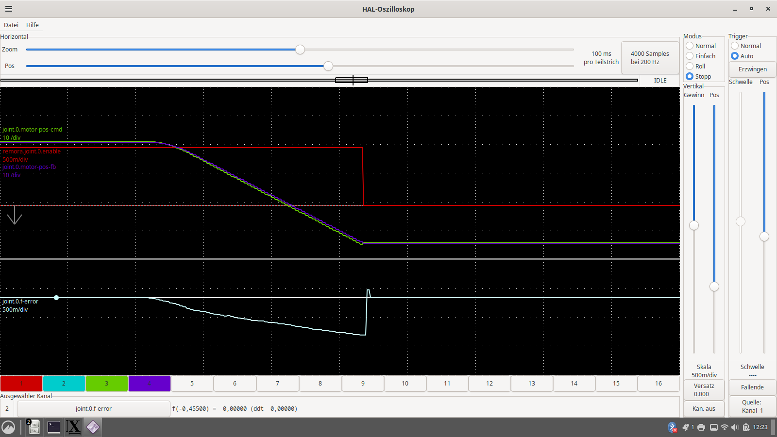

- hubibagi
- Posts: 3
05 Aug 2023 11:08 #276990
by hubibagi
Replied by hubibagi on topic Remora for RP2040
Hi,my error comes that ferror limits are reached. settings of the screenshot are MIN_FERROR = 0.5are these rounding issues ? or is min_Ferror = 0.5 to low ? i added also halscope.csv renamed to .txt
