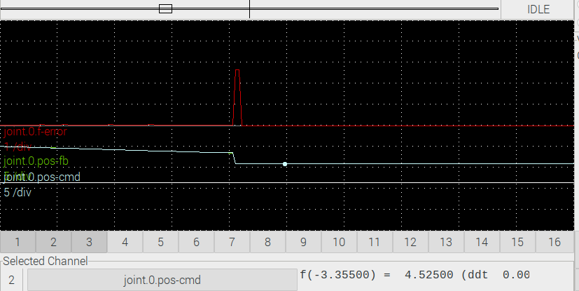

10 Aug 2023 16:47 - 11 Aug 2023 00:07 #277547
by drewnabobber
Replied by drewnabobber on topic Remora for RP2040
Been trying to find the cause of the following errors for a couple of days now and still no luck. Have reduced the velocity, accels and scale dramatically but still the following errors persist.
Commanded position and feedback track fairly closely, but following error is accumulating.

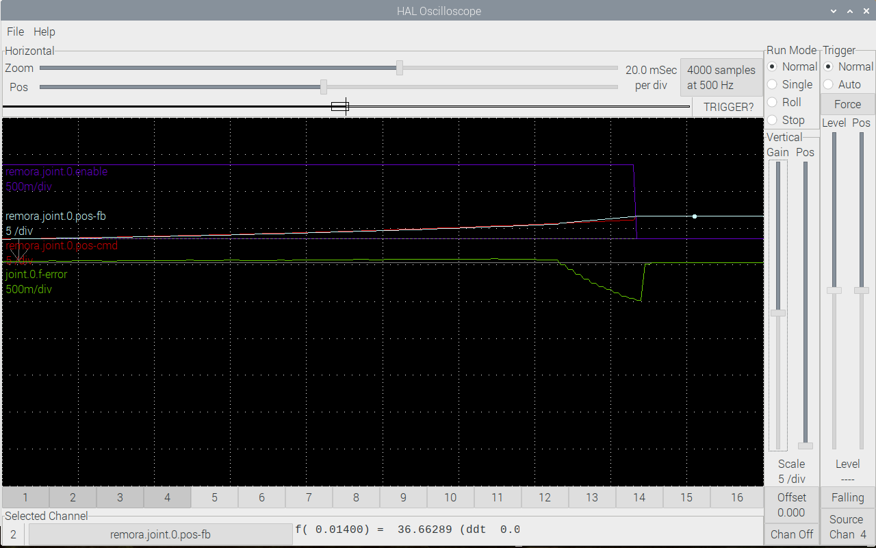

11 Aug 2023 13:13 #277640
by drewnabobber
Yes. Last night before calling it quits for the day, I got the debug output going and I can see that the following errors are correlated with RX failures (RX reset, so no data received).
It really looks to me like somewhere in the pipeline there is some packet loss.

16 Aug 2023 16:09 - 16 Aug 2023 16:09 #278179
by drewnabobber
I found that pgain of 500 and ff1gain of 1 made a big difference. I also found some things in the firmware that seemed to help and I have posted a PR with my changes.

17 Aug 2023 03:44 #278227
by scotta
Replied by scotta on topic Remora for RP2040
The changes have made a huge difference! pgain of 100 seems to be adequate, so I'll update the config to include that as default. ff1gain is set to 1 by default. Higher pgains actually created following errors at high speed by overshooting.
