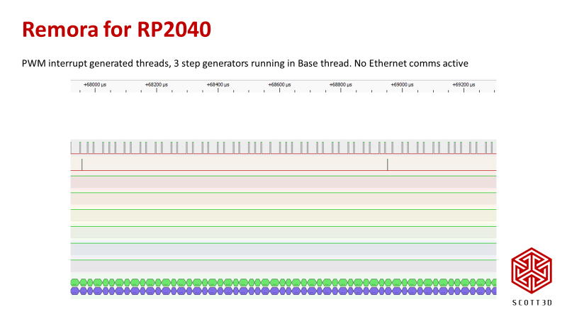

I think there is a good solution using PWM wrap interrupts. Basically using the hardware PWM modules (slices) as a timer as each slice can generate a wrap interrupt.
Need to convert the C code into the Remora timer module, but looking good so far.
The plan will be to use the second core in the RP2040 to run the base thread. Hopefully this will allow a faster thread as the first core can handle the Ethernet stuff and the slower and less time critical servo thread tasks.

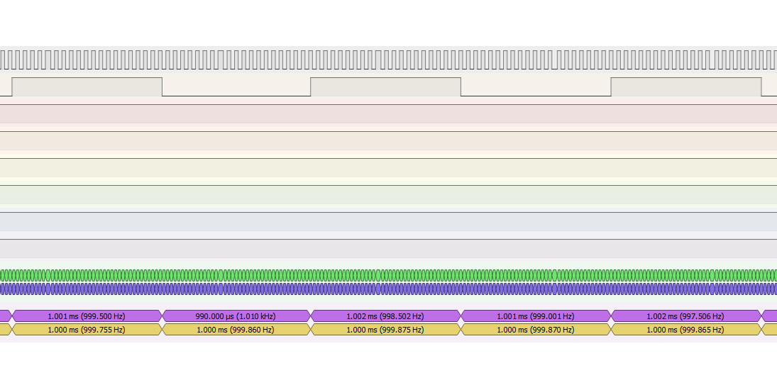

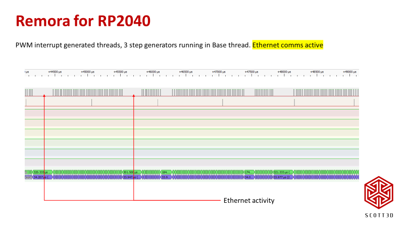

28 May 2023 01:25 - 28 May 2023 01:35 #272300
by scotta
Replied by scotta on topic Remora for RP2040
Some more progress on the RP2040 with W5500 yesterday. The hotel cleaners must wonder what the hell the bundle of wires and blinking circuit boards are when they come. After spending most of the day getting LinuxCNC running on a VM and able to send UDP packets out from the host, communication to the RP2040 with the W5500 is up and running. But following errors... not just minor. What the? Below is a Pulseview capture of the threads running with 3 step generators and a blinky on the servo thread. Looks ok, with some fitter on the base thread (need to figure that out).

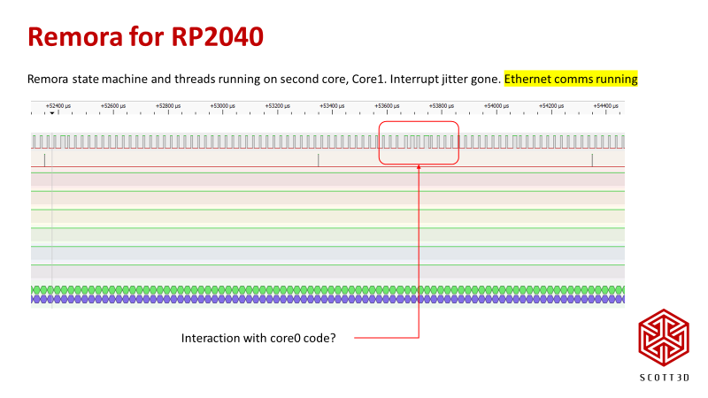

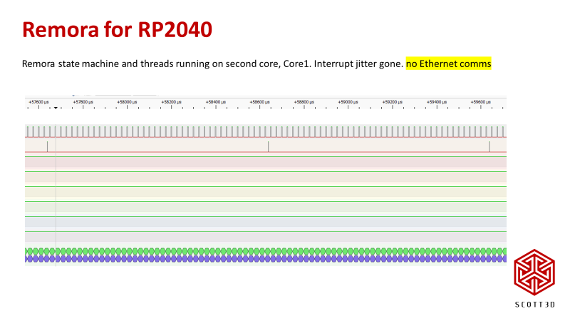

28 May 2023 01:39 - 28 May 2023 01:43 #272302
by scotta
Below is the same setup with LinuxCNC out of eStop - Ethernet communication happy.
Looks like the W5500 + LWIP stack is totally blocking interrupts on the RP2040, something we do not see on the STM32 implementation.
So my thoughts on moving the Base thread onto the second core will be needed. Apparently the LWIP stack will only run on Core 0, so my first attempt at multi-core programming will be to move the Remora state machine and threads all onto the second core, Core1.
Last edit: 28 May 2023 01:43 by scotta.

28 May 2023 02:15 #272304
by scotta
- scotta
- Posts: 959
- Thank you received: 489
28 May 2023 02:25 #272305
by scotta
The issue with the W5500 + LWIP blocking interrupts is significantly gone. Following errors are lessened and I'm suspicious that it's the Virtual Machine latency that's the main issue now. Position corruption is now back. It looks to be the issue that the SPI version had when both the interrupt code and the free running code were accessing the data structure at the same time.
