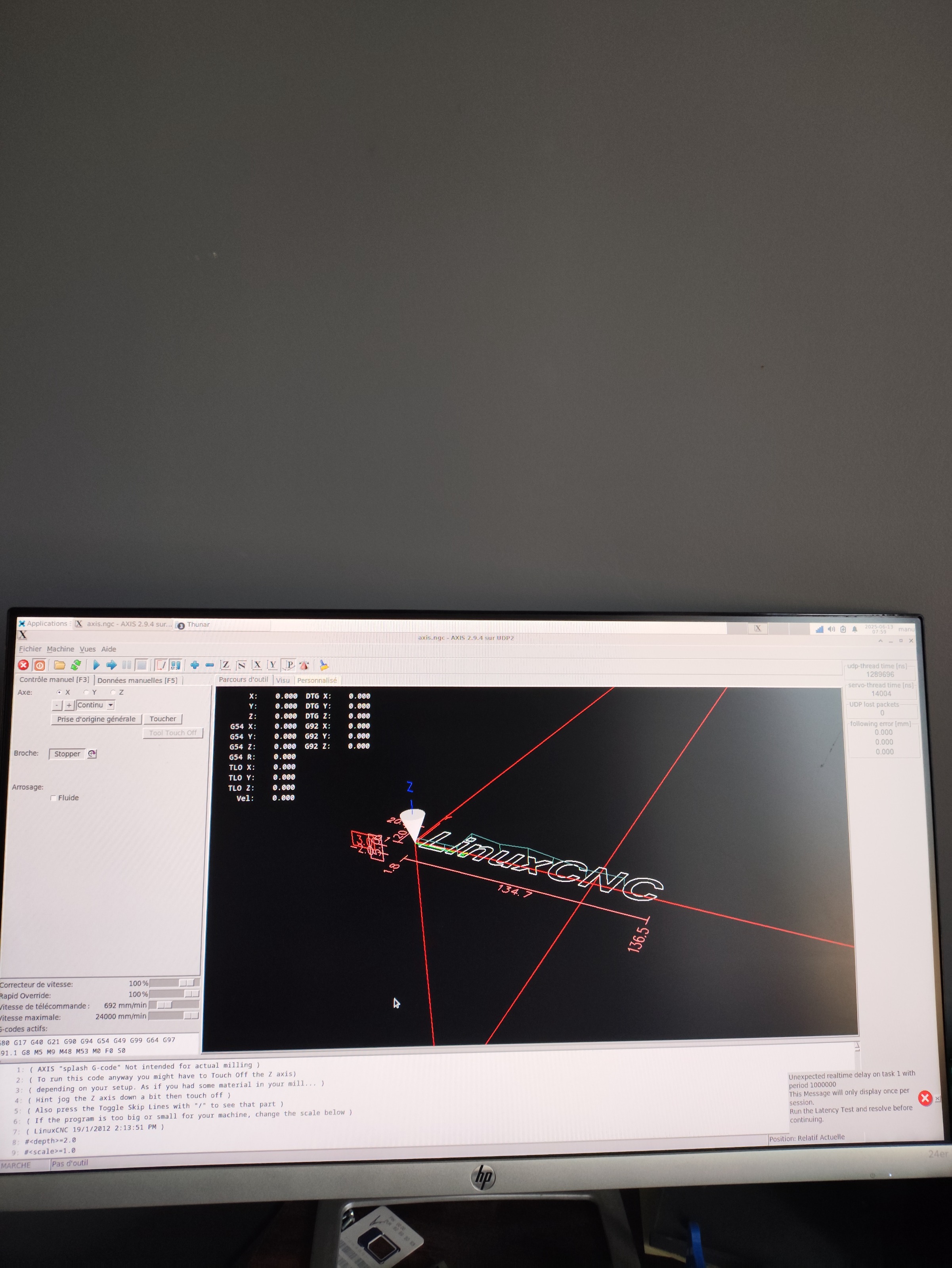

I managed to remove the emergency
I configured the card 10.10.10.11
All that remains is to test with stepper motors,I have a plasma CNC, it will be complicated for a beginner to have the plasmac interface?

09 Jun 2025 16:30 #330048 by tommylight
11 Jun 2025 03:09 #330129 by beauxnez
tommylight post=330048 identifiant utilisateur=17274Capture d'écran ?
I'm traveling, do you want a screenshot of the network configuration?

11 Jun 2025 05:14 #330134 by tommylight
Enjoy your trip, and no, not network, the Axis GUI.
13 Jun 2025 01:04 #330241 by beauxnez
To get the emergency stop to be removed I had to reload the code in ESP32
