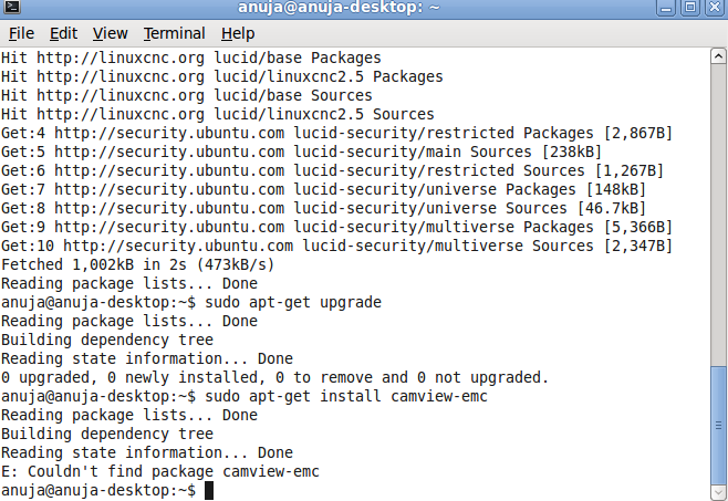

One more question I have. I was also trying to test this in my laptop. I could add the repository but when I had to install camview emc it said couldn't find package. So
is it possible to install this on laptop, including the camunits-plugins-emc? I'm attaching a screenshot of it.
The screen shot shows you did a apt-get upgrade for some reason, but not apt-get update which is required to fetch the lists for the repo you added.
psha's server is down, so I can't check if the paths are still correct, but since you presumably downloaded from there on your other computer,
it is something you did differently on the laptop which is the problem
