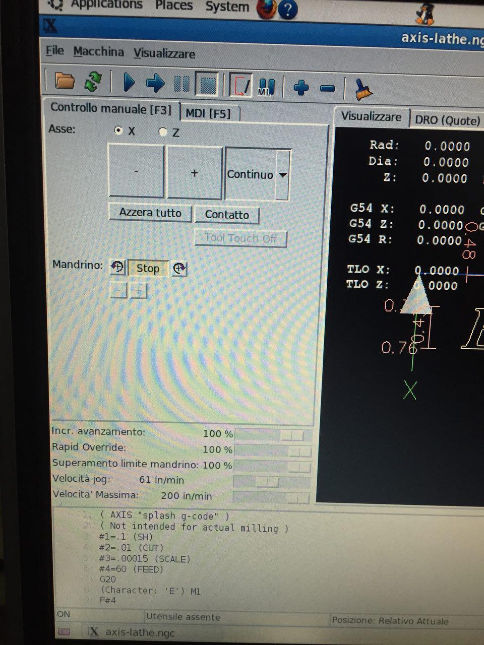

Hi everyone, I'm sorry I'm not a computer programmer but I like to try to modify things. I managed to get the axis.tcl file to zoom in the jog buttons, but I find it hard to figure out where to change the values.
Since all the original Axis GUI is all right, and since the machine controls the whole thing with external buttons, I'd like to eliminate what's missing.
Is there anyone who can explain how to intervene?
Is there any IDE that interprets the code so you can grab it graphically?
Thank you for your suggestions.
