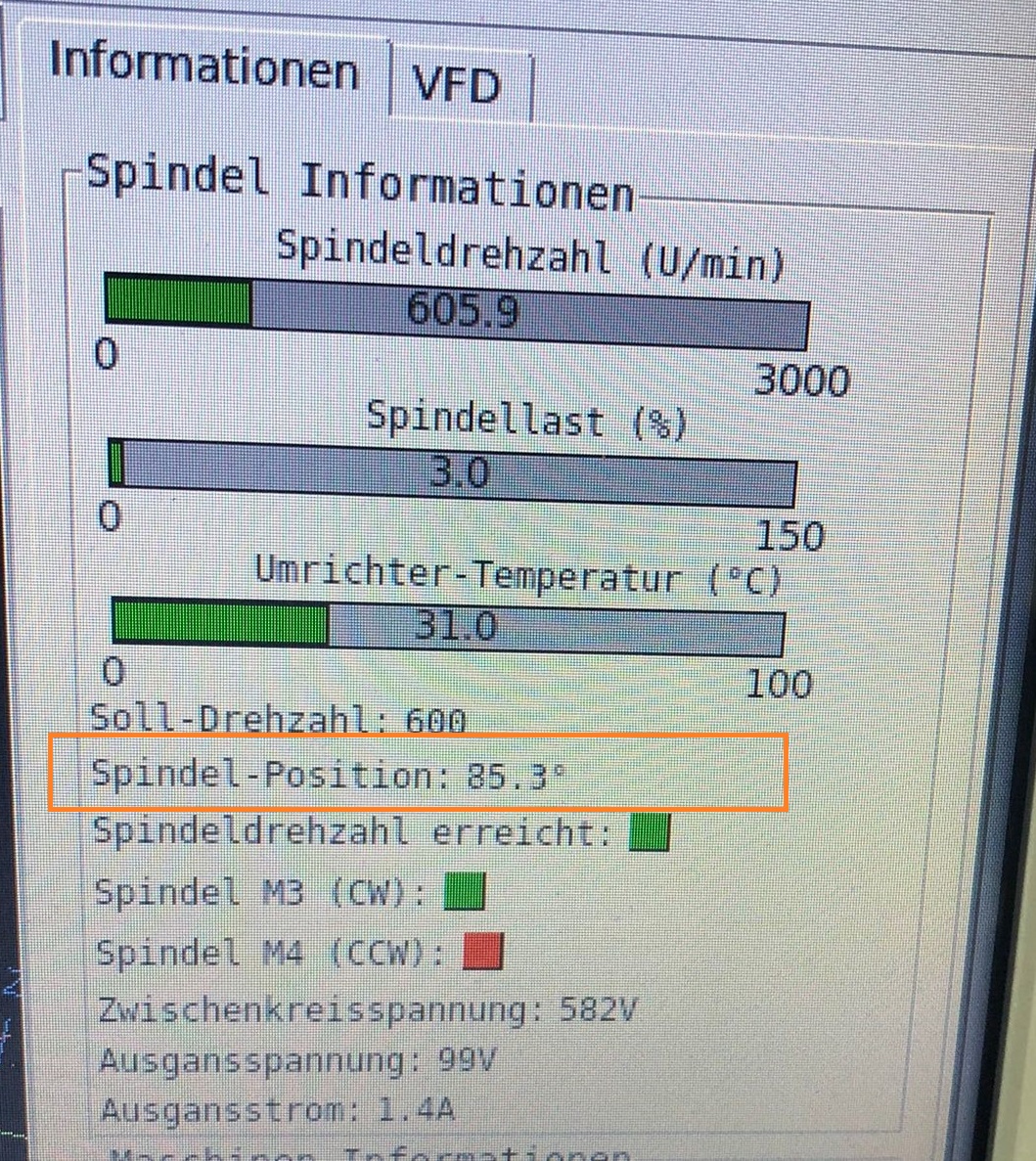

Shouldn't be thought about.
A component that is now so important as the spindle angle not to be entered as an absolute value 0-360° in the HAL component spindle.0.....? Currently I've entered it with me like this see screenshot.

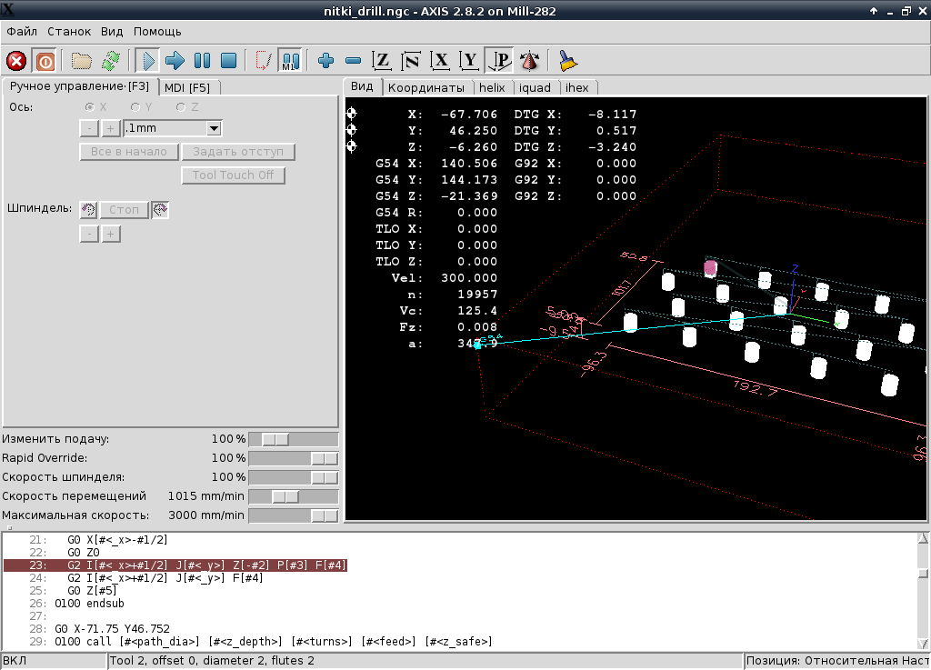

Replied by D.L. on topic Axis Modifications
For this mod, the value of the position is equal to any float point number(and negative), where 1.0 = 360°.
Displayed only part of number after a decimal point, for example, input value = 123.4, displayed 90.0°(0.4).

Replied by Arbiwei on topic Axis Modifications
Yes, I know that, that's why the arithmetic.
I have currently solved it with my own spindelpos.comp component. Can live with that at the moment.

If you only need to display the angle value, without any processing, replace in glcanon.py:
posstrs.append(angformat % ("a", math.fmod(hal.get_value("axisui.display-spindle-angle"),1.0)*360.0))
to
posstrs.append(angformat % ("a", hal.get_value("axisui.display-spindle-angle")))
The following user(s) said Thank You: Arbiwei
