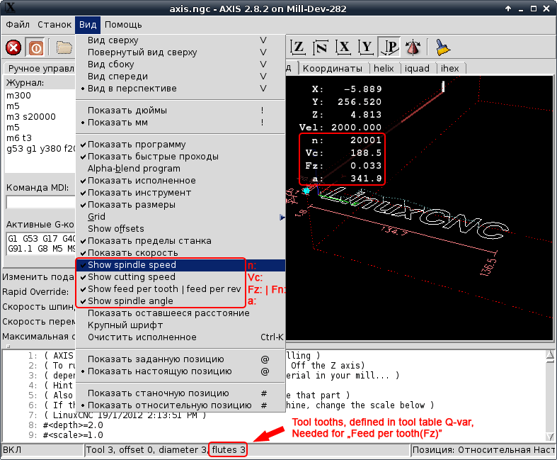

Axis cutting parameters mod.
Mod hal pins axisui.display-spindle-speed and axisui.display-spindle-angle
Connection in file custom_postgui.hal, for example:or
Setup mod
There are 2 ways to install this mod:
1. Replace files(axis, axis.tcl and glcanon.py) in existing installation LinuxCNC v2.8.2, begins to work immediately.
2. Standard compilation from sources downloaded from:
github.com/ddotldot/linuxcnc/archive/ref...ads/2.8-axis-mod.zip
github.com/ddotldot/linuxcnc/archive/ref...ads/2.7-axis-mod.zip
Building guide: linuxcnc.org/docs/devel/html/code/building-linuxcnc.html
Setup to existing installation LinuxCNC v2.8.2:
Open linuxcnc-2.8-axis-mod/src/emc/usr_intf/axis/scripts/axis.py with text editor and replaceto
Setup to existing installation LinuxCNC v2.7.15:
It is possible to setup only the old version mod!
Old version mod hal pins:
motion.analog-in-00 (spindle speed)
motion.analog-in-01 (spindle angle)
Connection in any hal file.

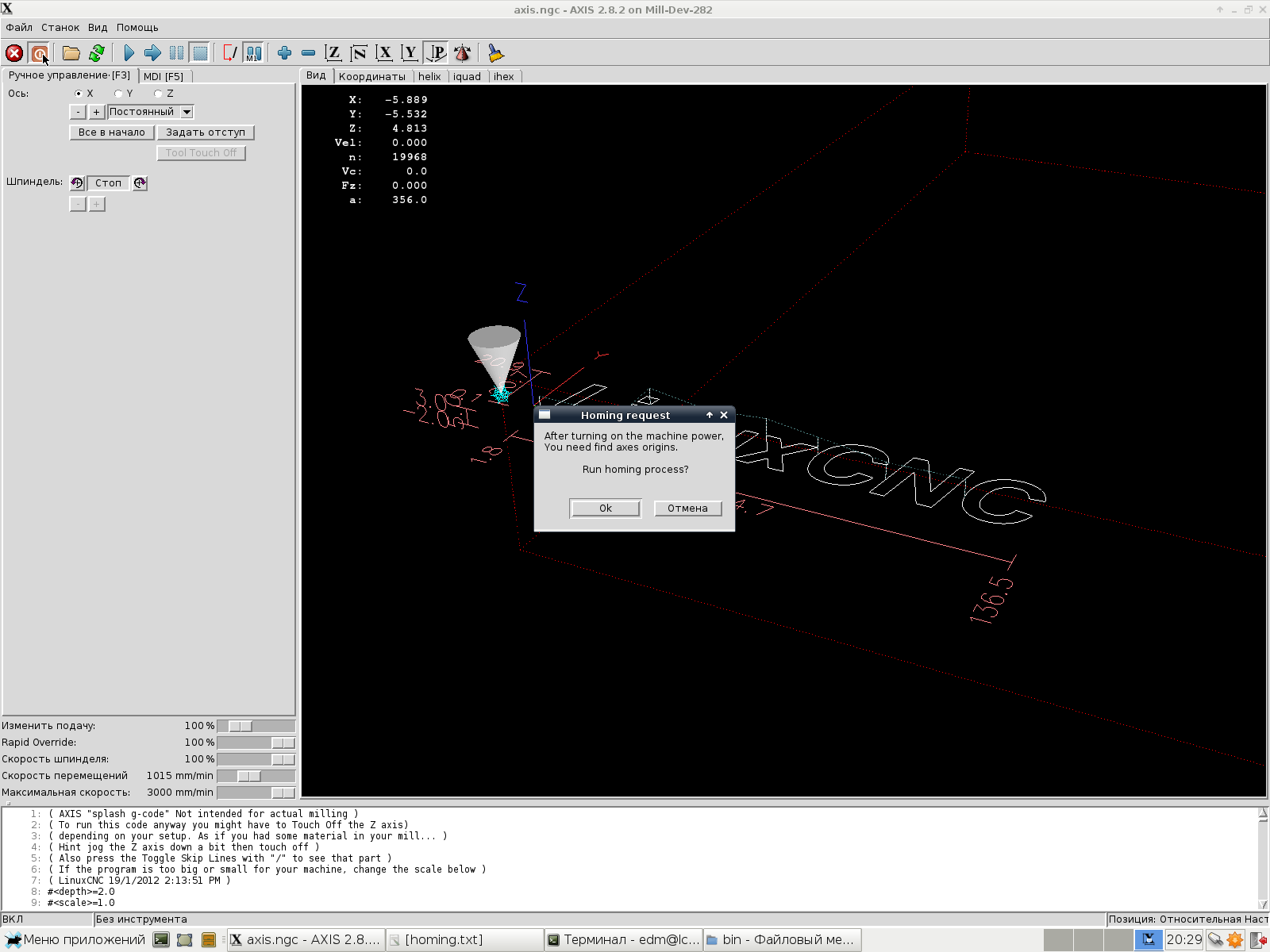

Simple mod - homing request message when press Machine Power button:
In axis file replace this code:to this code(2.8):to this code(2.7):
def onoff_clicked(event=None):
s.poll()
if s.task_state == linuxcnc.STATE_ESTOP_RESET:
c.state(linuxcnc.STATE_ON)
else:
c.state(linuxcnc.STATE_OFF) def onoff_clicked(event=None):
s.poll()
runHoming=prompt_areyousure(_("Homing request"),_("After turning on the machine power,\nYou need find axes origins.\n\n Run homing process?"))
if runHoming:
commands.home_all_joints()
else:
s.poll()
if runHoming:
commands.home_all_axes()
else:
c.state(linuxcnc.STATE_OFF)Attachments:

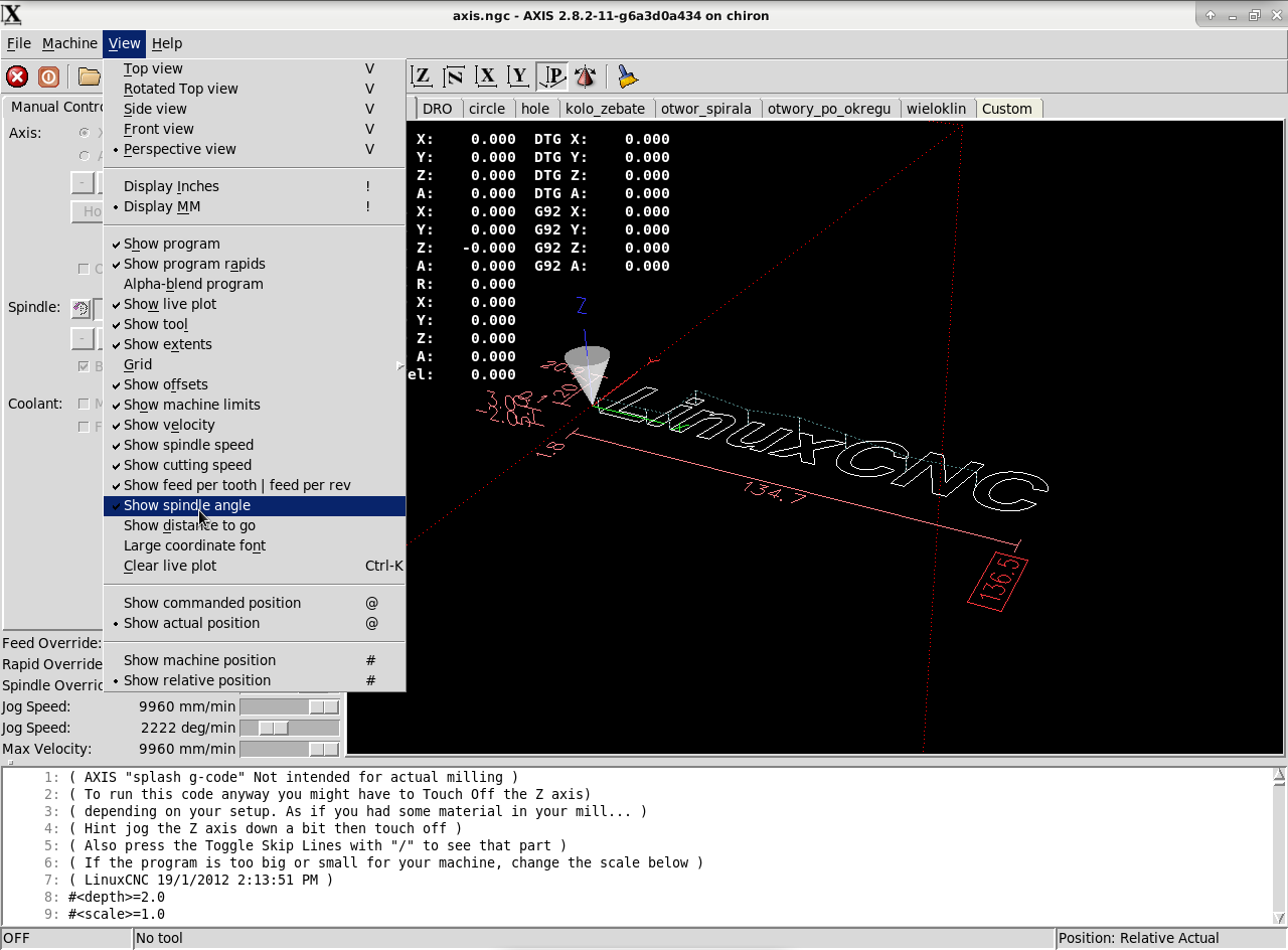

very nice I've been looking for a way to display the spindle position for a long time. Are you planning to start a pull request or will your development not be included in the LinuxCNC project? why is the letter of the spindle a lowercase "a"? At Heidenhain it is "S1" for the first spindle, "S2" for the second, etc.
- D.L.

Hi.
PR is planned, maybe a little later, mod for 2.9 yet not tested.
'a' = 'angle', it can be easily replaced by another text.
To do this, find and replace one string in the file glcanon.py.
For example:
posstrs.append(angformat % ("a",
to
posstrs.append(angformat % ("S1",
For example:
to
