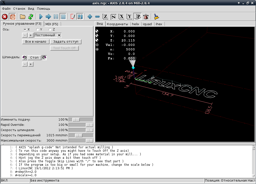

A small improvement to my mod: icons have been added to show the enabling of the adaptive feed and the spindle-at-speed signal.
The spindle-at-speed signal is connected only in the custom_postgui.hal file, for example:
Mod links:
github.com/ddotldot/linuxcnc/tree/2.8-axis-mod
github.com/ddotldot/linuxcnc/tree/2.8-ax...-updated-mesa-driver
Code:
net spindle-at-speed => axisui.display-spindle-at-speed

Re: D.L.'s axis mods:
I tried installing the axis mod for spindle speed/feed per tooth etc. and found the following:
I followed the instruction here "1. Replace files(axis, axis.tcl and glcanon.py) in existing installation LinuxCNC v2.8.2, begins to work immediately."
and got the error 'option values must be strings'
traced that to lines 3100-3103 in the 2.9 branch of this code on github, each of which has False as the last term.
Added quotes to make them strings e.g.:
vars.show_spindle_rpm.set(ap.getpref("show_spindle_rpm", "False"))
and axis now starts without error. Haven't got the mod to work yet but still working on it.
