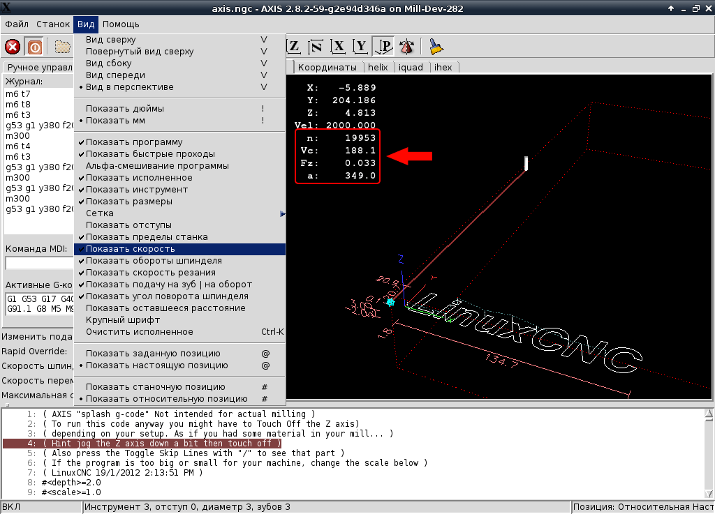

Axis mod: Spindle speed, cutting speed, feed per tooth|feed per rev, spindle angle in Axis display.
n: spindle speed
Vc: cutting speed
Fz: feed per tooth(for mill)
Fn: feed per rev(for lathe)
a: spindle angle
Hal connection:
=> motion.analog-in-00 (spindle speed, rpm, commanded or from encoder)
=> motion.analog-in-01 (spindle angle, 1.0 = 360deg, pos from encoder)
For storage tool tooth used Q-var in tool table(only for mill, not affected lathe version).
Files for 2.7.15:
Files for 2.8.2:
n: spindle speed
Vc: cutting speed
a: spindle angle
Hal connection:
Files for 2.7.15:
Files for 2.8.2:

17 Nov 2021 21:56 #226793
Replied by andypugh on topic Axis Modifications
I like that. In fact I can see an argument for it being a built-in.
In the same way as you get a feel for surface speed on a lathe, you can got a feel for chip load on your mill.

Added correctly calculation of cutting speed for inch units display mode.
For inch display mode cutting speed in surface feet per minute (SFM) units.
For mm display mode cutting speed in surface meters per minute (SMM) units.
Files for 2.7.15:
Files for 2.8.2:
Files for 2.7.15:
Files for 2.8.2:
