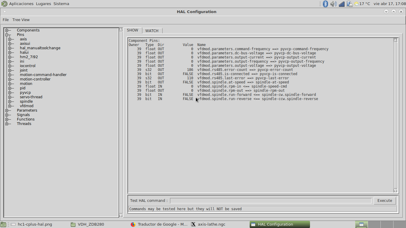

17 Apr 2020 22:15 #164341 by COFHAL
Replied by COFHAL on topic [ Vfdmod ] not control
I have a problem with the userspace component vdfmod vdfmod. I installed it to control my VDF Fuling DZB280, when I run linuxcnc, the VDF automatically receives the minimum RPM command, in this case 300 RPM, but it is not possible to control the VDF, it cannot RUN, STOP or change frequency. And on the control panel, the RS245 connection LED is always red. When seeing the HAL configuration, I see that all the vdfmod.parameters are connected to the panel but not to any input as it appears in its picture. The same goes for all vdfmod rs485 commands.
