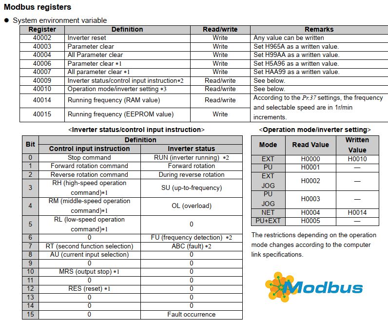

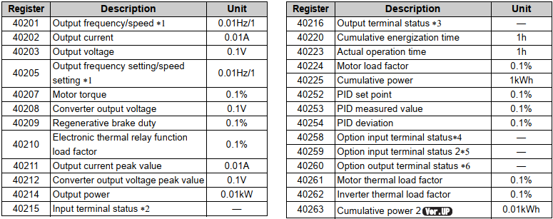

15 Jan 2022 14:47 - 15 Jan 2022 15:05 #231927 by hitchhiker
Replied by hitchhiker on topic [ Vfdmod ] An easy VFD control over MODBUS RTU
hi!
I want to work with your component but i think i am to stupid to do the correct changes to the ini......
i add the ini to this reply and a picture from the registers.
please please please help.... thanks...
Last edit: 15 Jan 2022 15:05 by hitchhiker.
17 Jan 2022 12:16 #232149 by hitchhiker
hi...nobody has a toip,idea or could help me?!
thanks
