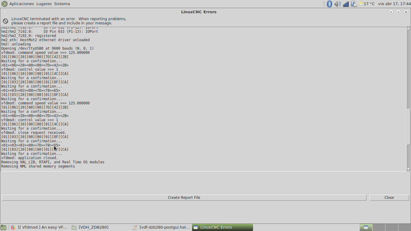

It seems communication settings wrong (error code 110), check parameters in RS485 group. And please show your ini file here.

Attachment m INI file and the DEBUG serial USB
- aekhv
- Posts: 49
- Thank you received: 18
17 Apr 2020 23:32 - 17 Apr 2020 23:34 #164355
by aekhv
Replied by aekhv on topic [ Vfdmod ] not control
In debug output I see everything is fine, there is no modbus errors, so communication MUST be established and error count MUST be zero. But in your previous screenshot error count is not zero, is that screenshot was made with different (wrong) config?
If connection established (I guest it is so) but start/stop commands are not working, then check signal names in main HAL file:
Are these signals exist?
spindle-speed-cmd (correct name may be spindle-speed-cmd-abs)
spindle-cw.spindle-forward
spindle-ccw.spindle-reverseAre these signals exist?

20 Apr 2020 14:55 #164865
by COFHAL
Replied by COFHAL on topic [ Vfdmod ] not control
It is not clear to me. I am enclosing my hal file for you to verify.
Another question: do these instructions go in the main hal file or custom.hal:?
net spindle-speed-cmd => vfdmod.spindle.rpm-in
net spindle-at-speed <= vfdmod.spindle.at-speed
net spindle-cw motion.spindle-forward => vfdmod.spindle.run-forward
net spindle-ccw motion.spindle-reverse => vfdmod.spindle.run-reverse
Can you post your main hal file for comparison?

20 Apr 2020 15:24 #164868
by COFHAL
When checking again, and executing a g code, there is control of the VDF, that is, it starts adjusting the speed and when it finishes executing the g code, it stops. But it is not possible to control it from the MDI.

21 Apr 2020 01:27 - 21 Apr 2020 01:28 #164909
by aekhv
Where is no strong instruction how HAL pins should be connected, because depending of LinuxCNC version (I mean Stepconf & Pncconf version when you created your machine configuration) HAL pin & signal names can be different, what's why my HAL file may be useless for you.
Ok, I guess I know what you should to try:
1. Find and uncomment this line in your main HAL file:
2. Add to your custom.hal these lines:
Replied by aekhv on topic [ Vfdmod ] An easy VFD control over MODBUS RTU
#net spindle-at-speed => spindle.0.at-speed2. Add to your custom.hal these lines:
# Add these lines after 'loadusr -W vfdmod ...'
net spindle-vel-cmd-rpm => vfdmod.spindle.rpm-in
net spindle-cw => vfdmod.spindle.run-forward
net spindle-ccw => vfdmod.spindle.run-reverse
