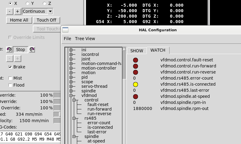

Hi, this is outstanding, very easy to learn and use. But.... I'm not there yet.
I've been trying for three days to get this to play nice with a Bosch Rexroth EFC 3610 VFD. As best as I can tell the "words" (0x03 and 0x10) are not actually handled properly (or Bosch Rexroth is non-compliant) as there is no way to define how many words and number of Byte.
Things that work:
1. vfdmod.rs485.Is-connected = True
2. SpindleRpmOut = Value on front of VFD display (excluding multiplier)
So I'm confident the comms is working but the "writes" are not working. Now, my VFD doesn't work on RPM but xxx / 400hz out of 24,400 RPM. So if the VFD is set to 188 / 400 = 24k * (188 / 400) = 11,280 RPM. Maybe I've misconfigured it, happy to show RPM on display instead of xxx / 400hz if that makes the problem go away.
According to the Modbus commuications example to set the frequency section "14.3.5 Modbus Communication Example
- Example 1" and "Tab. 14-18 - Function 0x10: Write N register words, range: 1...16" of the manual
- Expected Frequency forward rotation (0X0081) at frequency of 50.00Hz (represented by 5,000 = 0X1388) internally
[01][10][7F][00][02][04][00][81][13][88][8A][E3]
- Value sent by vfdmod at frequency of 20.00Hz (0x0088)
[01][10][7F][00][00][01][02][00][88][28][F1]

Opening /dev/ttyUSB0 at 9600 bauds (N, 8, 1)
vfdmod: reading 'spindle.rpm-out' from address 4096 (0x1000)...
[01][03][10][00][00][01][80][CA]
Waiting for a confirmation...
<01><03><02><49><70><8E><30>
vfdmod: returned value is 18800 (0x4970)
vfdmod: setting command speed value to 20 (0x0014)...
[01][10][7F][00][00][01][02][00][14][28][98]
<01><10><7F><00><00><01><18><1D>
vfdmod: setting control word value to 136 (0x0088)...

Just an update on my YL620 woes. I eventually gave up trying to use the RS485 port that would normally be used for external PC control. It simply does not accept any messages at all, and always gives "Illegal data value" no matter what.
I noticed in the manual that the built in LCD panel is also communicating via RS485, at 19200 baud and fixed address of 10. I disconnected it and used a logic analyzer to view the signals it was sending. Turns out the manual was wrong, this link runs at 38400 baud! At least the address was correct, and the signal looks like normal modbus.
Then I connected my USB/RS485 adapter to the plug that the LCD panel had been using, and did a factory reset so that control would be returned to that port. And that.... just worked with no problems.
At least, the connection is ok. No errors and the LED display is green, and in the debug output I can see values are being set in the VFD registers without any faults. Now my next problem is that vfdmod never sends the "RunForward" value to command the spindle to start. Here is my setting for that register:And here is what it sends, no matter what I do in the LinuxCNC GUI:I can see the other register (command speed) being changed when I click the + button in the GUI to increase the speed. But of course the spindle will not start if it's continuously being sent the StopValue (0x0001) command. I'm new to LinuxCNC so perhaps I'm missing something, but I thought the spindle should start if I disable e-stop (red cross button), then enable motors (orange power button), then click either forward or reverse for motor direction, and then increase the speed.... right?
YouTube video:
[Control]
Address=0x2000
RunForwardValue=0x0012
RunReverseValue=0x0022
FaultResetValue=0x0080
StopValue=0x0001vfdmod: setting control word value to 1 (0x0001)...
[0A][06][20][00][00][01][42][B1]
<0A><06><20><00><00><01><42><B1>YouTube video:

Have you made the necessary connections in your hal?
net spindle-cmd-rpm => vfdmod.spindle.rpm-in
net spindle-at-speed <= vfdmod.spindle.at-speed
net spindle-cw spindle.0.forward => vfdmod.control.run-forward
net spindle-ccw spindle.0.reverse => vfdmod.control.run-reverse
[edit]
And if you have, can you see the spindle-cw signal go true in the Hal show tool?
[edit]
