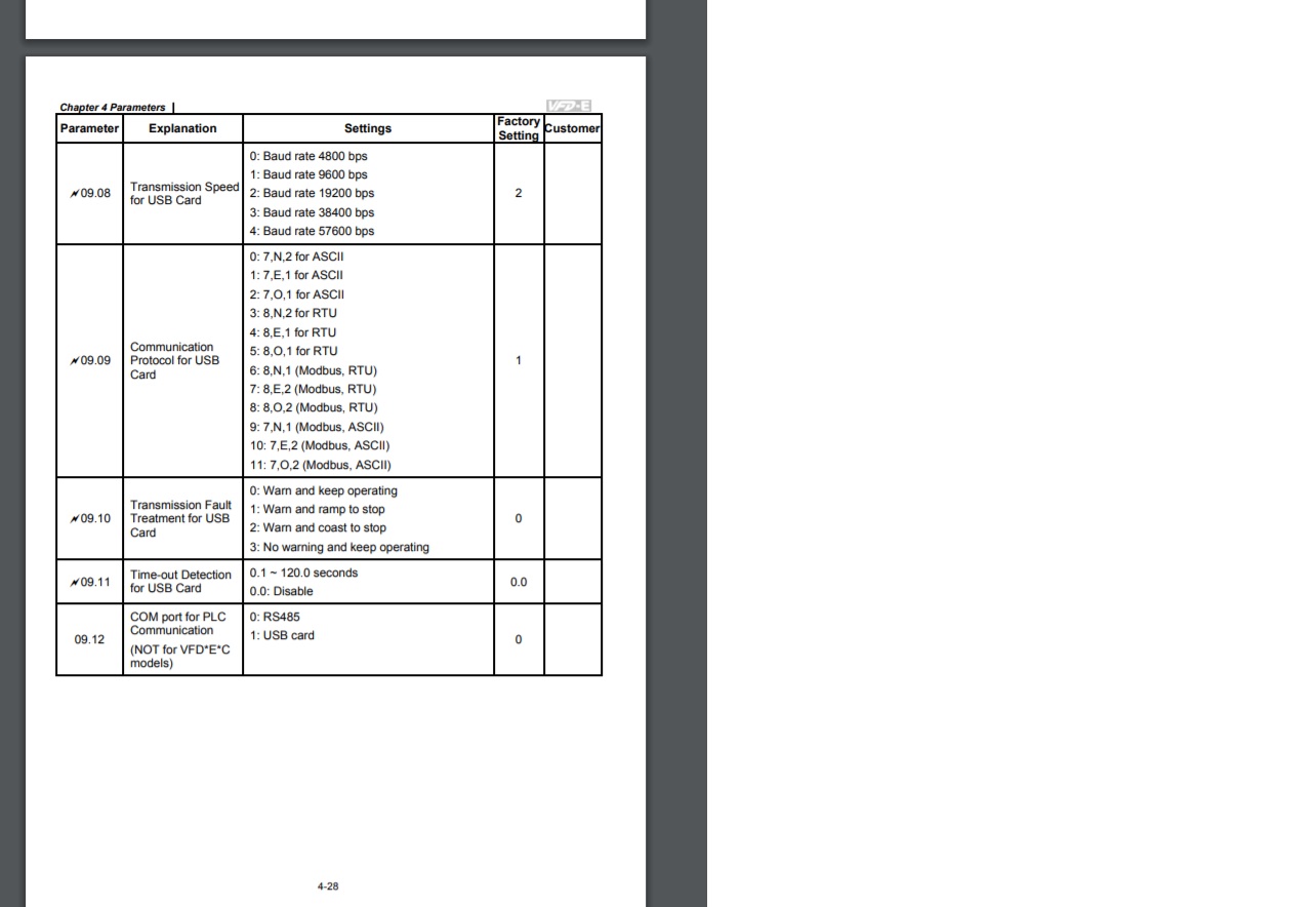

20 Jun 2020 21:15 - 20 Jun 2020 21:42 #172194
by taloot
i have same error i cant solve it...
I have VFD-E delta
i adjust the setting in the VFD for baudrate but still i m getting error 110... in my windows it work with Delta VFDsoft
there is ASCII and RTU
also RTU modbus,
and ASCII modbus,
which protocol should work with this
Replied by taloot on topic [ Vfdmod ] not control
It seems communication settings wrong (error code 110), check parameters in RS485 group. And please show your ini file here.
I have VFD-E delta
also RTU modbus,
and ASCII modbus,

21 Jun 2020 05:37 #172219
by aekhv
Replied by aekhv on topic [ Vfdmod ] An easy VFD control over MODBUS RTU
Hi taloot,
Vfdmod works in RTU mode, ASCII mode is not supported. According to your INI file I see communication speed is 9600 baud, 8N1. Be sure your VFD is configured on the same way: parameter 9.08 should be 1, and 9.09 should be 6. Also check VFD slave address, it should be set to 1 as it specified in your INI file.

22 Jun 2020 00:38 #172289
by taloot
yeah i did same but no luck,,, i used the VFDB component and it works well i used ur generator to make the pyvcp and it work fine (after manually edit it ) ,,
i just need to add some monitoring parameter to source driver,, do u have any idea how can i compile the vfd , component submake file
