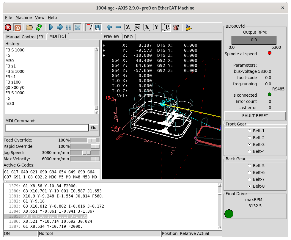

09 Mar 2022 09:13 #236744 by rodw
Well thanks very much for sharing the config for the BD600 VFD. I got this going today and am very happy.
I did not see any issues with forward and reverse. M3/M4 seemed to do the right thing.
I fitted this to a belt driven machine with 12 different gearing ratios so I'm not sure how to tackle that yet
I scaled it for the fastest speed.
I did notice the frequency output was not scaled correctly. It was out by a factor of 10

09 Mar 2022 10:16 #236747 by rodw
I think it could be scaled in hal. Each gear has a defined ratio. I might write a custom component to do it but coding the GUI for the selection, I try and avoid. Maybe Lincurve would do it.

10 Mar 2022 23:02 #236902 by rodw
It is very common for VFDs to read the input for spindle speed to one decimal point. For example, you'd have to input 3000, for the drive to see 300.0hz.
Todd, thanks, Last night I wrote a component that lets me select the front belt and back belt and retrieve a scaling factor for the given belt combo based on some tacho data I collected earlier. Also paired it with an extension to the PYVCP panel. So I should be able to send the S command to the component which will scale it to correct Hz before sending it to the VFD.
I cheated though and hardcoded all of the ratios in the component.
11 Mar 2022 03:42 #236912 by rodw
It took a bit of doing but it worked!
I asked for 1590 rpm and he tacho said it was doing 1599 rpm so close enough as there are lots of rounding and truncation errors.
