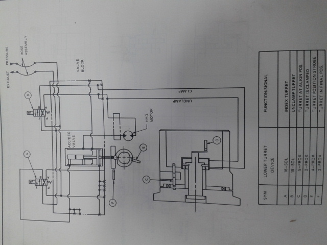

good afternoon,
My name is Jorge Viloria. I'm trying to do a retrofit to a lathe cincinnati. thanks for you collaboration in my other threads
but I have no clear as classicladder I will apply in my tool change. works with a hydraulic motor, valve acceleration / deceleration, solenoid valves, sensors.
you put here, the sequence having the manual.
the following sequence of events occurs when indexing the lower turret by "cnc" program command. the hydraulic diagram for the lower turret is shown in figure 7.1.3
1. the control checks the current position of the turret. if the turret is already in the programmed position, no physical index takes place. This allows tool offsets to be activated or cancelled without adding cycle time. If the turret is not in the programmed tool position. The indexing sequence begins as described in the following steps.
2. A solenoid valve (labeled "B" in figure 7.1.3) is energized to unclamp the turret face coupling. A proximity switch (labeled "D" in figure 7.1.3) is released when the turret is moved axially by the hydraulic cylinder to the unclamp position.
3. The control calculates the number of the tool positions that the turret must rotate to reach the programmed position.
4. A solenoid valve (labeled "A" in figure 7.1.3) is energized to the index the turret. the plunger of the acceleration/deceleration valve begins to retract from the cam and the hydraulic motor begins rotate. The hydraulic motor drives the turret through a gear train in the direction shown in figure 7.1-1. The speed of the motor/turret. rotation increases as the valve plunger retracts from the cam.
5. A proximity switch (labeled "E" in figure 7.1.3) is release between turret tool positions and actuated at each tool position. The control down-counts one position number each time switch "E" is released and actuated. Turret rotation continues until the turret is one tool position away from the programmed position. Solenoid valve "A" is then de-energized.
6. The plunger of the acceleration/deceleration valve begins to advance toward the cam. As the plunger advances, the valve restricts the exhaust line of the hydraulic motor and the motor decelerates. The rate of valve plunger advancement is controlled by the cam. The speed of rotation is low when the plunger reaches the low point of the cam. The motor continues to drive the turret toward the final position, wich is the lowest point on the cam.
7. when the final position is reached on the cam, a proximity switch (labeled "F" in figure 7.1.3) is actuated.
8. Solenoid valve "B" is de-energized to clamp the turret face coupling. Proximity switch "D" is actuated when the turret is moved axially by the hydraulic cylinder to the clamp position.
9. After time delay, the control releases the cycle-hold condition of the turret's active program and the indexing sequence is complete.
I appreciate any help

Yes it should be very similar to my ladder on my CHNC. I assume only the movement part might be different.
What exactly do you need guidance on?

Step 3 does seem a bit lacking on description... how can it calculate the position unless it knows the current position? My VMC has a tool changer and it "homes" the changer to discover where it is at somehow... I assume it has one station with a second prox on it or some other means to determine where it is at. On the CHNC turret it has an absolute encoder so it always knows where it is at.
Once you know the position then use a counter in ladder to move the correct number of tool positions to the next tool.
Moving one tool position from the description you have to go all the way around to release the plunger one position ahead of the requested position unless you just energize the solenoid and release it... that might take some experimentation.
I'll try and post the general logic of the tool change in a bit.

To initiate the tool change you need to make a few hal connections to the classicladder.
In classicladder you now need to take the input from iocontrol.0.tool-change when it comes on you execute the ladder needed to spin your turret. The tool prep number is the tool needed.
Ladder execution is read inputs, solve logic, update outputs which is different than C or most other programming languages.
In sudo-code your ladder might start off similar to the following:
[tool change rising edge]
(trigger step 1)
[step 1 trigger]
[not step 2]
(step1)
[step1]
[step1]--[calculate number of moves]----[store into counter]----(step 2 trigger)
[step 2 trigger]
[not step 3]
(step2)
[step2]
etc.
See what you can do with this... btw have you manually cycled the tool changer and know the valves and proxes work?
John

I'm checking as the machine tool takes the # 1 position, proximity sensor "C" is the one that tells you the # 1 position.
give me some guidance on how to do the codes G65, etc.

If prox "C" tells you what is tool #1 then when you start LinuxCNC and the Tool = 0 in your ladder the logic would be something like the following
if current tool = 0
spin until tool 1 is found
now keep track of the current tool each time a tool goes by
and spin to tool requested
for subsequent tool changes
if current tool >0
calculate the number of moves needed to reach tool requested
move that number of indexes
It helps in ladder to write sudo-code like the above and work out the details then translate that to ladder.
John
if current tool = 0
if current tool >0
John

Andy:
as I do that the G65. could you give me an example?
Do you think you could code it in G-code? (using G65 etc to control the valves)? In that case you could look at re-mapping M6 into a G-code sub.
in liks you posted this information, but do not understand how to assign a code G, to a valve
thanks
thanks
