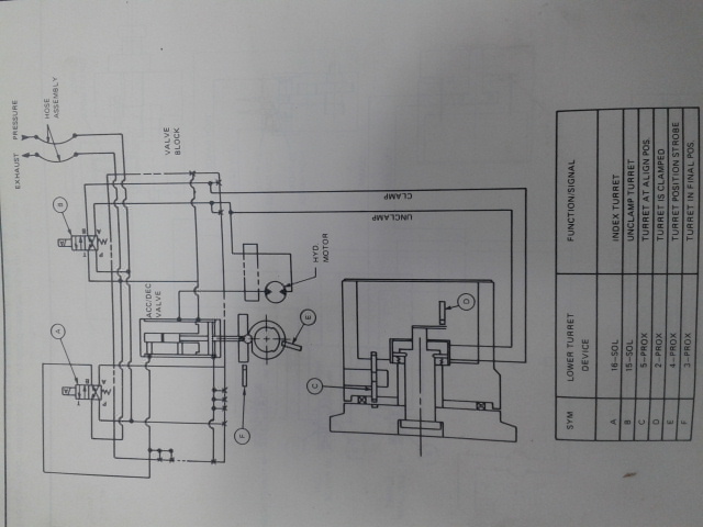

my turret has a hydraulic motor. rotates in one direction only.
does not have an encoder as John Hardinge lathe.
has an alignment sensor (C) indicates the position 1
has a sensor (E), "turret position strobe" is release Between positions and actuated tool turret at each tool position. The control down-counts number one position each time switch "E" is released and actuated. Turret rotation Continues Until the tool turret is one position away from the programmed position. Solenoid valve "A" is then de-energized.
has a sensor (F) (turret in final position) when it reaches the lower right position and activates the sensor. the de-energized "solenoid B" and retracts the turret, activating the sensor clamped. (D).
there is more to say that any advice, tips, suggestions,
thank you all.

Friend I am sorry to bother you, you've got a big responsibility ....
My cincinnati has two turrets but will use only one. for now.
my cincy not tailstosk.
has, chip extractor, gearchange, hydraulic turret,
Rick, when you mention the 3 sensors (BCD) you mean????
sensor C "turret AT align pos"
Sensor E "turret position strobe"
F sensor "turret in finall pos"
Sure Rick, I spend reading everything about linuxcnc, although I must say that my shortcoming in English very difficult things. but forward. I decided with this.
And I want you to know that I am immensely grateful to you and the other guys ... BigJohn, andy, peter, robhm dangercraf (Francisco).
I barely know the incredible project.

BCD 1, BCD 2, BCD 3 are each plunger style limit switches that ride on a cam wheel mounted to the rotating shaft on the large upper turret. They establish the position of the turret. There is a truth table in the cincy service manual that will tell you turret position based on the current state of those three switches.
How many tools will your upper turret hold?
I want to say our ladder logic only has maybe 9 or 10 rungs to make this thing work.
Rick
Rick

the turret has 8 positions.
but they are not the same? bone are others besides these?
only shows this in the manual I have. I refer to the image attached. shows no truth table or refer to other sensors.
thanks
thanks

I am posting the pages relevant to our 7 position turret. You will need to find the Truth table for you 8 position turret. Try CNC Zone or ebay to see if you can find the service manual for you machine. Actually you can still get manuals and Prints for your Cinci. From Mag if all else fails. The turret position is taken from the truth table and nothing else. Hope this helps.
