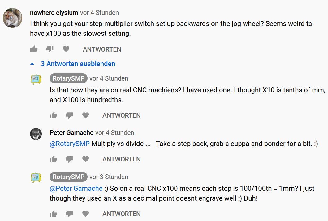

Like you said, forget netting with the GUI buttons. Although I then did that as well in parallel, just to see if you can have the screen buttons follow the INCR switch. But that is probably pointless.
