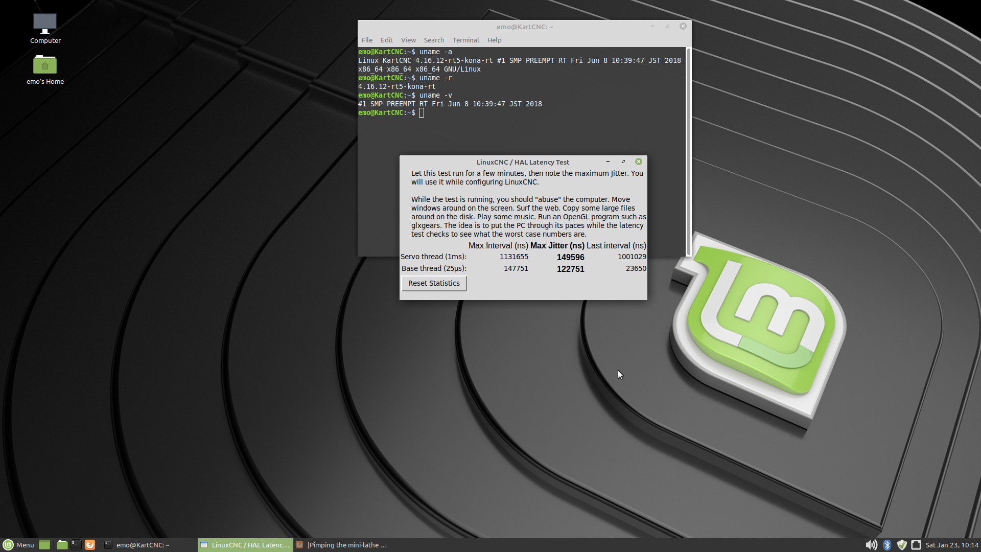

21 Jan 2021 18:24 #196124
by EMOFLY
Replied by EMOFLY on topic Pimping the mini-lathe
Hi, Mark
I have make a mistake, I bought a GB-bace 3160.
Can you share with me this image
"This one:
forum.linuxcnc.org/9-installing-linuxcnc...aver-mint-iso#165631
Looks like Mint 19.3 + MATE + 2.8"
thank's in advance
Emil
"This one:
thank's in advance
Emil

21 Jan 2021 22:07 #196156
by EMOFLY
Thank you,
I use this, but I have horrible latency test(numbers) like 17000000 with this PC GB-bace 3160.
- Posts: 21959
- Thank you received: 7478
21 Jan 2021 22:13 #196159
Replied by tommylight on topic Pimping the mini-lathe
Press and hold the Shift key after pressing the power button, choose the kernel with RT in the name at the grub menu (advanced something or another) and boot.
I will add the info for setting it as the default kernel.
The following user(s) said Thank You: EMOFLY
- Posts: 12156
- Thank you received: 4149
22 Jan 2021 10:36 #196195
Replied by rodw on topic Pimping the mini-lathe
Unless the bios has changed (and it may have) this PC worked OK for me.
You need to edit the bios to disable any of the C7 type wait states.
Too long ago for me to remember
The following user(s) said Thank You: RotarySMP, EMOFLY

- EMOFLY
- Posts: 5
22 Jan 2021 21:51 #196287
by EMOFLY
I turned off everything like you.
But when I choose the kernel with RT in the name at the grub customizer menu, PC is freeze after 1 minute.
Can you post here your uname -a
- EMOFLY
- Posts: 5
23 Jan 2021 08:27 #196317
by EMOFLY
