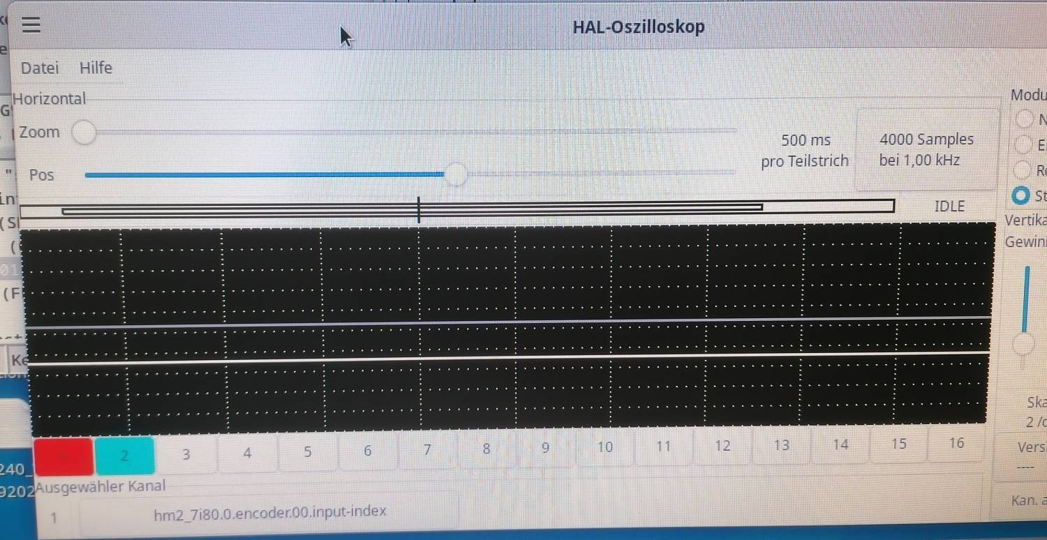

05 Sep 2025 19:08 - 05 Sep 2025 19:56 #334506
by ziggi
Replied by ziggi on topic Troubles to get started with SD240 Retrofit
No, something is wrong.
the hm2_7i80.0.encoder.00.input-index pin permanently stays true and
the x-index-enable signal permanently stays false. The pictures show the state they are in and also when moving the axis by G1 F10 X 0 to 10 and back nothing changes
And the index-enable does not go high when the home switch trips (when homing)

- Posts: 18103
- Thank you received: 5326
05 Sep 2025 19:22 #334507
Replied by PCW on topic Troubles to get started with SD240 Retrofit
Are you saying you cannot set x-index-enable true in halshow?
hm2_7i80.0.encoder.00.input-index pin staying true may be OK as this just reflects its
polarity, and you are unlikely to catch the actual index with halscope because of its narrow width
(especially at 500 ms/division where halscope throws away most samples)
Unless you can set x-index-enable it will be difficult to diagnose
- ziggi
- Posts: 59
- Thank you received: 4
05 Sep 2025 19:58 - 05 Sep 2025 20:15 #334511
by ziggi
I can set it high in HAL-show by pressing the SET button on the right side, but not by homing/tripping the switch.
Also with 1ms division I can not see the index rush by...
Last edit: 05 Sep 2025 20:15 by ziggi.
