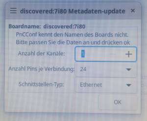

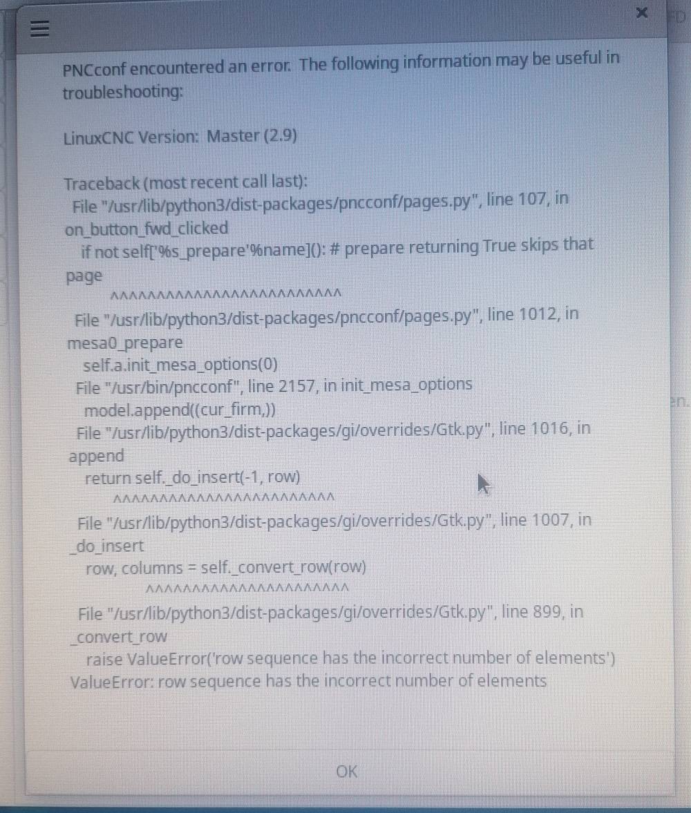

But when wanting to edit the existing config file with pcconf- wizzard I getto a point where I am asked to enter the number of ports
And no matter what I enter there I get this error message:
Is this normal, or did I do something wrong?
Sigi
